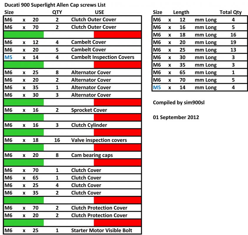

    Dose anyone have a list of the various lengths of Allen bolts for the two outer engine cases, I seem to have lots of bolts left but none the right length, and my brain is still screwed from the horrendous year I've had, just can't seem to work it out.
  2. Any good to you Paul?
    AL

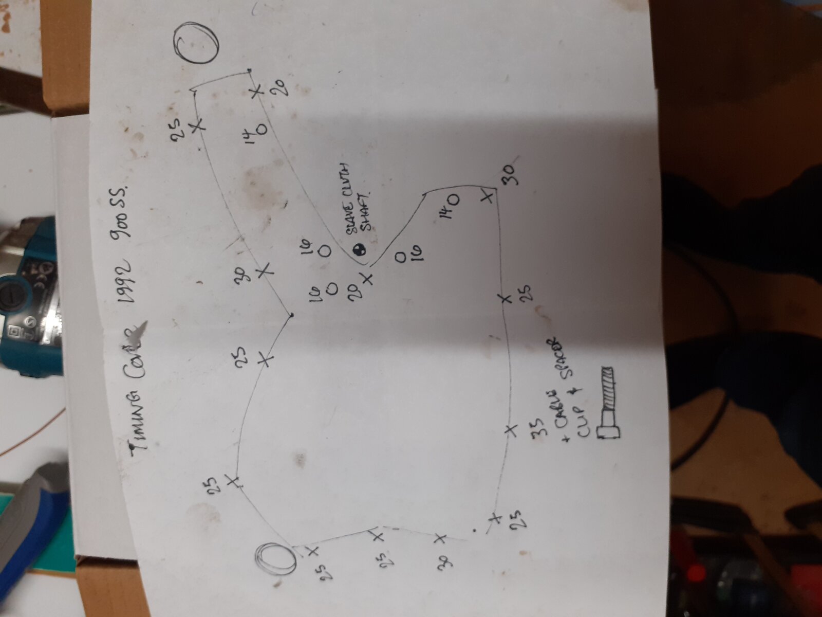

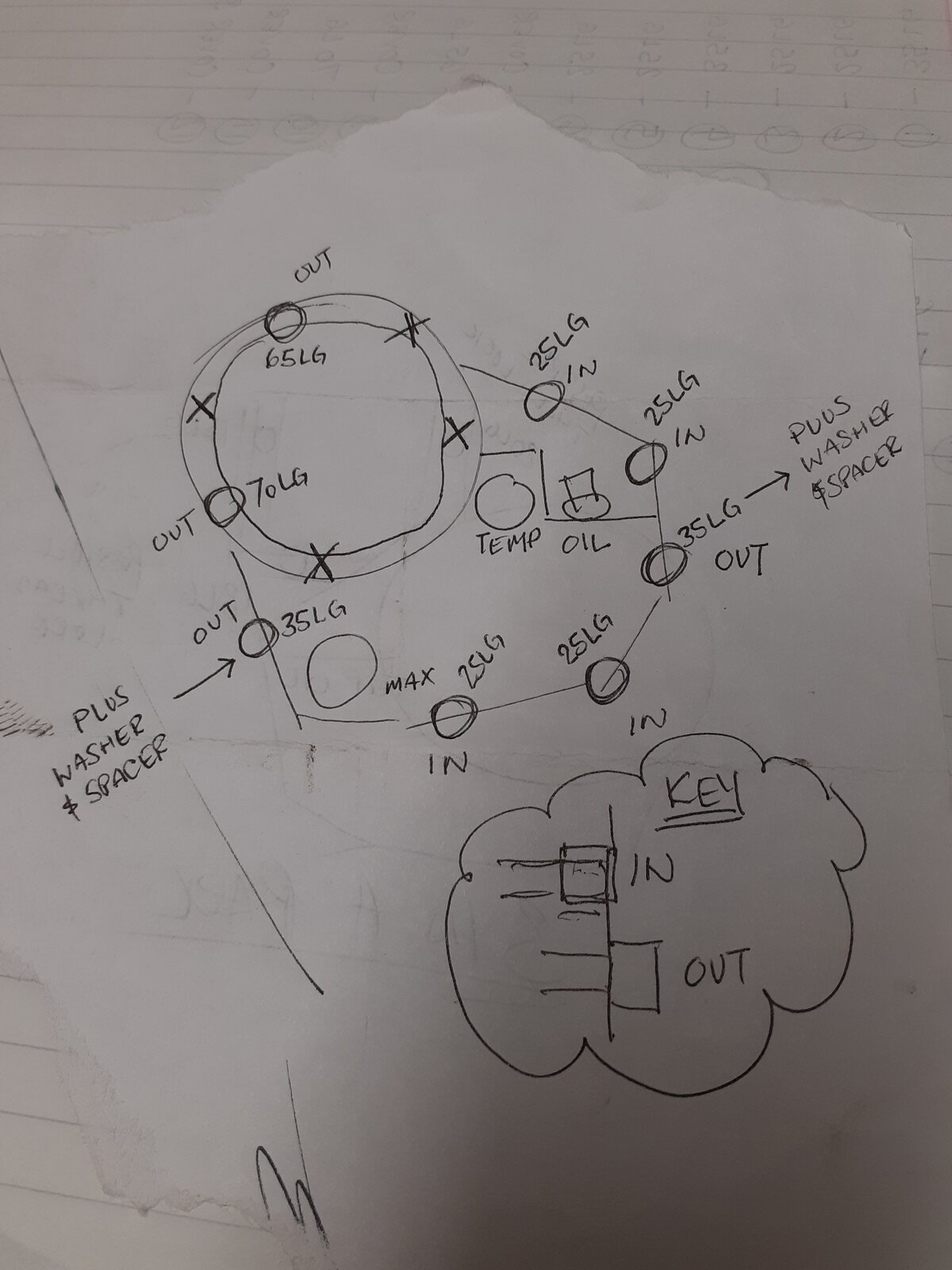

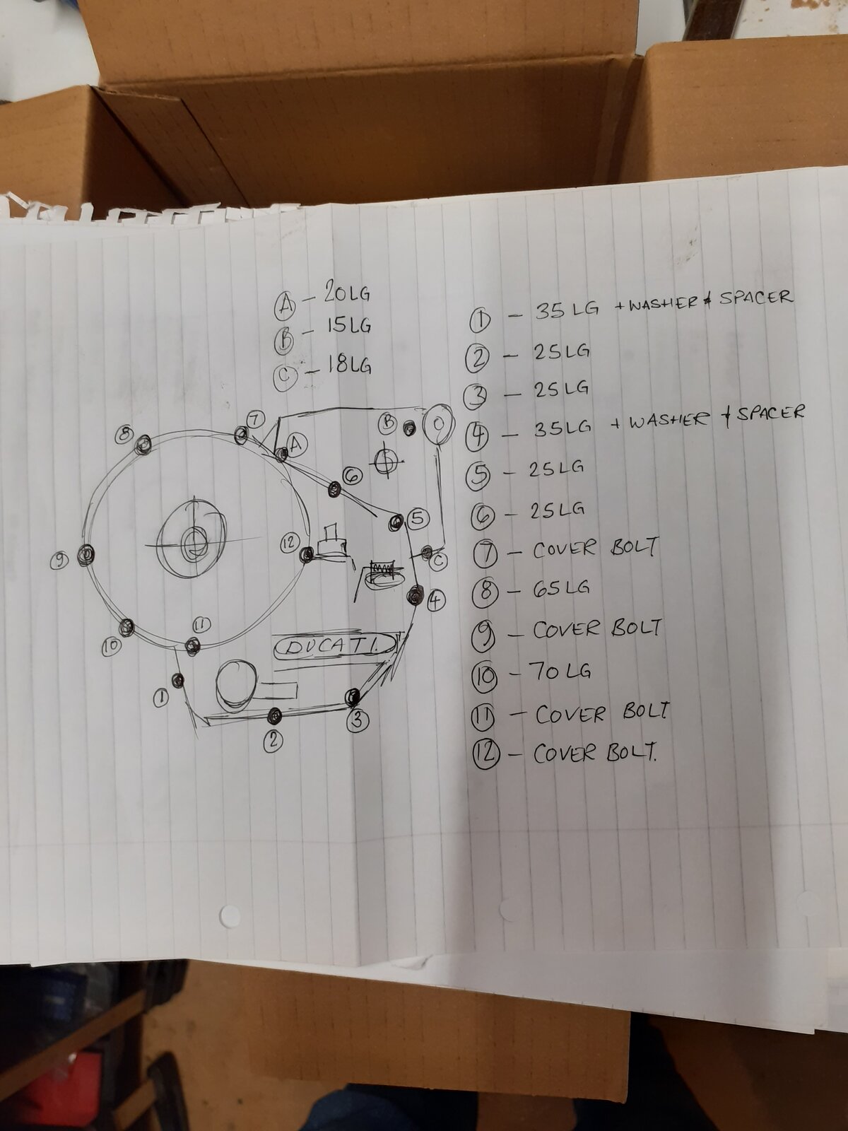

  3. Lumbux
    Hope this ties up with Al's info.
    92 900SS
    Cheers Gaz
    #3 gaz92, Dec 9, 2020
  4. Thanks both, ill get them on order, hoping to get the old girl running by the end of January, ready for house move.
