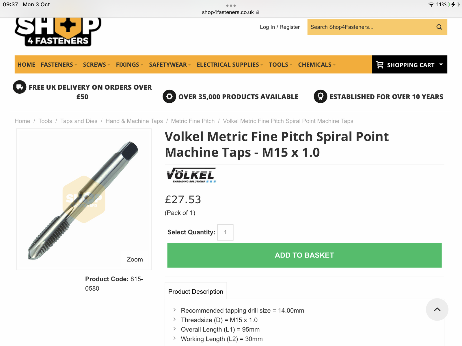

  5. Ducati uses a M15 x 1 sump plug on the secondary oil drain plug, the sump plug is fine but the engine casing doesn’t have threads left on it, I cannot re-use the original sump plug as no one sells a tap that size or a thread repair kit that size and heli-coil do not make an insert that size, there very limited space available to repair this so I’ve found the options that will likely fit and looking for experienced advice on which may be the best option.
