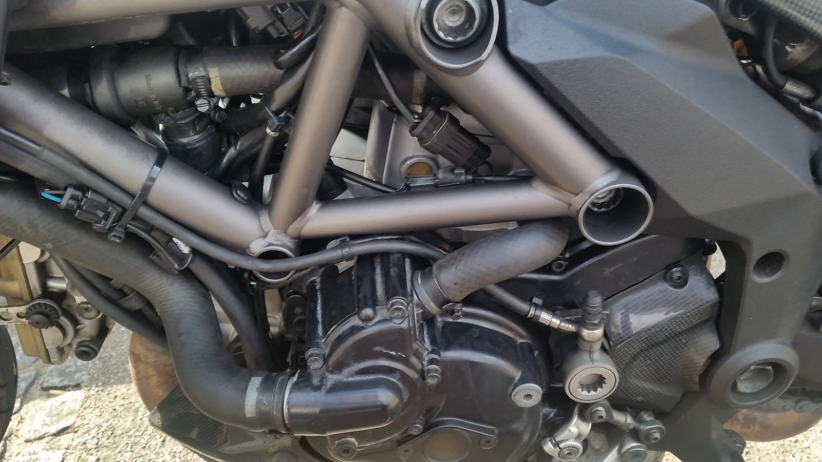

  8. well I have had the bike since 2010, in that time I had the starter switch fail 3-4 times and then the kickstand switch (which I found after replacing the start switch - which needs the tank off but am quite good at it now!).
    so yea, if you are getting "bike dying symptoms during riding - even for a micro second" then my reaction would be to first check and replace these 2.
    to fit it is easy just find connector unplug from sidestand and plug in this unit - see pic. - takes about 10 secs.
