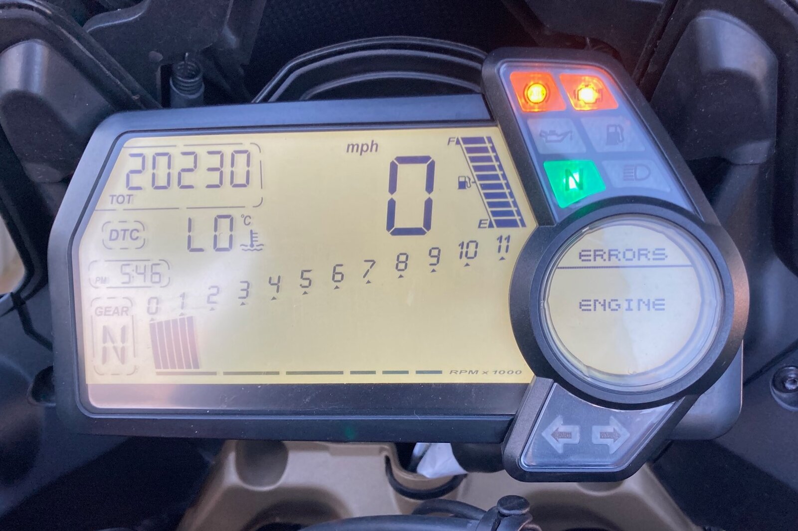

  1. Started the bike yesterday and Errors Engine appears on the display. The bike started ok and seems to run ok but I have not taken her for a spin yet. The Yellow engine management light is on as well as Errors Engine. I also had a key Battery Low message I doubt that its connected.
    One weird thing though, when I pushed the red button down and then back up, the engine started automatically - maybe the start button is a bit sticky? Could this cause the error? I have taken it apart and tweaked the button spring as well as cleaned with contact spray. It still seems a bit 'sticky' but the bike starts now as it should using the button.
    The bike has been in the garage for several months now, with a full tank of petrol with additive. Last time she was started she was fine. I started her again this morning a run her up and down the close and she seems ok.
    Any ideas that I could check before taking to a dealer?
    I also added a this message to a previous post on the same subject where some people have found a MAP sensor issue.

  7. UPDATE - error checked during recent service and the fault was a MAP sensor, which the dealer had in stock and replaced so now all ok.
    Hope this might help someone else.
