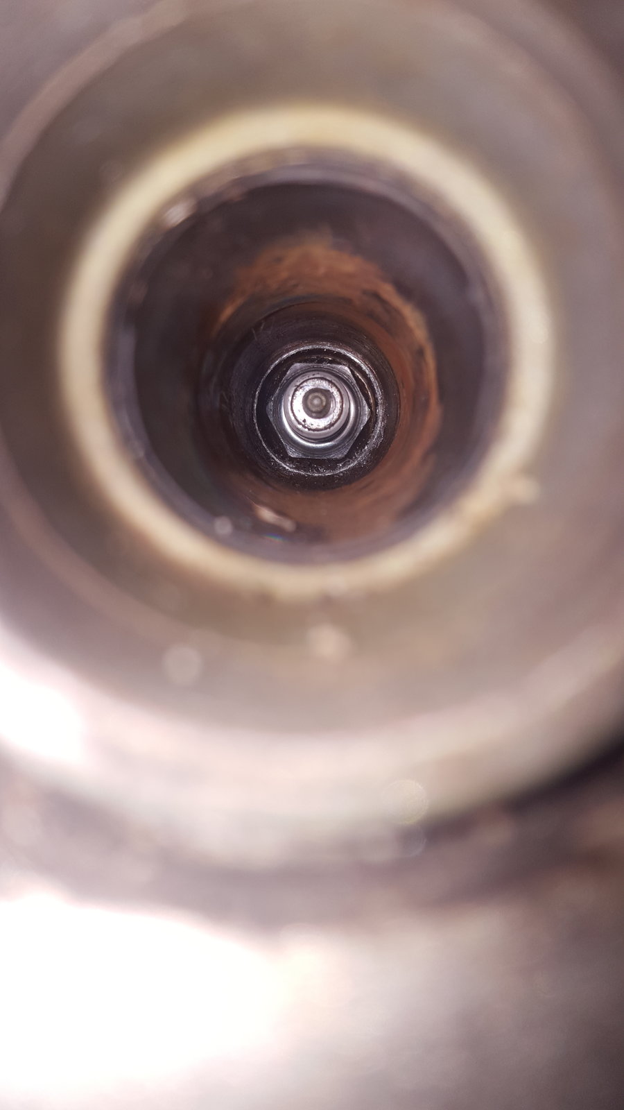

  5. No mositure in there but the plug looks like it needs closer inspection......how thin do i need to machine the socket to fit the plug???

  9. Twas indeed a 16mm, i had an old 16 mm socket and ground it down today...worked a treat, plugs that were in were iradiums cr9eix, anyhoo after a bit of research ive reverted to the cr9eb plugs, i also noticed a fuel line was pinched on the verticals top so i pushed that back into the aperture under the tank, ill take it for a blast and some fresh fuel later. Hope that cures it!

  15. I think is was the horizontal coil...i whipped it all out again and checked the gap on the new plugs, popped tbe black rubber off the coil and the electrode thingy inside was rank, gave it a good clean and after reassembling everything the bike runs beautifully and doesnt stall at all!
