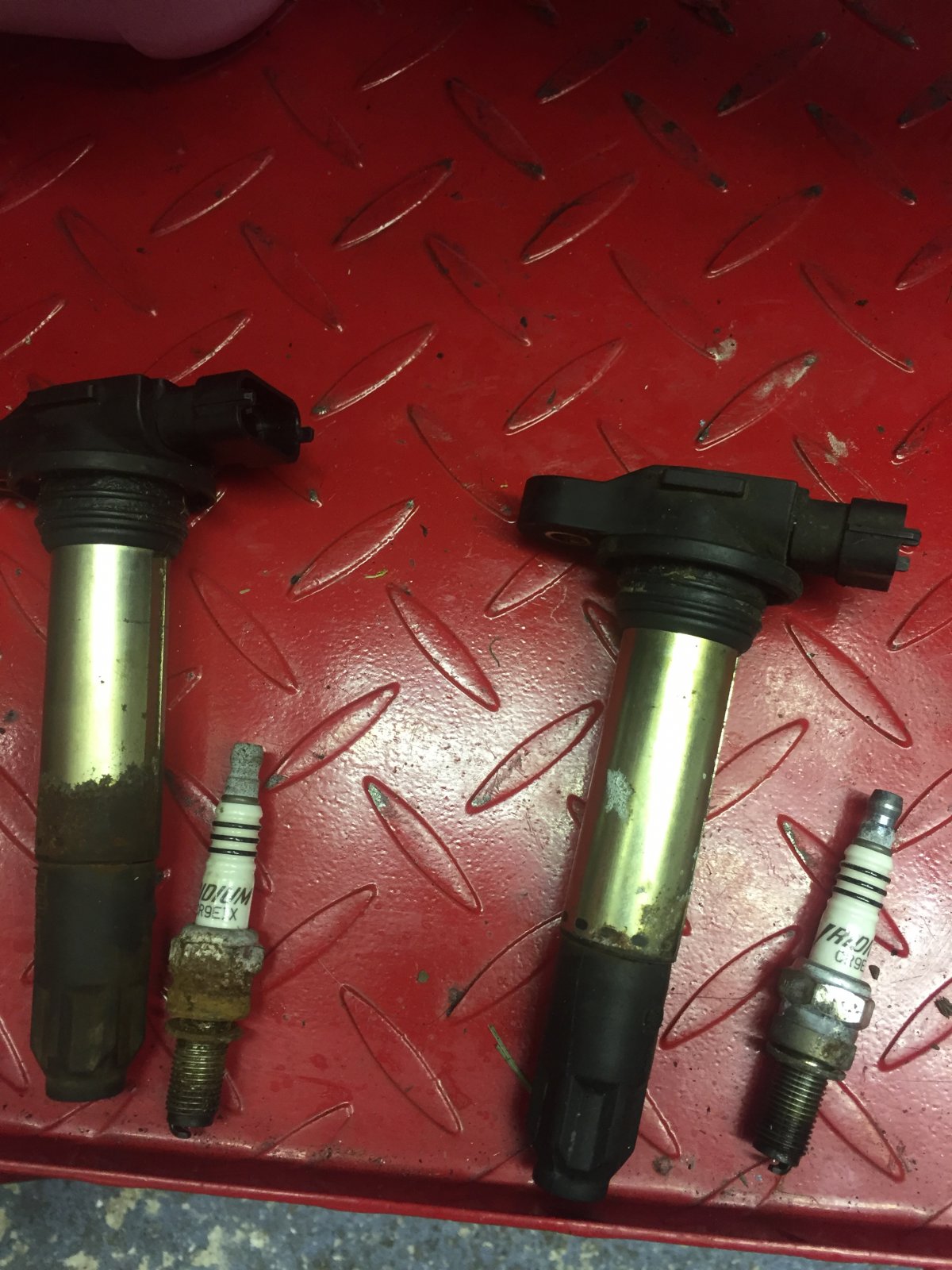

    So after trawling through forums etc it seemed that the most common fault is the front coil due to being exposed to water and debris from the front wheel. I took the coil off to find the coil casing :poop:slightly corroded, the hole and coil was full of condensation which I was suprised as having owned the bike for 6 months it has never been out in the wet.
    So I decided to replace the plug and coil to which I'm awaiting delivery.
    Today as the weather is grim up north again i thought I would just check the top cylinder coil and plug just to be on the safe side and was shocked to find it in worse condition than the other. The plug looks like it's been under the sea...no condensation though.
    So I think another coil will be being ordered...£££
    The coils I've taken off are the original ones from new, I've ordered the updated coils.
    So just thought it might help those who think that it's just the horizontal cylinder that gets corroded.
    Have a look at the picture the plug and coil on the left are from the vertical cylinder.
    I just hope it cures the misfire, I'll keep you posted.......

  5. @RearGunner
    I presume you know that coils can be taken apart. The nose section pulls off, be careful you don't loose the spring that makes connection with spark plug tip though! I found a bit of Scotchbrite very effective for cleaning rust from stick coil body and spark plug.
  6. Thanks John, yes I've removed the rubber from the coil and have cleaned up the contacts to be honest the contacts looked in good condition it's just the outside of the coils that look grubby and corroded.
    I have only ordered one coil to which I will fit to the horizontal cylinder and hope it cures the misfire.
  7. Mine looked like yours. gave them a good scuffing and have been fine.

  9. It's the first time I've looked at the plugs since having the bike, the top one wasn't in all the way I suspect whoever put them in didn't have the correct socket, there's a fair chance that could be the cause of the misfire...

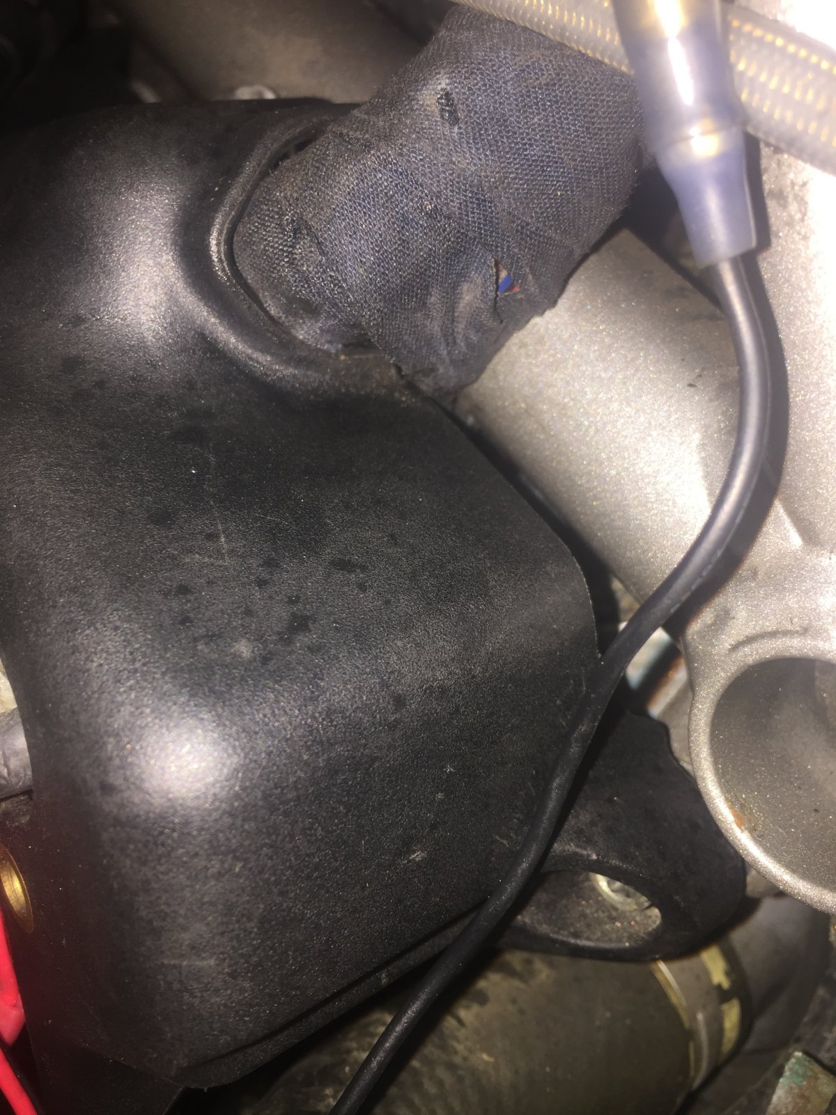

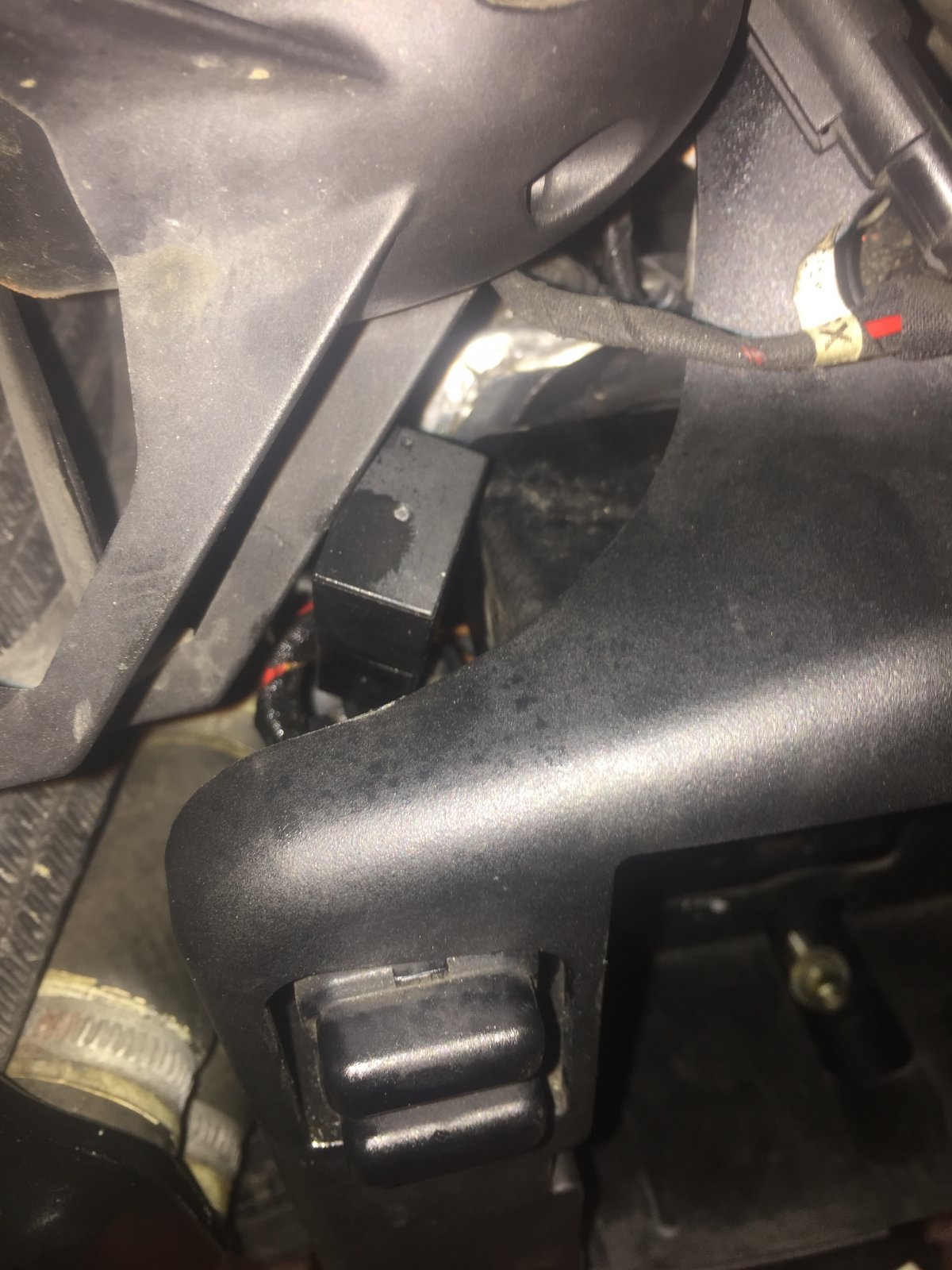

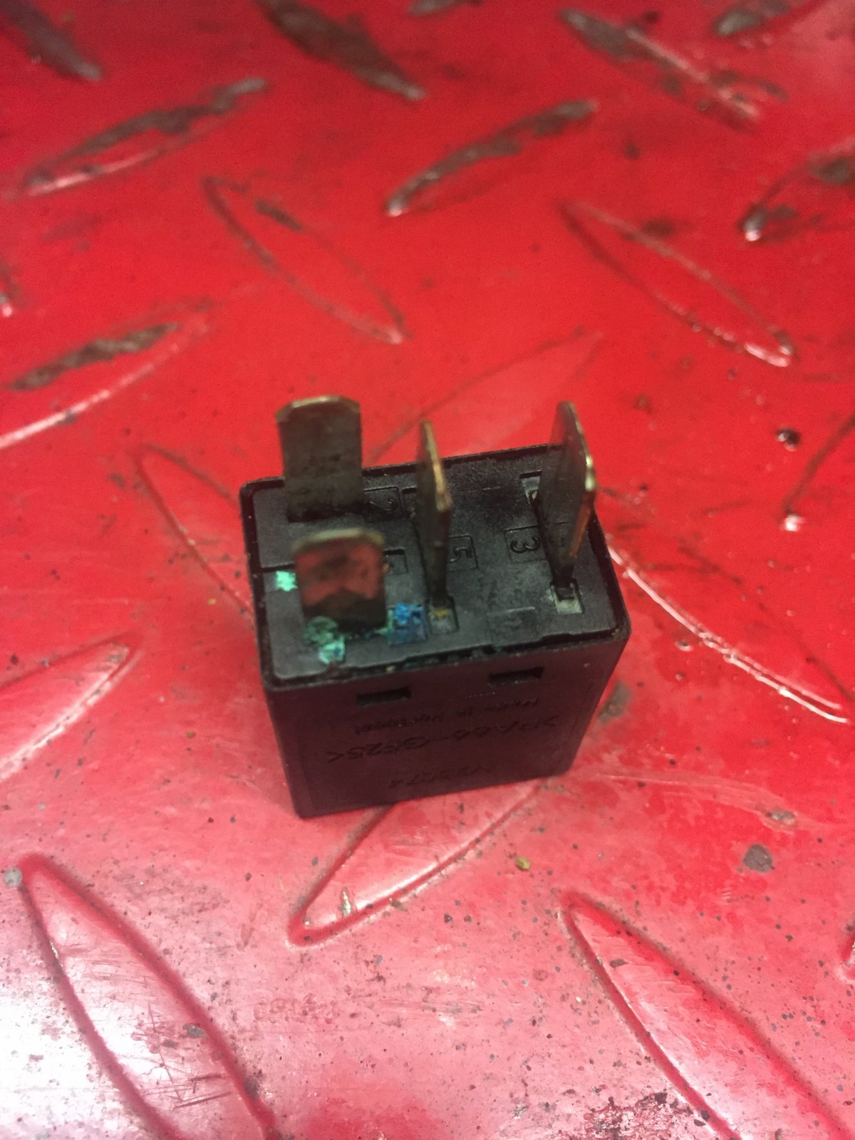

  14. Ok time for an update, I'm still waiting for my spark plugs to arrive so the progress on the misfire has ground to a halt for the time being so as a new relay arrived today I decided to move the fuel pump relay.
    I removed the battery box and took off the old relay which was in ok condition but not great. I've put the relay up near the rubber square on the left of the battery box but there doesn't seem enough spare loom to put the loom in the rubber square (which would be ideal).
    I cleaned the heatsheild a squirt of acf50 then secured the battery box back on the bike.
    It seems very tight on the loom at the top right hand side????
    Is this normal??? The cut out in the box doesn't seem big enough to accommodate the loom????
    Any advice would be welcomed
    See pics Thank you.....
  15. put the finger of a rubber glove over the relay too and tape it up tight. Stops water ingress.
  16. Thanks Penfold, I will do that
