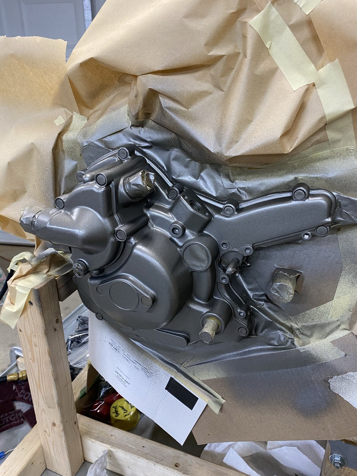

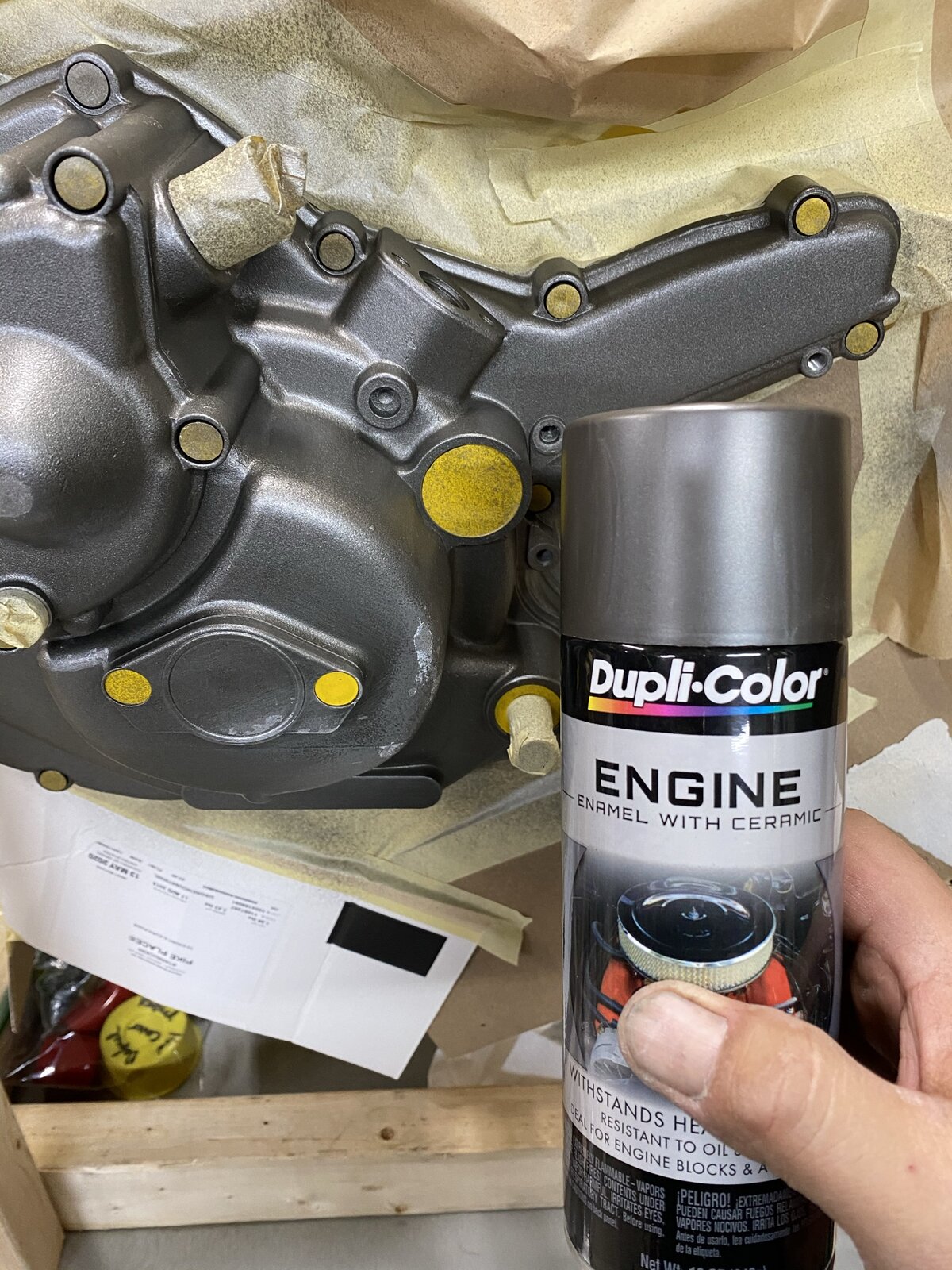

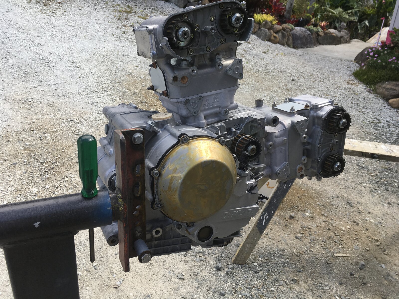

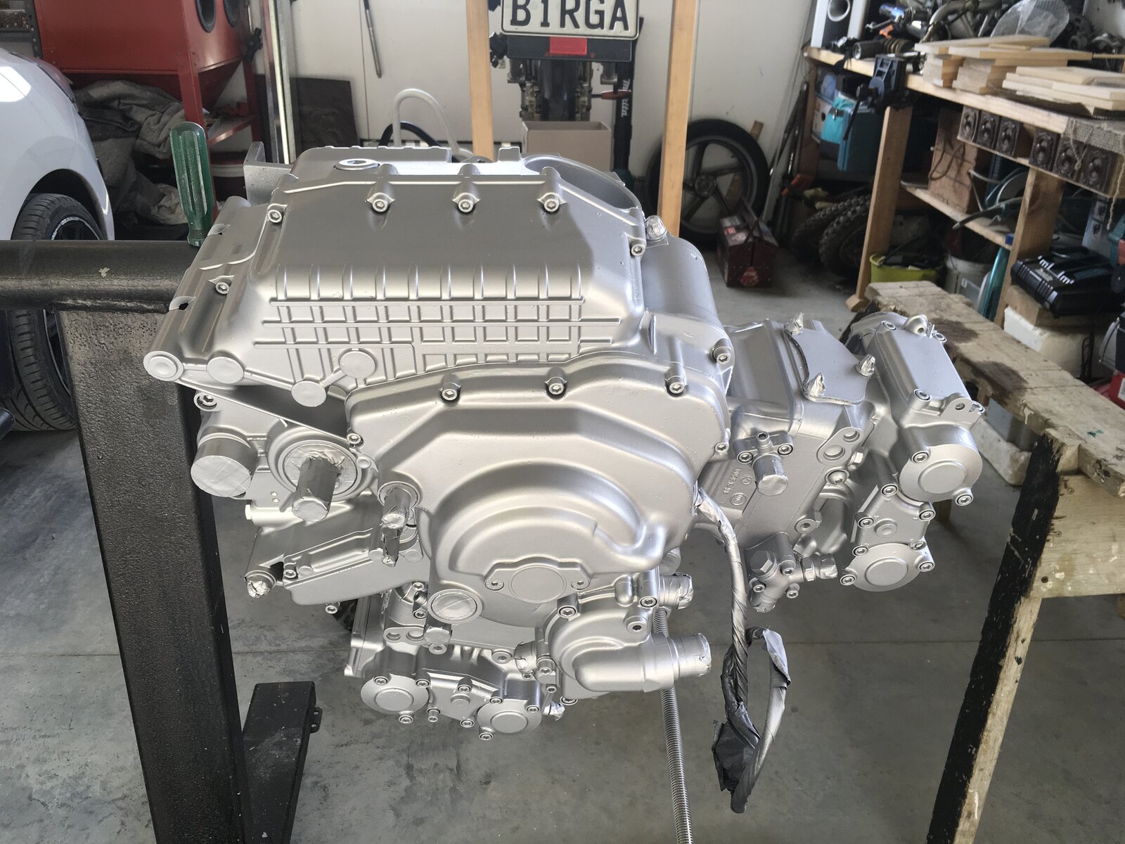

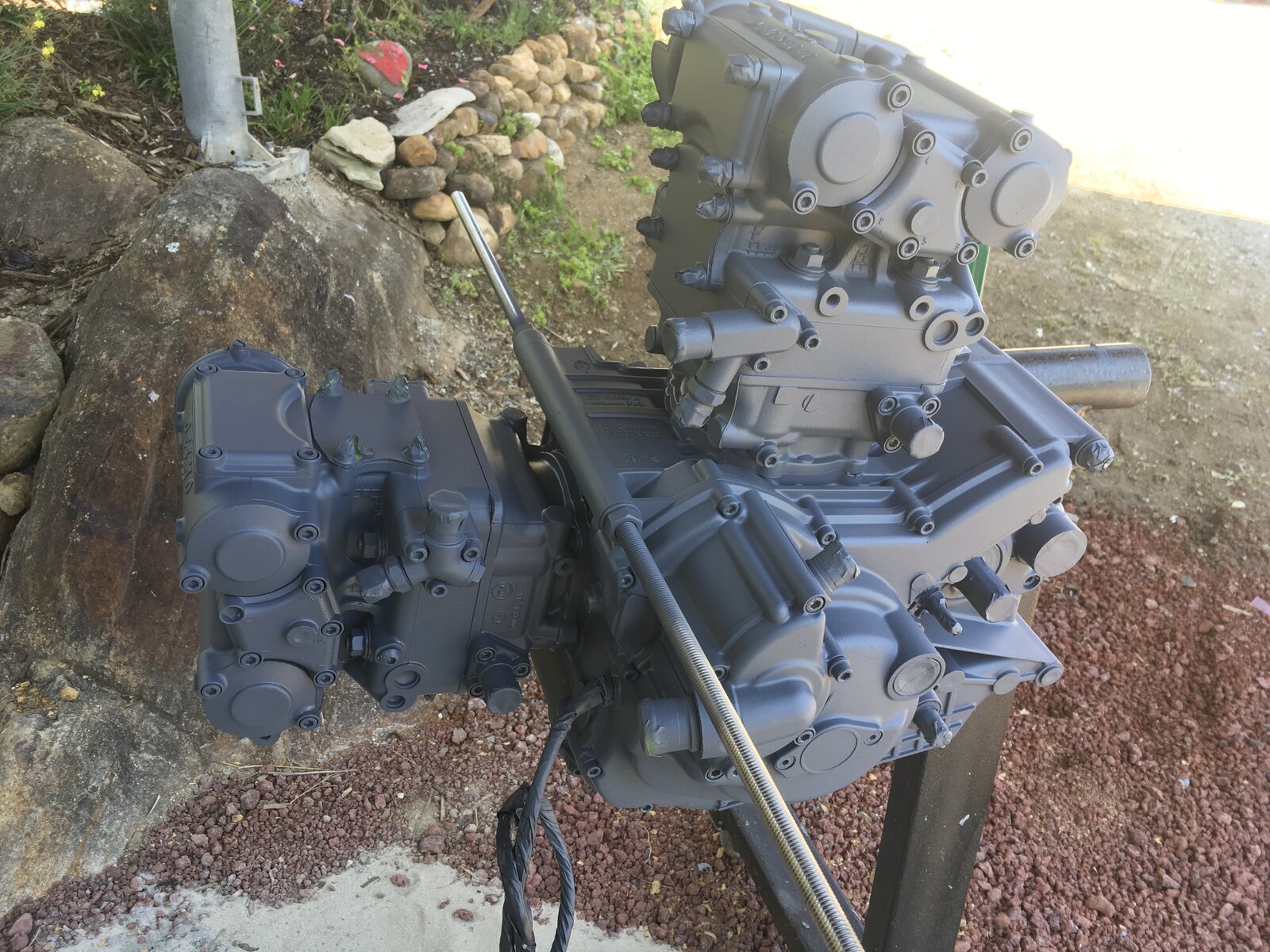

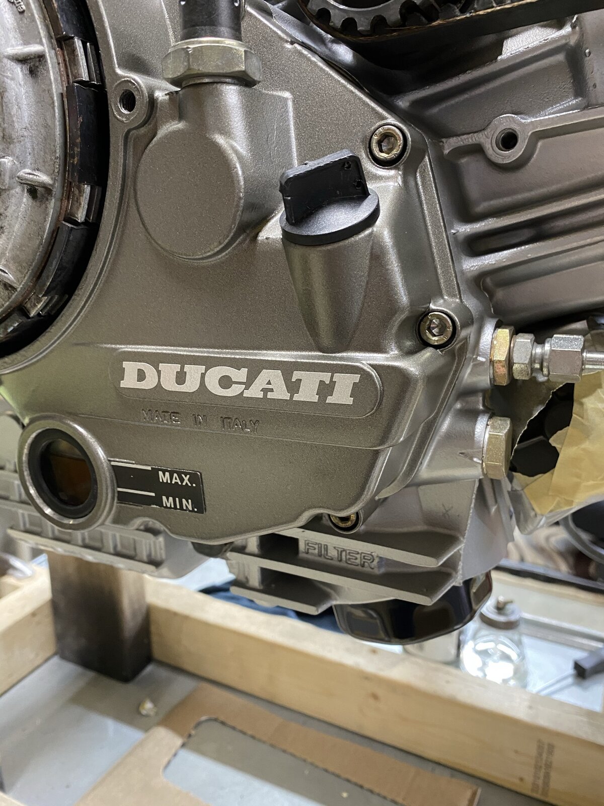

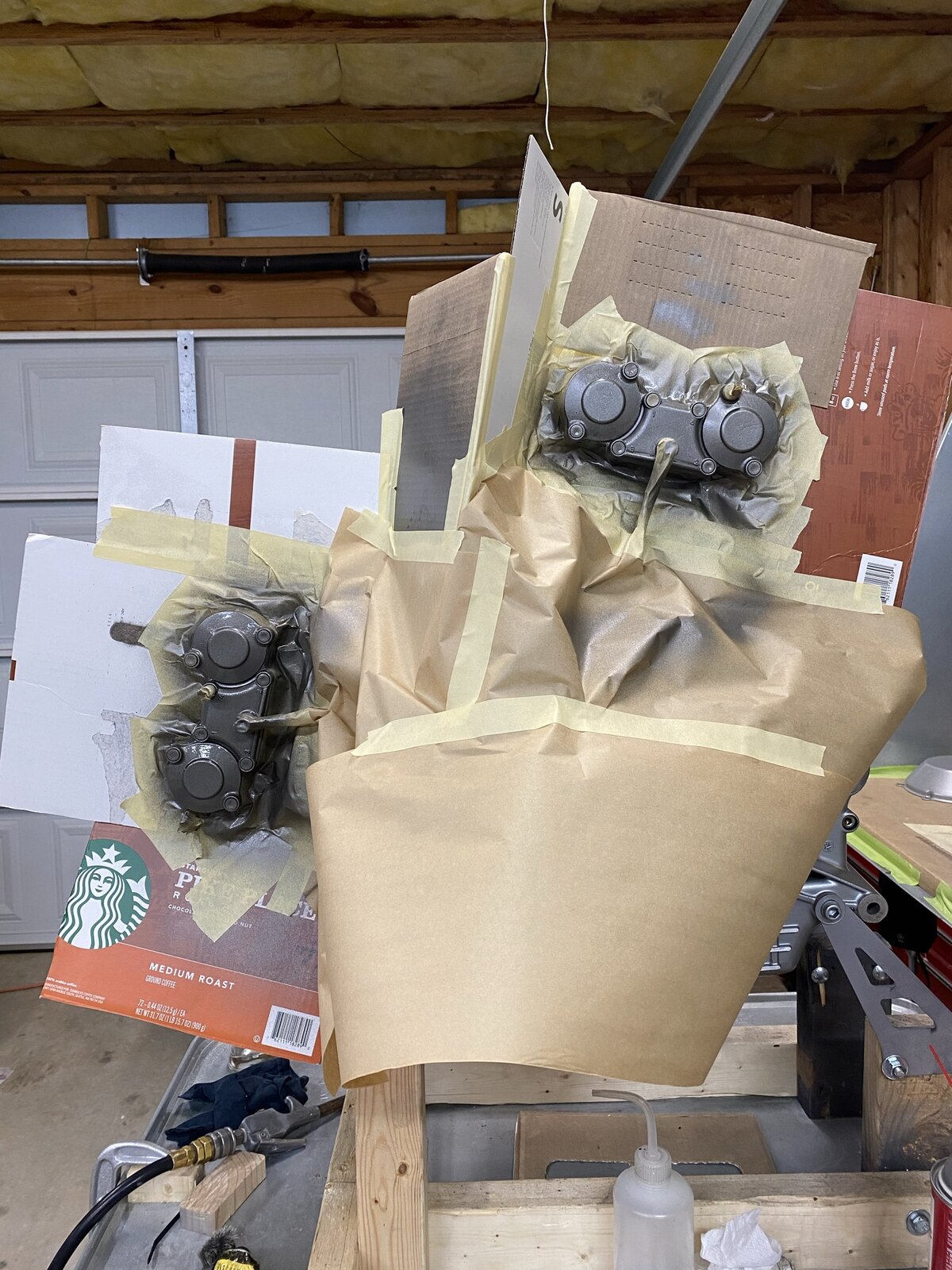

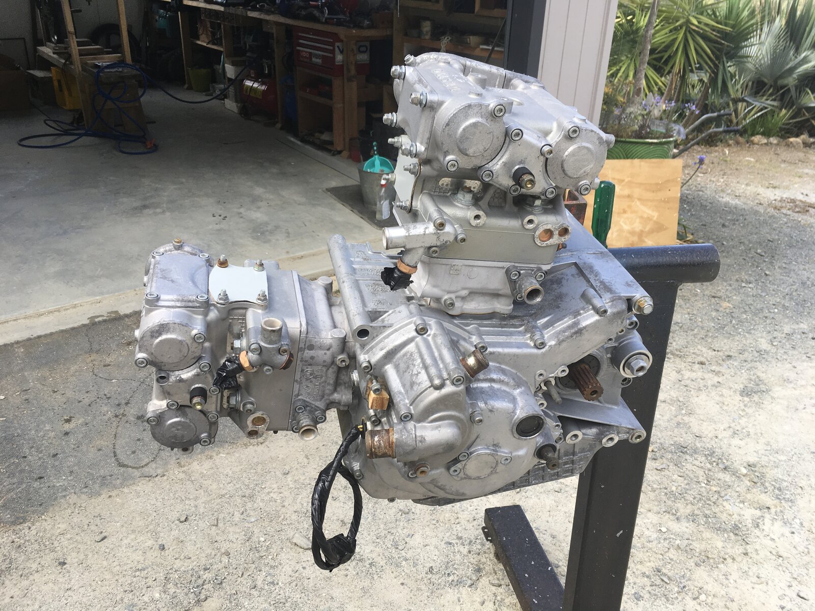

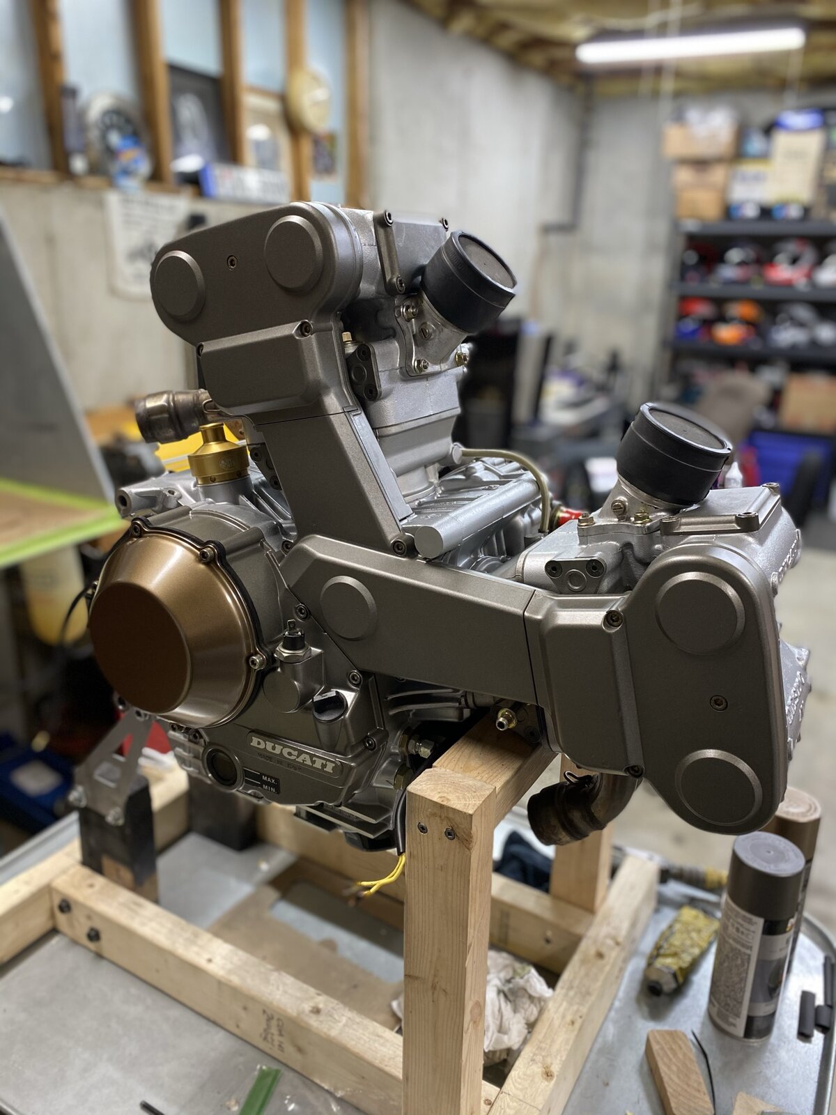

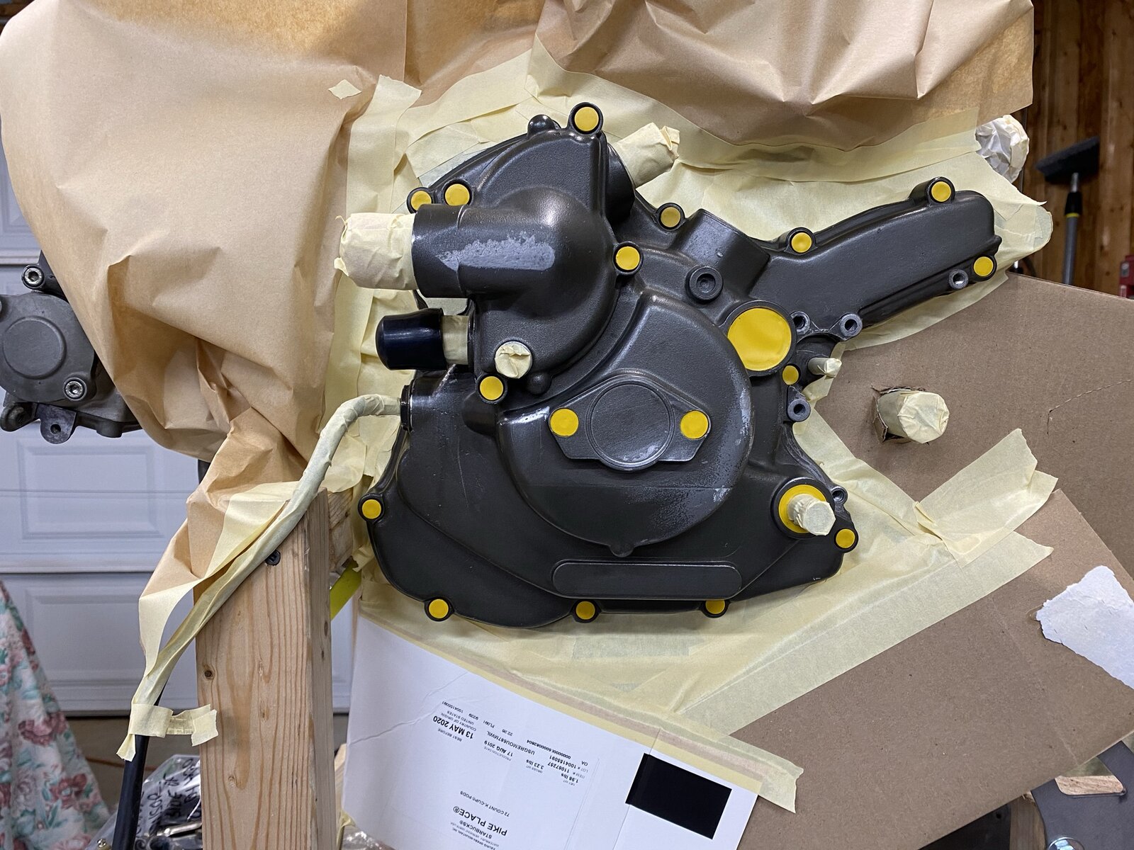

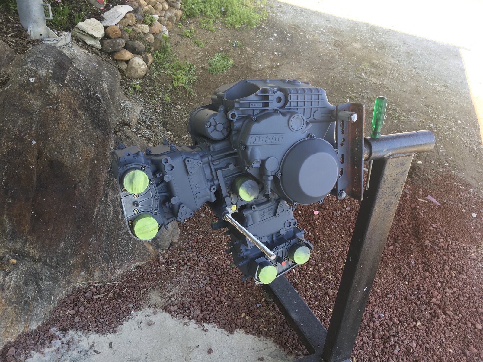

  5. I painted my s4r motor quite successfully using hammerite spray can flat silver. It came out so close to the original it would be hard to tell. I pulled the motor, made some blanking plates for the exhausts and inlets and crankcase breather. I bolted the motor to an engine stand and set about stripping the paint with paint stripper. It came off pretty easy as it was put on badly in the factory. Some very careful masking up and some paint prep solution and I was ready. I put the motor in confinement with a heater and got it almost too hot to hold your hand on. I painted it outside and the hot motor meant the paint tacked off very quickly.I did grey etch primer one day then finish coat the next. 8F82A59C-B15B-44E0-BF12-345A23795363.jpeg 416D95D3-7E7B-4965-A97B-86346E13BAD3.jpeg A1C45946-5A99-4319-871F-1C7B09010881.jpeg 03E1ED65-23DF-4361-B7EA-F27AB3223BBD.jpeg D260329C-5DF8-4BD2-864B-219FD4454155.jpeg If you concentrate on being careful with the nooks and crannies, the open areas take care of themselves pretty much. It has been nearly a year, some drag racing and 10,000km and still good as new.
    My advice is do not strip the motor if you dont have to.

  6. It will go without saying for the vast majority, but to save that one person the tears, and for the avoidance of doubt, before anyone buys the wrong flavour of Hammerite, there are two flavours, one with a 'Hammered' finish, one 'Smooth' - from the evidence presented, @laava has used the 'Smooth' variety.

  7. how long ago laava, and how is your paint standing up to the elements?
  8. 14th Dec, so 11 months approx and it is in good nick. Washes up well and seems very durable. Has had a few hot cycles sitting in traffic and has done about 12 runs down the 1/4 mile. Have done about 10,000 km since paint. I used Hammerite, and yes, smooth, on a recommendation from one of the threads on this site.
