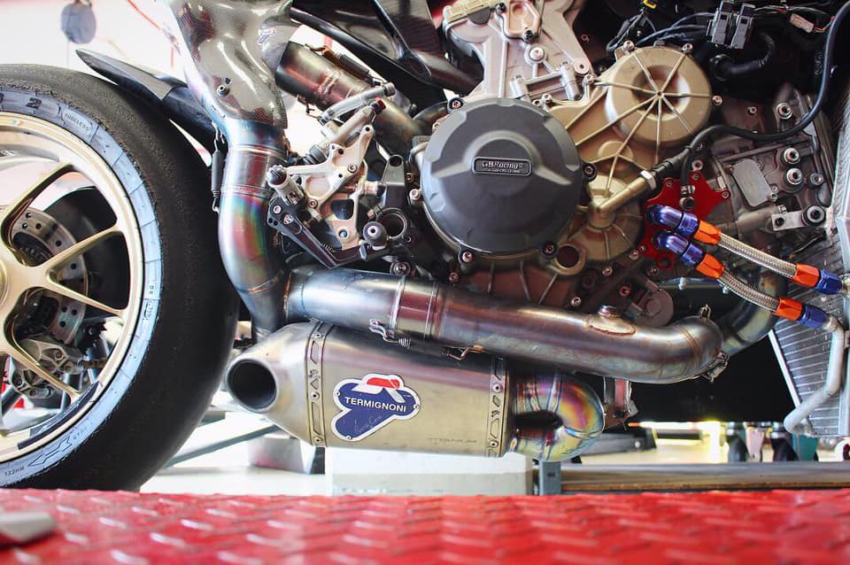

  1. I wanted to inquire if anyone had put a 2015-2017 (PaniR or 1299) engine in a 2012-2014 bike (1199 or 1199R) with the original 1199 ECU and wiring harness. Any problems or things to be aware of? Of course the bike would need a remap, but otherwise have there been any show stoppers?
    Looking at the engines and associated sensors, all the plugs seem to be the same and the only sensor that is noticeably different seems to be the gear sensor which on the 2015+ is a magnetic type on the left side of the engine casing, while the 2012-2014 have a mechanical type sensor inserted into the block on the right side. Both the wiring diagrams for the 2015+ bikes and the 2012-2014 for the gears sensor have them as a 3-wire setup with +5v supply, sensor signal and signal ground, so on a first glance I would expect them to work.
    Thank you in advance for any experiences you can share :)

  5. To provide an update and for future reference for others, it works fine with the 1199 ECU/Harness with the gear training done with the DDA at the dealers. Being that the gear sensor is on the opposite side of the engine an extension cord had to be made to connect the wiring properly. :)
