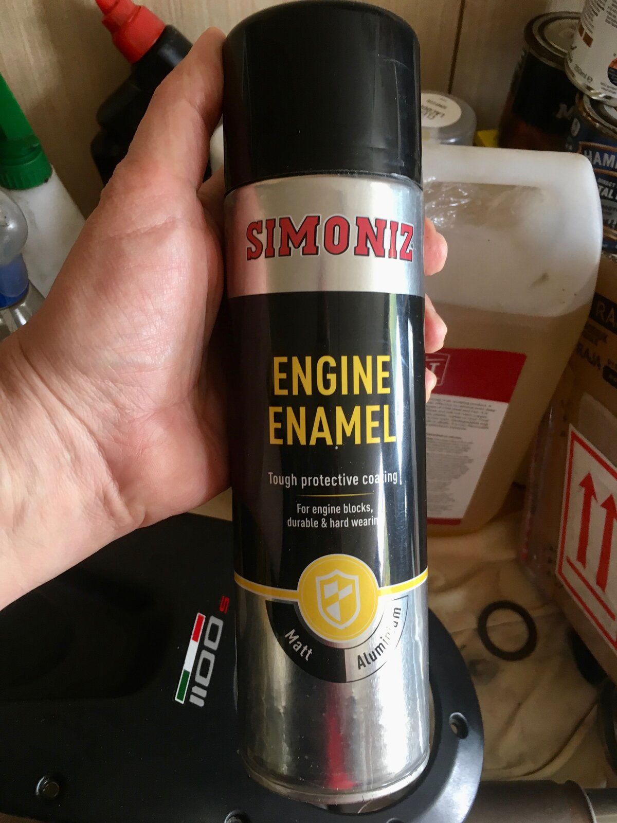

    As for the engine crank cases I used Simoniz Engine Enamel. On the 748 it was the rear of the engine and underneath the crankcase covers that were flaking. I actually did it with the engine in the frame (albeit everything else had been removed) with some judicious masking. It's a very good match colour and finish wise.

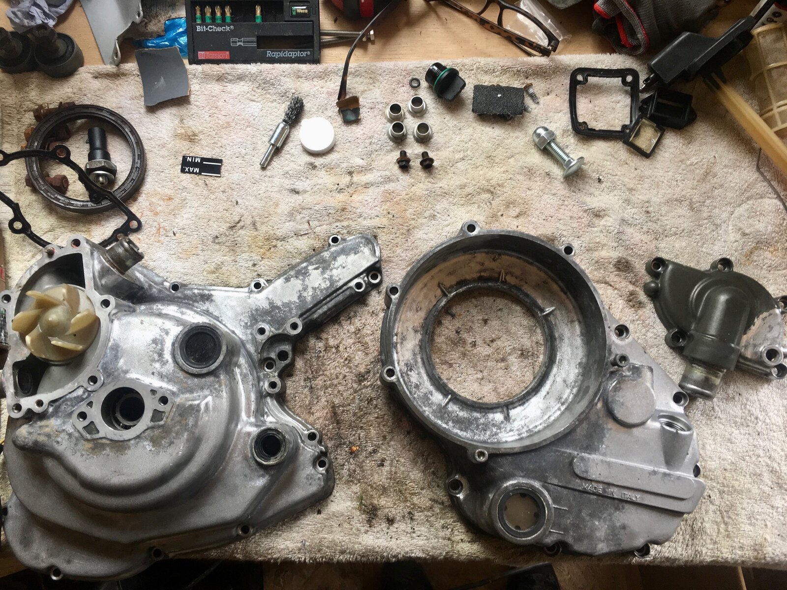

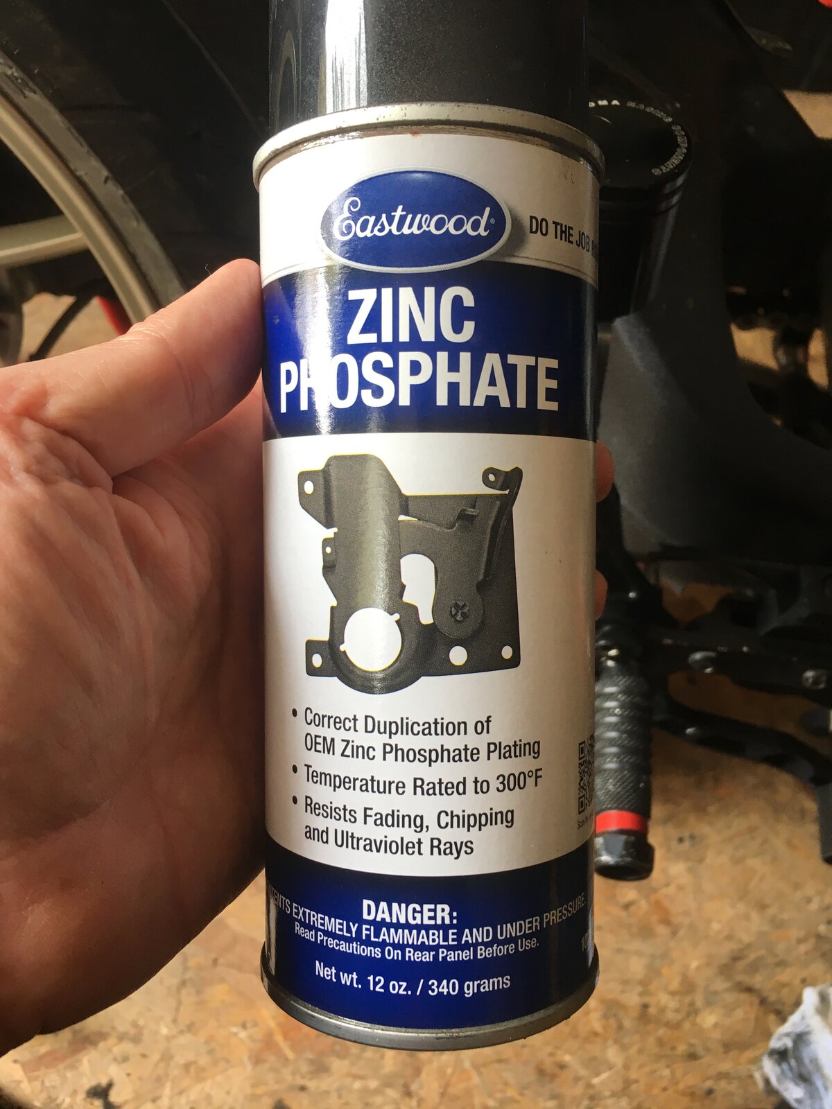

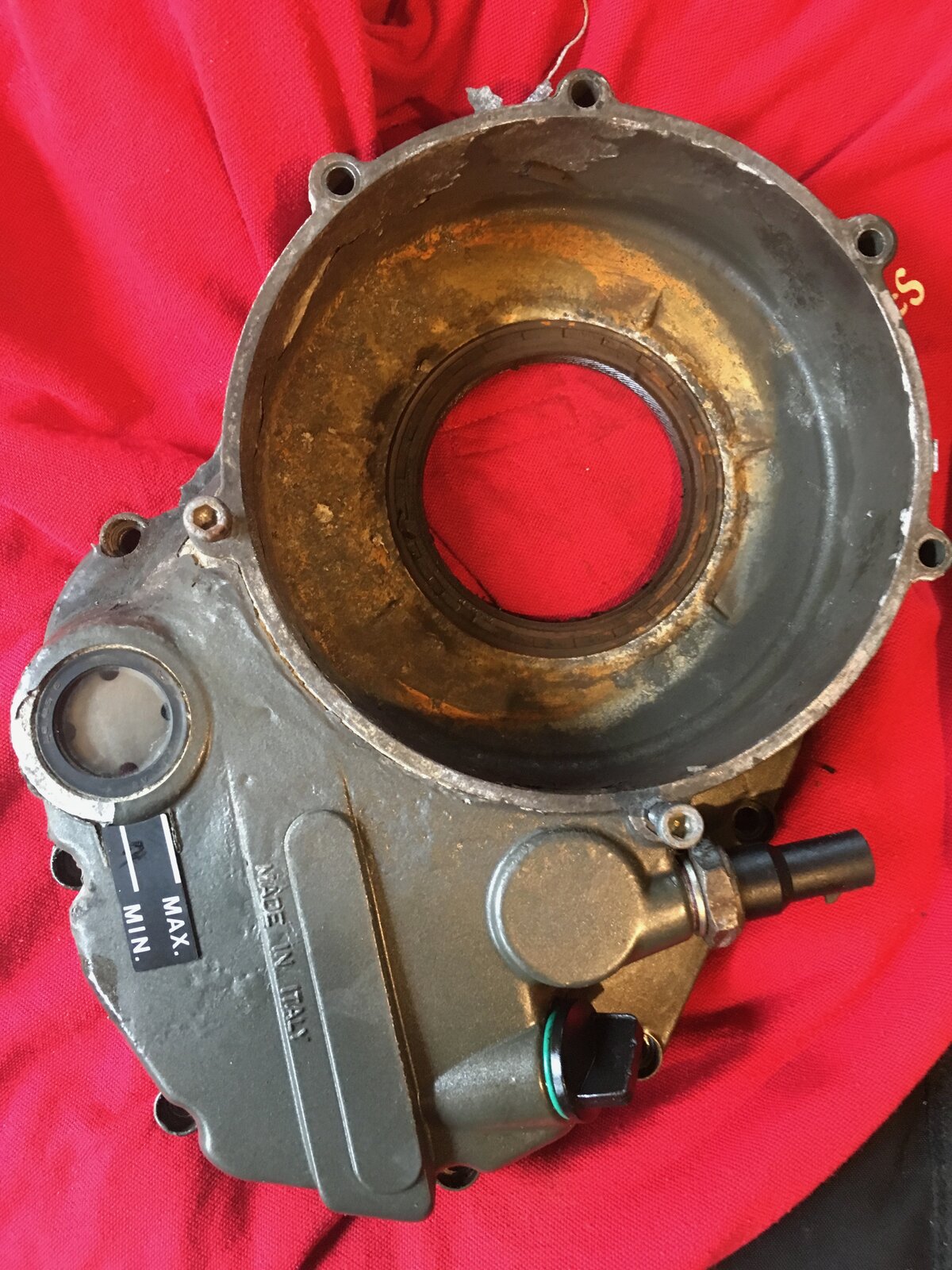

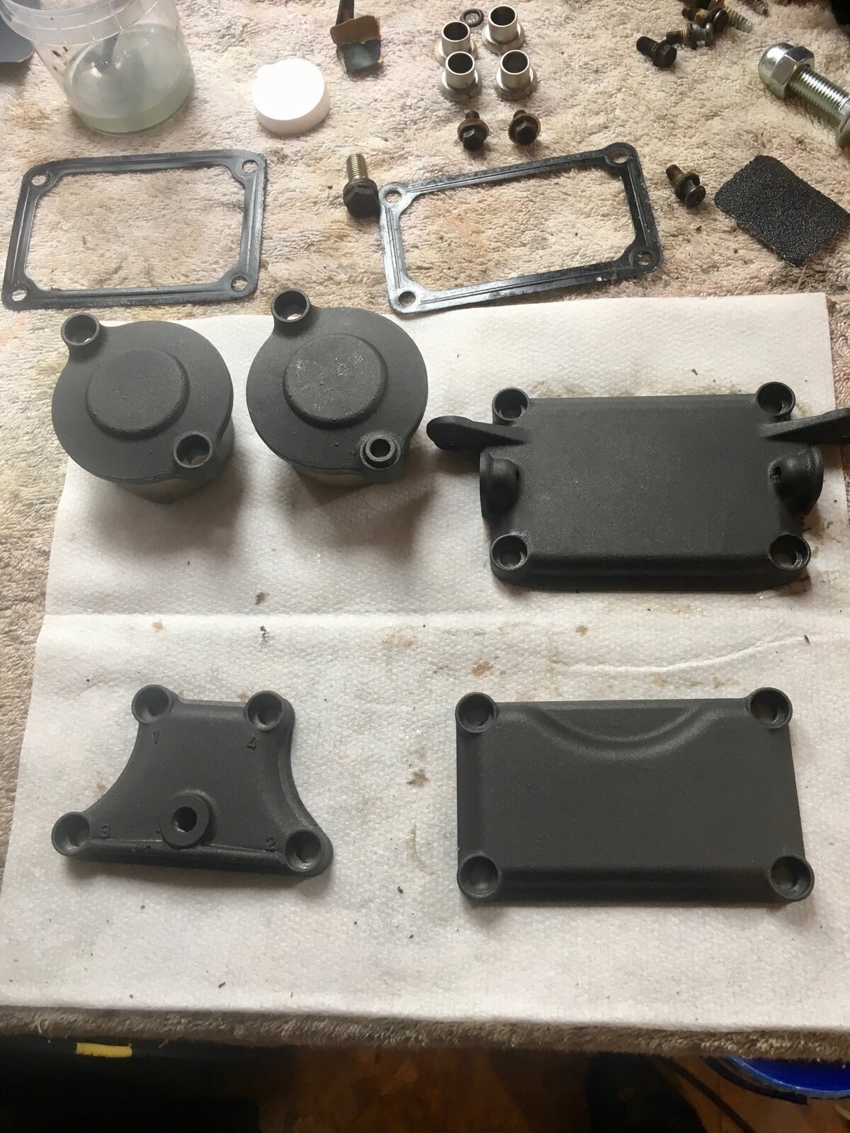

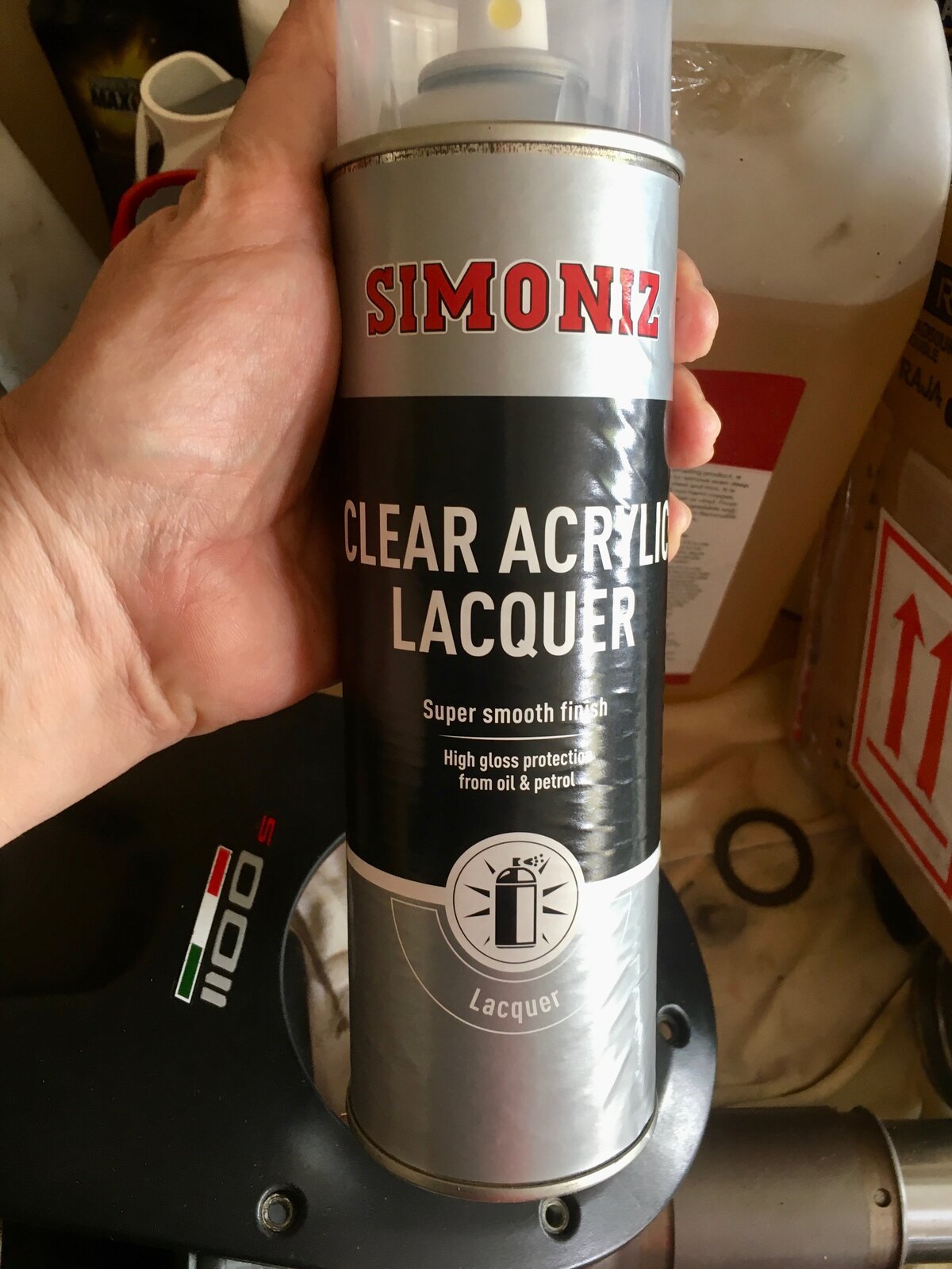

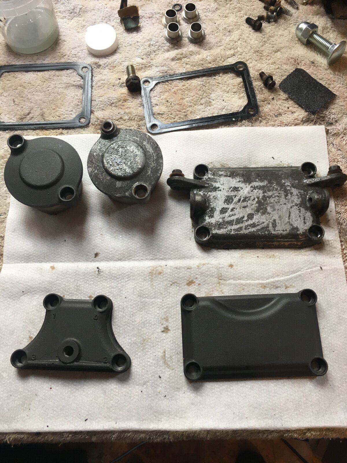

    The crankcase covers are different colours on different year bikes I believe but for mine I removed them, stripped the old paint off with POR Paint Remover, rubbed them down, then sprayed them with Zinc Phosphate and Simoniz lacquer (to make the paint petrol/oil proof) For mine it was a perfect match.
    Having searched, I didn't take before and after photos of the crankcases (maybe I did but I've 15,000+ photos to go through:confused:) but I did take photos of the crankcase covers. I also did all the rocker and cam covers as well.

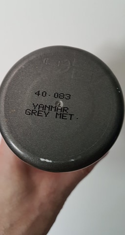

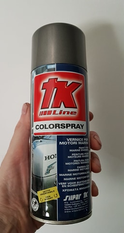

  4. I used this marine engine paint, almost perfect colour match.:upyeah:
    100479072_280507079746014_4138820332570017792_n.jpg 101387791_321527298837143_1407707155108200448_n.jpg
    You can get on Ebay, i just looked, i found it by accident about 2 years ago.

    not sure if we are at cross lines on the engine paint, the black finish on yours looks excellent but its the silver section to the rear and the front of the engine that I need to patch up not the black crank or clutch side - so is that still the Simoniz engine enamel but in the matt aluminium that I'm looking for - like this one:
  6. Thanks Jack - I'll google them
  7. Thats the one I used on the crankcases, yep
