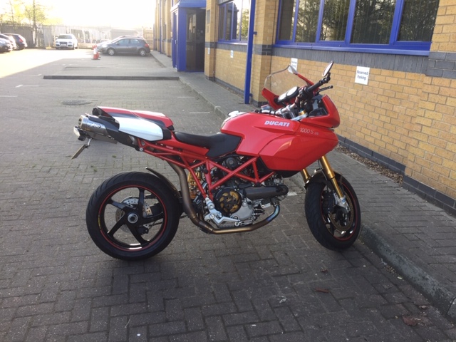

  1. The dreaded orange light came on during a ride the other week and has stayed on. The bike starts and runs just fine but I need to investigate. The error code links to 'injector 1 short-circuit to ground'. Anybody know where this is located and a possible solution to clear?

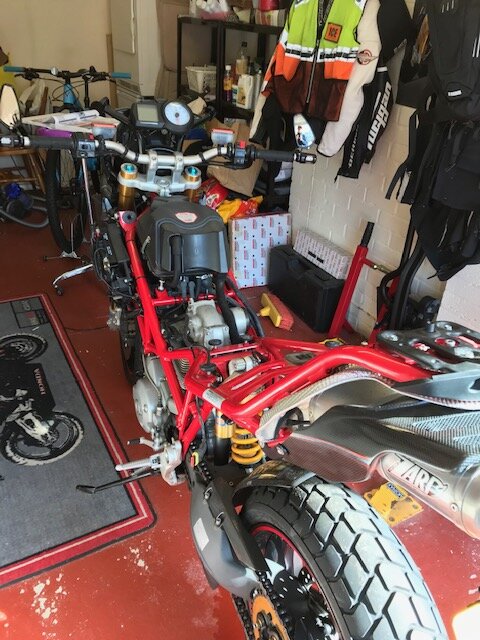

    So to proceed further I stripped off all the bodywork and removed the tank, a most interesting experienced for anybody who has not worked on an early Multistrada! From there I used a meter to buzz out the injectors and coils, which all seemed ok. I then used an old trick to check the injectors. Basically you place a screw driver on each injector and listen on the other end. On turning over the engine the vertical injector is not clicking as per the front. I also cleaned and reconnected the items back into the loom which has removed the 11.2 error. First win

  9. So over the last two weekends I’ve completed the following:
    Day 1
    1. Checked I was getting a good spark from both set of plugs (OK).
    2. Removed all the bodywork and tank.
    3. Replaced the vertical coil & injector (new parts).
    4. Removed the horizontal injector and cleaned.
    5. Removed & cleaned all the connectors I could identify.
    6. Re-assembled (refitting the tank was a competed bastard, I’m sure it had changed shape!)
    7. Put in fresh fuel.
    Once re-assembled I turned the key and the bike initialised and the EML went out. I checked (holding button A) and no errors were being recorded. On attempting to start it took a few goes but then caught and fired up. Happy days or so I thought! But the same pattern followed. After about 5 minutes the engine management light came on and the bike died and would not start again. This time just the 11.2 error code returned 13.2 had gone.
    Day 2
    1. Replaced the engine senor and shim (both new parts) & set a gap of 0.7mm (as specified in the manual).
    2. Checked earth OK.
    3. Changed the ECU (I have a spare).
    4. Changed the injector / fuel pump relay (new item,again).
    5. Deleted the old stored error codes via ScanM5X diagnostic software.
    note: I tried to start the bike after each step, without success.
    Current status - when turning the key to the on position the bike initializes without any errors and EML goes out. If I listen carefully I can hear a couple of clicks (relays engaging, I guess). On hitting the stat button the engine turns over fine but wont fire up or seems likely to do so. when I turn the key to the off position I hear some whirring noise for a few seconds.
    Final step was to again remove the plugs and check for a good spark Ok, noting that the plugs were wet. It seems I have compression, fuel and a good spark, so I'm stumped at this point. Any suggestions where next to look would be much appreciated.
