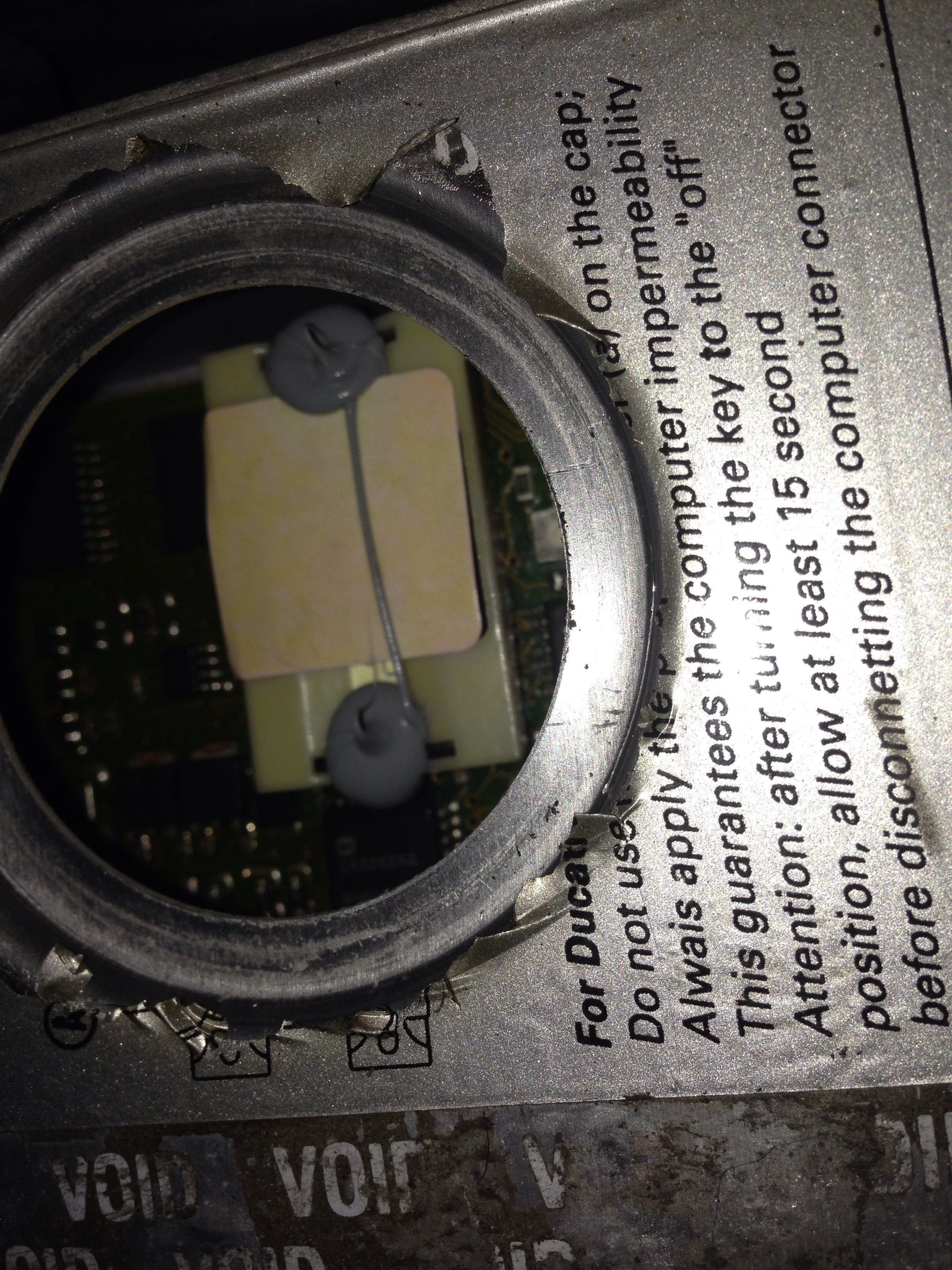

  1. As stated before, I have a 996 bip with 50mm micron end cans( I didn't buy them) and have just bought a DUCATI 996 EPROM O 50 open exhaust chip 965031AAA. Any views on its compatibility. Just thought it might clean up the 4000 fuel glitch and give me a few more ponies? Thoughts? Also, does it just pull out from the rubber circle on top of ecu under seat??
  2. Installed ecu
  3. Does the one fitted look like an original??
  4. So the part number you have is the DP EPROM for the full 50mm system. I'm not sure from your post if you just have 50mm end cans or the 45/50mm half system or the full 50mm system. The picture of your installation looks nothing like my 748R though. Chances are that you will be over fuelling which is better than running lean but unlikely to see big performance gains. I have had difficulty getting someone to write a unique map to an EPROM although CJS advertise that they do. PC III may be the way to go depending on what return in performance you are looking for for your buck. Andy
