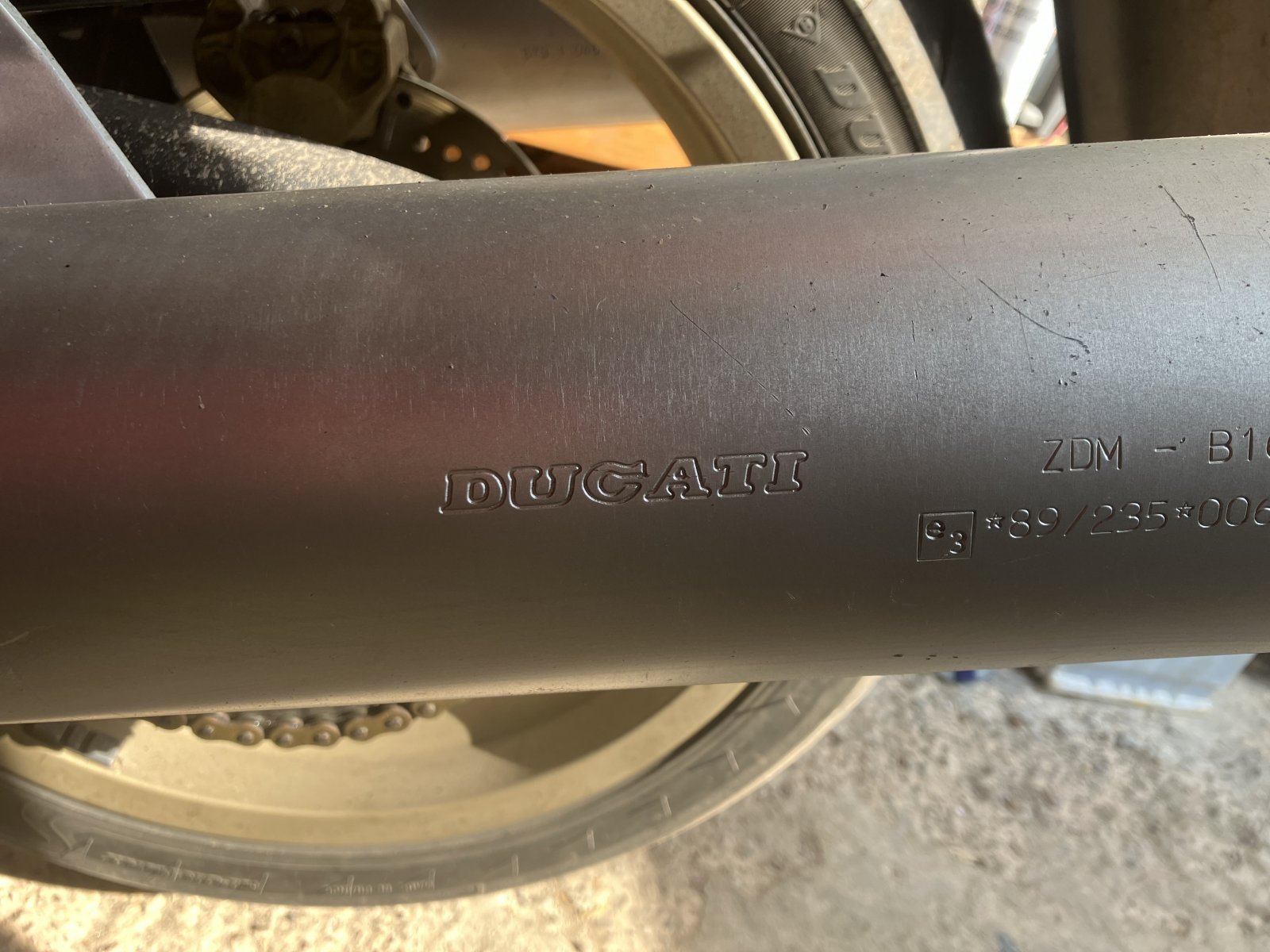

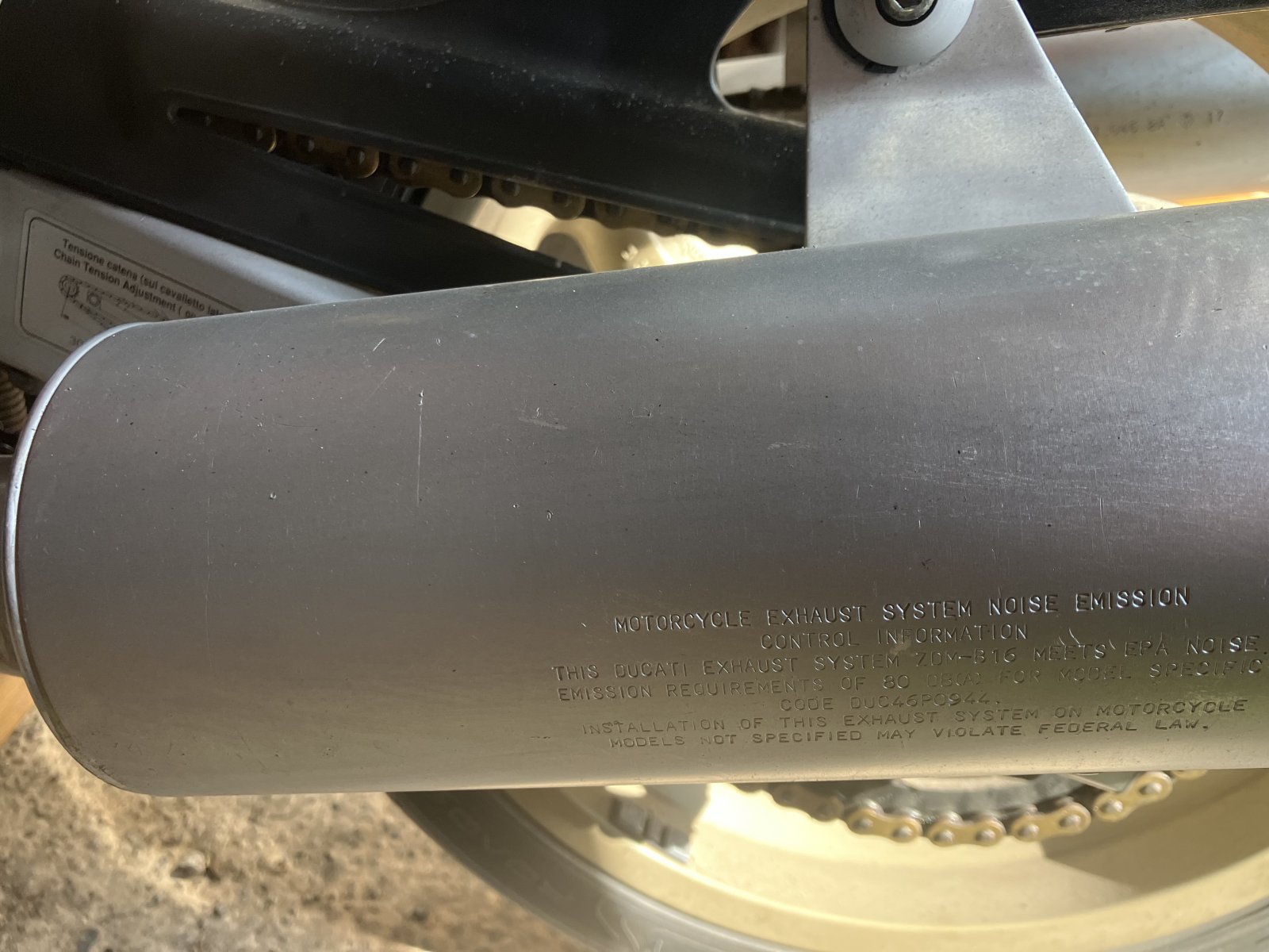

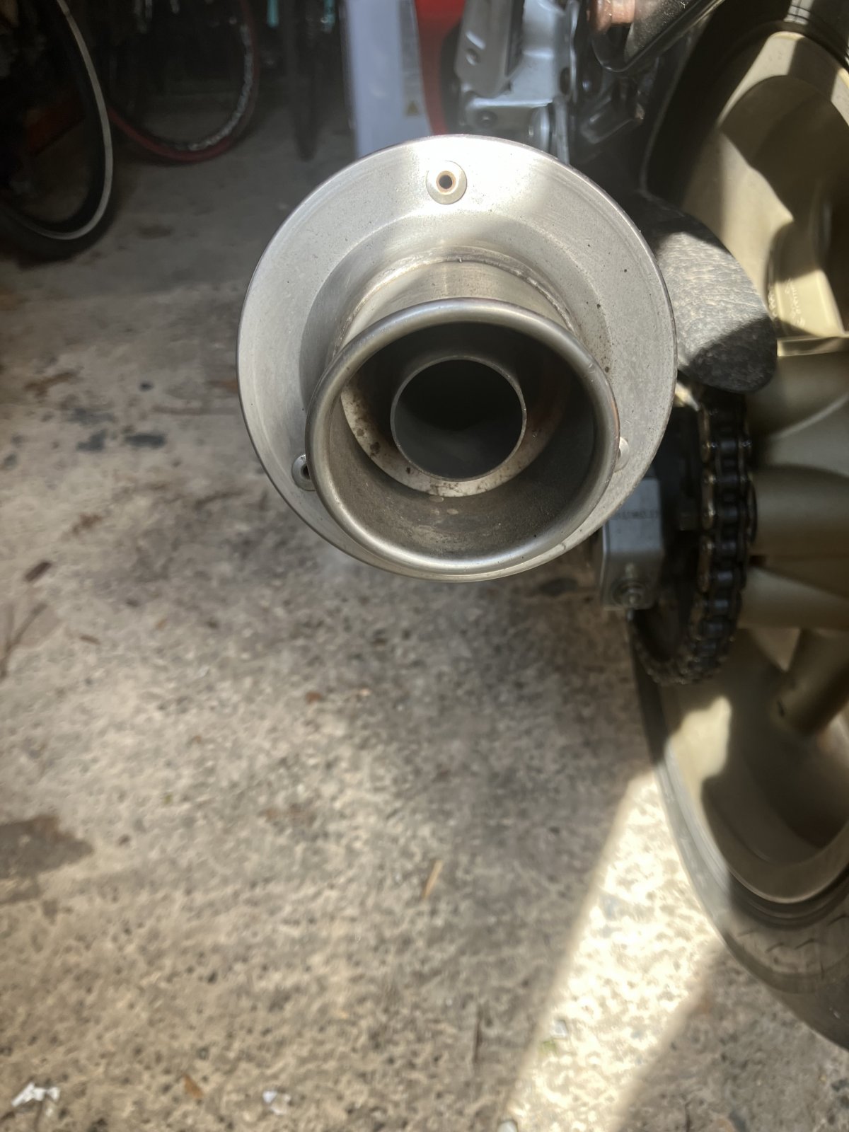

  2. Is it noisy. Would be a clue. Post some pics of them, any ref numbers stamped into them and of the outlets.
  3. A few photos, they are not particularly noisy so I’m guessing they are standard not performance? IMG_5235.jpeg IMG_5236.jpeg IMG_5237.jpeg
  4. Standard type-approved and baffled exhausts
