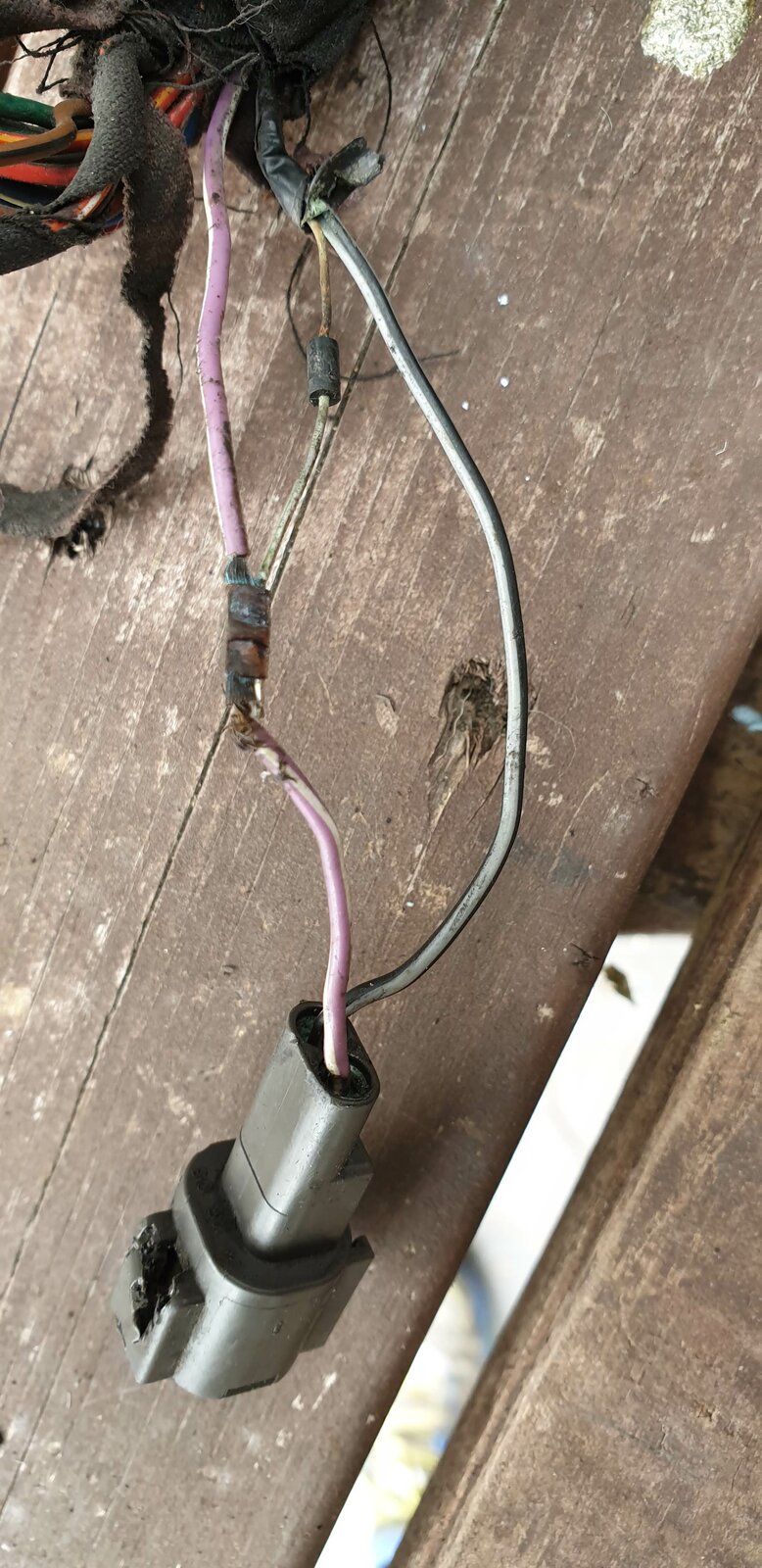

    Replaced both relays (headlight unit and fuel pump)
    Replaced Starter relay/Solenoid with genuine new part
    Removed lower harness and checked connectors/wires - there was a fair amount of corrosion which I cleaned.
    Cleaned and re-soldered the diode connector for the start relay
    Changed the regulator
    Used a fair amount of contact cleaner

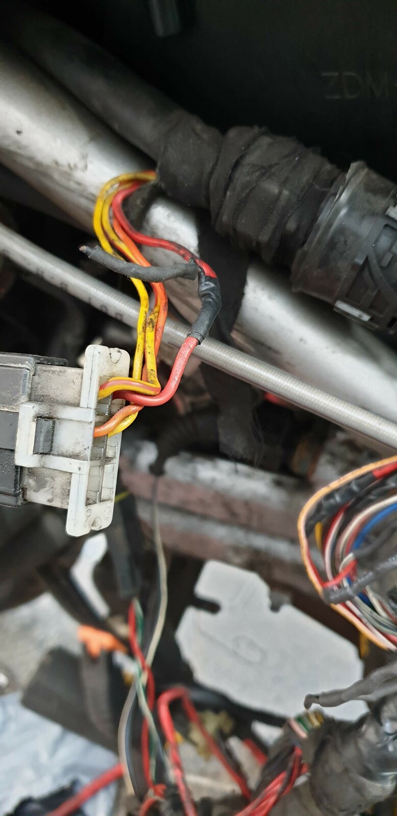

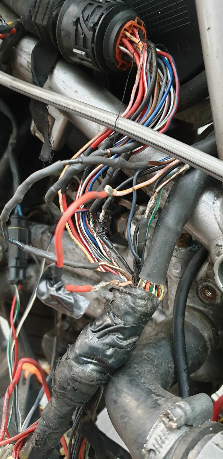

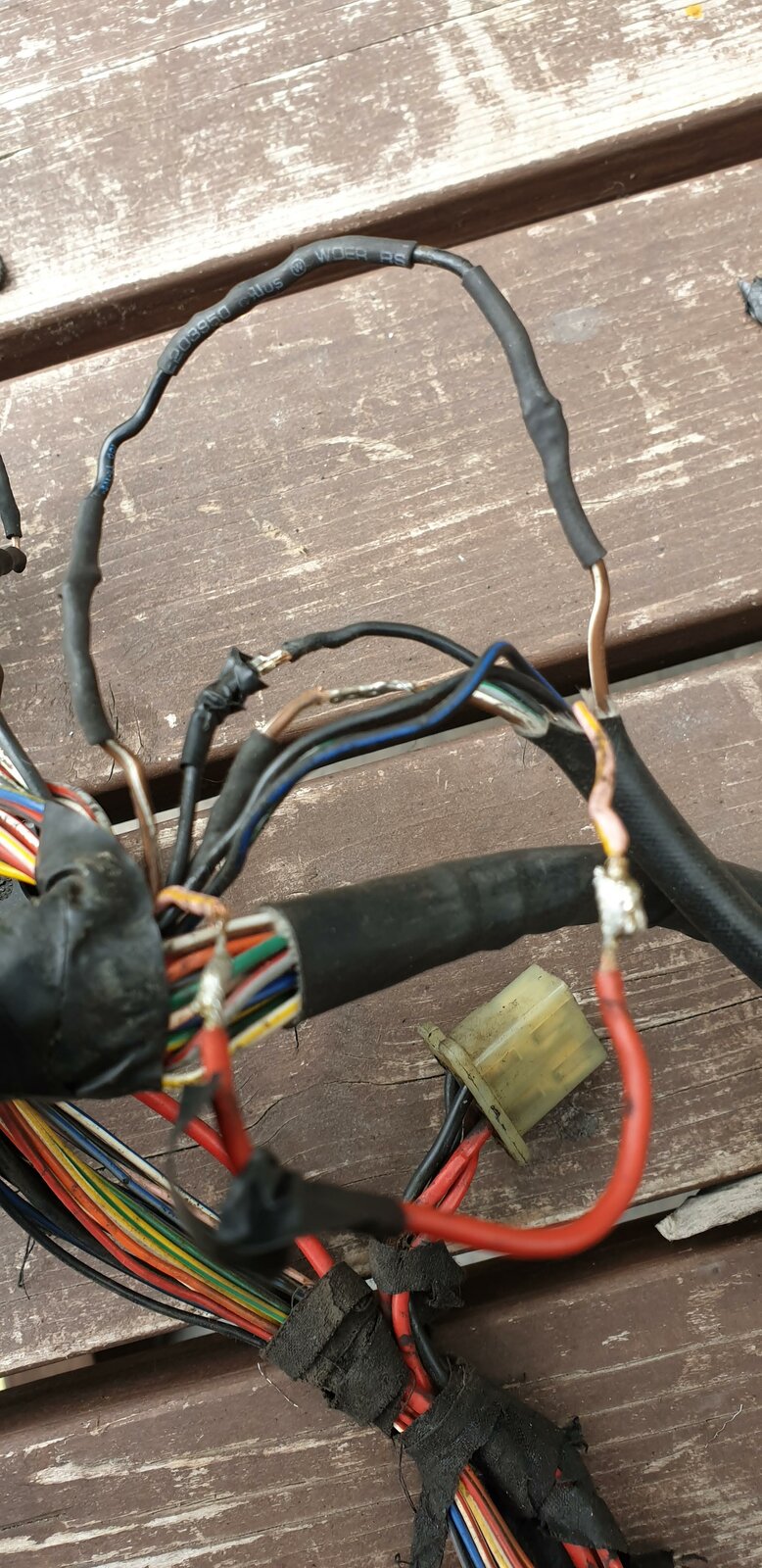

  9. I would be checking the repairs to the loom after the alarm removal

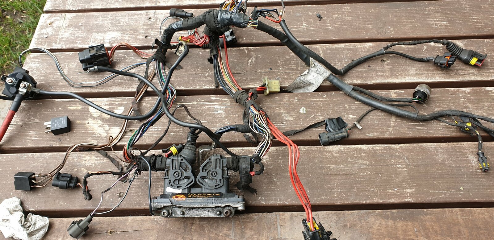

  10. I removed, checked connections, and tidied up the loom last week, before refitting and testing again on Monday. There's always the possibility I've simply covered-up the problem, so I'll retest connections with a multimeter

  12. ON another bike I had the same issue. I’d changed the battery and this had caused the sidestand connector to become unplugged at the back of the fuse board. It looked seated but it wansnt. Drove me nuts but eventually I found it. Can remember if you said you’d checked that

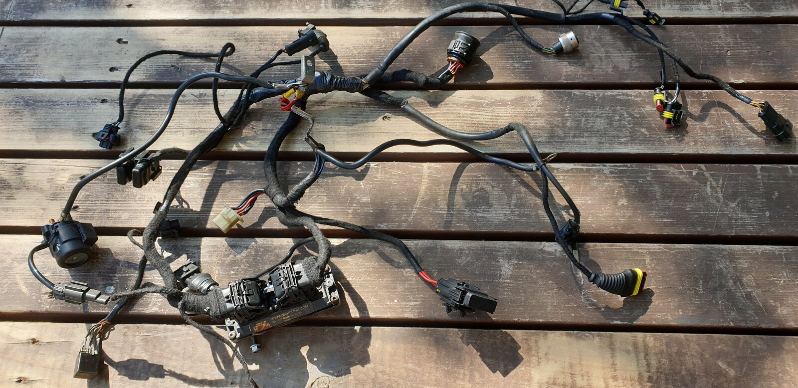

    I then tested with an alternate wiring loom : Same state: code 19.2

    tested with alternative wiring harness.
