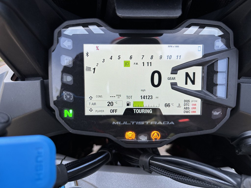

    Had a great time until about 3 miles from home when I felt the bike go limp, looked down at the dash and the ABS and Warning Light showing amber and error codes in red on the dash, managed to get it home no problem.
    [​IMG]IMG_1417 by , on Flickr
    When I got it home I switched it off then back on and the error codes have disappeared. As a matter of course I took of the exhaust guard and checked the exhaust flapper, it was in the open position and moved freely, gave it a spray of WD40 and its moves fine.
    Going to take it out first thing in the morning down the dual carriageway, I'm sort of hoping the error codes come back on so I can take it to Ducati to check it over, wonder what could have happened.
    Anyway still a great day out and what a bike it is, wish I'd bought it years ago and it would have saved me a few pennies in wasted other bikes I bought and quickly sold...
  2. Whether they’re on or not the errors will be stored in the memory of the bike’s computers so your dealer will be able to see what happened and when.
    Its most likely a problem with a wheel speed sensor as they feed everything else, hence the ABS deactivates as does the DTC and DWC, for without accurate information from both wheel sensors, front & rear the systems don’t know what to do.

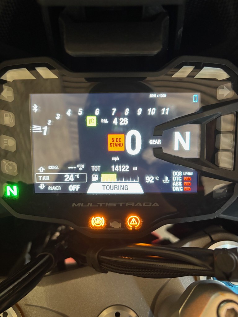

  14. Well, just took it out for a test as I was thinking about taking it up to the dealers, no lights or error codes on when I set off, the ABS light went off as I pulled away, got about 1000yds down the road just about to pull onto the dual carriageway and the error codes and both ABS and warning light came back on.
    [​IMG]Untitled by , on Flickr
    Turned round and got it back home, Ducati Roadside assistance are on the way to collect it and drop it off at my nearest Ducati dealership, spoke to the service department to give them a exact description of fault and its coming to them for end of the day.
    Hopefully its a quick fix whatever it is...

  15. There’s nothing to stop you riding the bike, just be aware you’ll have no rider aids operative. No ABS, no traction control, no wheelie control - just like the old days, but the engine will still start and the bike will still run albeit the various warning lights are on the dash.
    FYI, the wheel speed sensors are small black cylinders connected to the front fork, LH side and rear axle RHS and they face what’s known as a phonic wheel, a perforated disk attached to the wheel. They measure the rotational speed of the wheel. Various computers eg the ABS system and the BBS (that’s Black Box System which controls your rider aids) continually monitor the output from the wheel sensors. Any sign of a discrepancy between the speeds of the front & rear wheel and the systems react instantly and accordingly to prevent wheel spin, slide or lock.
  16. Appreciate the info on these sensors, the bikes at the Dealers, hopefully its a quick fix to whatever is causing the issue...
  17. Dealers just rang me and they are thinking it’s the battery as they are seeing low voltage drops? Told them it’s a brand new Lithium battery which is always on a trickle charger and always says battery fully charged?
  18. considering it resets and only comes on after a short ride i'd be surprised if it was battery related uless it aint charging properly. the airgap between the sensor and reluctor ring/phonic wheel is critical. i wonder if the ABS sensors are secure.
    do they still use the brake disk mounting bolts as the phonic wheel? is one or more missing?
  19. He’s doing a battery test tonight, I don’t expect any issues with that. Then I’m going to try and send them pictures of the faults when they contact me tomorrow, show them exactly what I’m getting.
    I honestly thought they’d just plug a computer in and it would come up and point to a failed bit of kit straight away, like a potential speed sensor issue?
