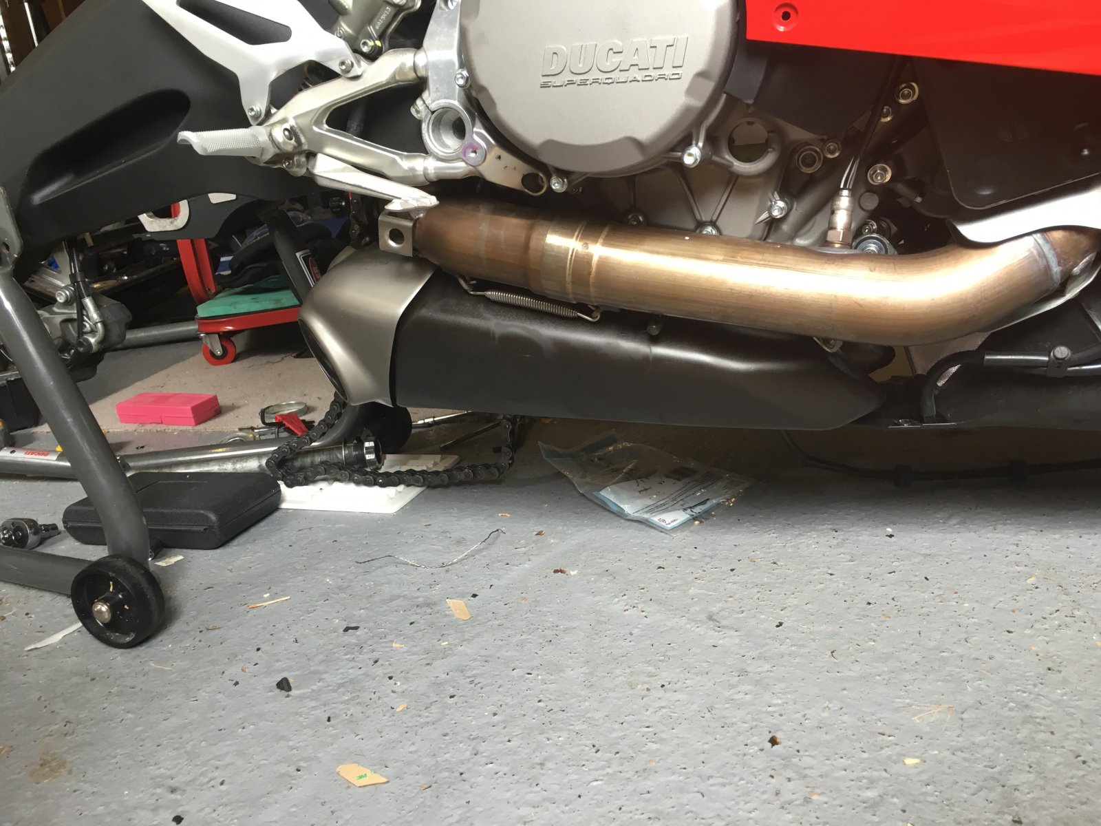

  1. So, in preparation for my exhaust swap I whipped off the old system. A few people in another thread have asked about weights, so I will start off with the standard 959 exhaust section weights, then update this thread with how successful the swap is later.....
    Under belly section = 5.9kg
    Twin tail pipes = 3.8kg
    Rear foot pegs = 0.9kg
    So all in the Euro 4 exhaust and rear pegs weigh just over 10.6kg!

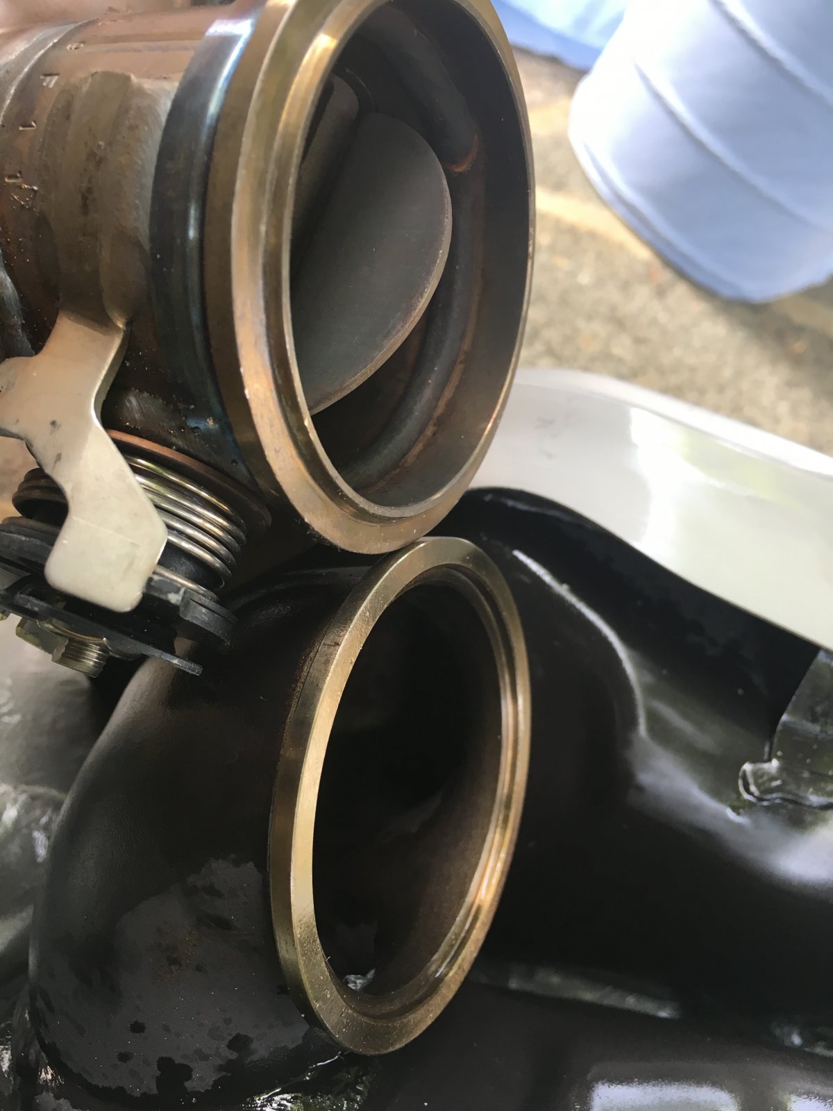

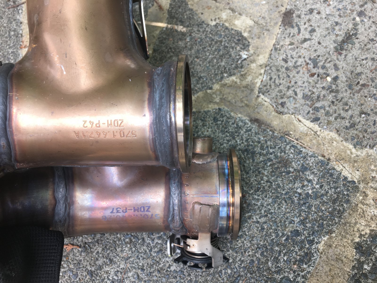

  13. Delivery day! Just weighed the under belly pipes and they are just shy of 6kg, so the weight saving (with no rear pegs) is just over 4.5kg. Not bad for a standard exhaust!
    The bad news is that for some reason they have swapped the male/female sides of the connecting flange, so I'll have to swap the connecting pipe over (assuming that fits!).

  16. These are the male/female flanges I was talking about.
  17. I was annoyed that they hadn't done them the same way round so I could do a straight swap, then I realised the flange location on the connecting pipe on the US one is about an inch or so longer to fit the flapper valve, so I had to change that anyway.... So anyone planning a swap really needs the connecting pipe if they don't want to mess around too much (the connecting pipe, although a pain to change, does fit our header pipes).

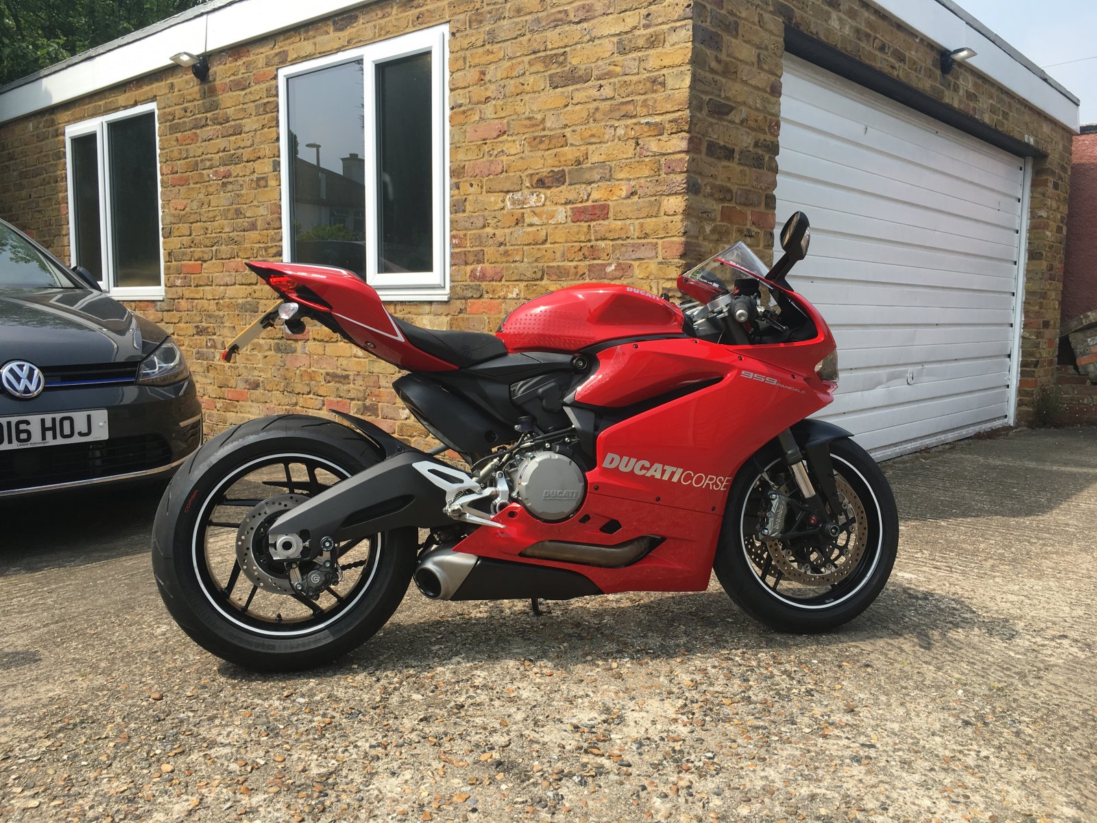

  18. Looking better already...
  19. Sounds much better..... Well worth the swap!!
  20. Great work
    Does it run ok?
