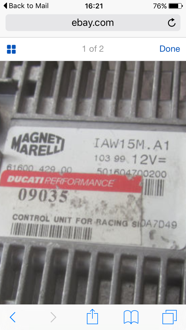

  9. I think early monster ie had different cams so the dp ecu may differ but will be within fueling tollerance anyway. I have some pics of dp ecu's from ebay. I'll dig them out. I ran cans only with std ecu and it ran well with no probs. When I put k+n and cut the airbox lid it ran a bit sick. I don't think the dp ecu are worth the money they fetch, I wouldnt pay more than a secondhand pc3 which can be tuned on a dyno for a much better result. That series of ecu were a bit under developed imho, my 907ie 10 yrs older runs sweeter than the SS.

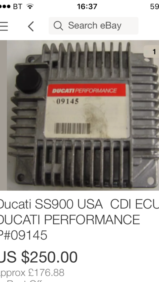

  10. image.png image.png The numbers are very confusing.
  11. Thanks, yes those are the two I was looking at. The top one the seller has told me is no longer available. But the bottom one I might go for if I can be sure it would work with my 1999 900SS...
  12. Those were in usa. Theres one in uk for sale about £200. What have you done cans filter? Check with nelly first he might be able to flash your ecu to same map.
