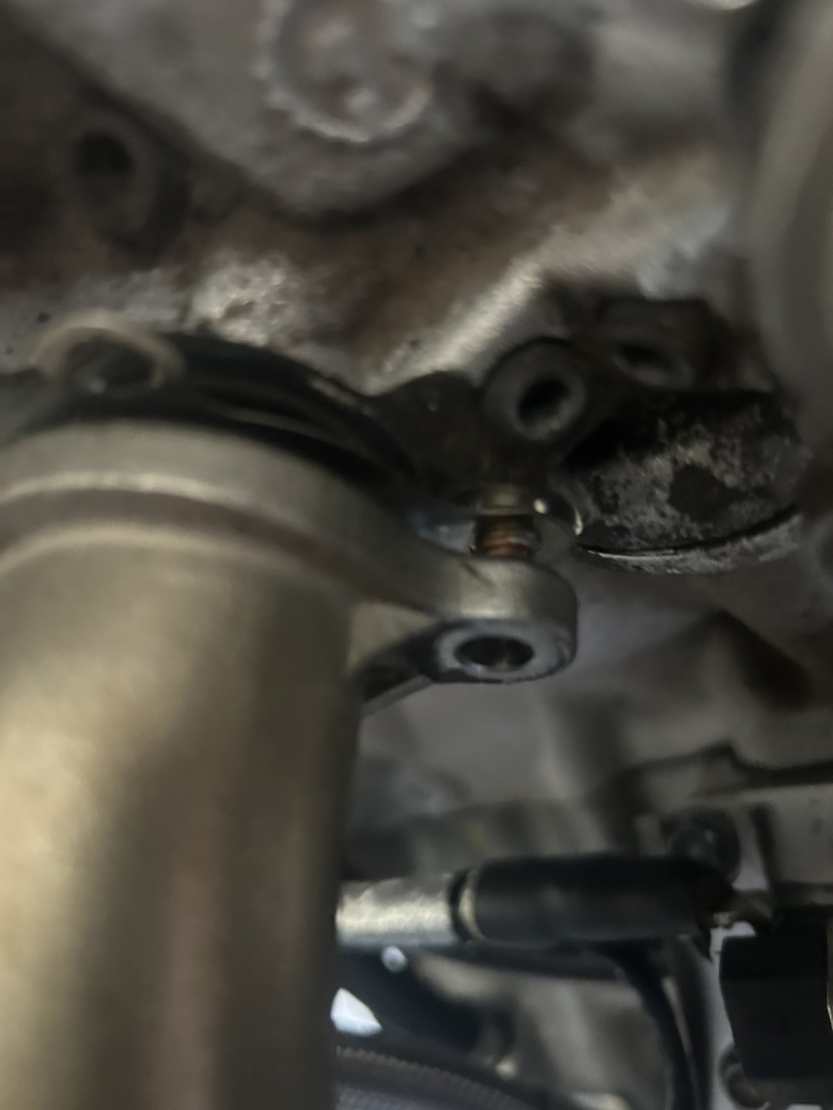

    fitting evotech engine and radiator guards. the middle guard fits to a bracket where you remove a couple of the exhaust nuts and slide the bracket over and then refit the nuts.
    instructions say tighten to 10nm.
    unfortunately i had knocked my torque wrench into 12 nm and when i tightened one of them it snapped off.
    question is will this be ok to run with just 2 uts on one of the down pipes or is it an easy fix or is it a mega cost dealer hob?
  2. If it snapped flush to the head - tricky.

  6. am i right in thinking if there’s some of the nut protruding and i can get it , that it will unscrew? and also i can get a replacement from ducati ?
  7. Yes. If some of the stud protruding then get a pair of mole grips on it and wind it out. If you can’t then I’d take it to an independent motorcycle shop who will be a lot cheaper than Ducati to sort it
  8. Can you post a photo?
  9. yes i’ll take the guard back off and try and get a picture
