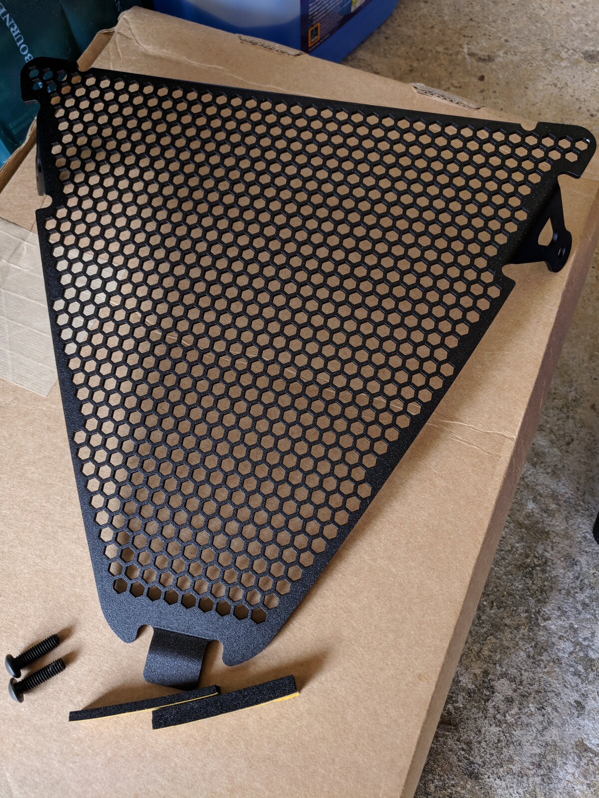

  1. For now, I've just got the revised Evotech lower rad guard to go on and whilst it's a simple install, what's not clear in the instructions is where the sticky pads go.
    It came with two pads, both the same length, but one is twice the thickness of the other.
    The only position their instructions actually show is a smaller piece on the tab at the bottom, so I assume this needs to be cut from the thinner pad.
    I feel really dumb asking this question, but where should these pads go on this guard?
  2. Noticed in a YouTube video I watched that the guy only received one pad, which was the thick one, and he stuck it at the bottom, horizontal above the tab, so I did the same. The rest of the guard doesn't touch the radiator, like I've seen on previous bikes I've had.
    One of my stock fairing bolts you remove to fit this guard was missing the nylon washer, so I used a spare one I had on one of the supplied bolts, then reused the stock washer on the other.
    Will probably get the high Evotech rad guard as well, when EP have got them in stock. There are some on eBay, but at inflated prices.
  3. I fitted the R&G ones but the principle is the same. I cut the pads into approx 15mm pieces and stuck them around the edges of the guard.
    There's no more science to it that that really. It's just to prevent the guard from coming into direct contact with the radiator.
  4. I was debating putting the thin one above the bottom tab, then cutting the thick one into pieces for the sides, but when I saw it wasn't touching once fixed in place, I went with the other approach.

  8. The R&G instructions did actually say to cut the strips of pad and apply them around the edges, but as long as you're happy it doesn't touch then all is good IMO.
  9. The Evotech guard doesn't have the frame round the outside of it like the R&G one. In hindsight, I think I may have done it the wrong way round and was supposed to use the thin pad above the tab and cut the thick pad to put down the back of the left and right sides.

  12. Perfect I will definitely give this a go! thanks very much
