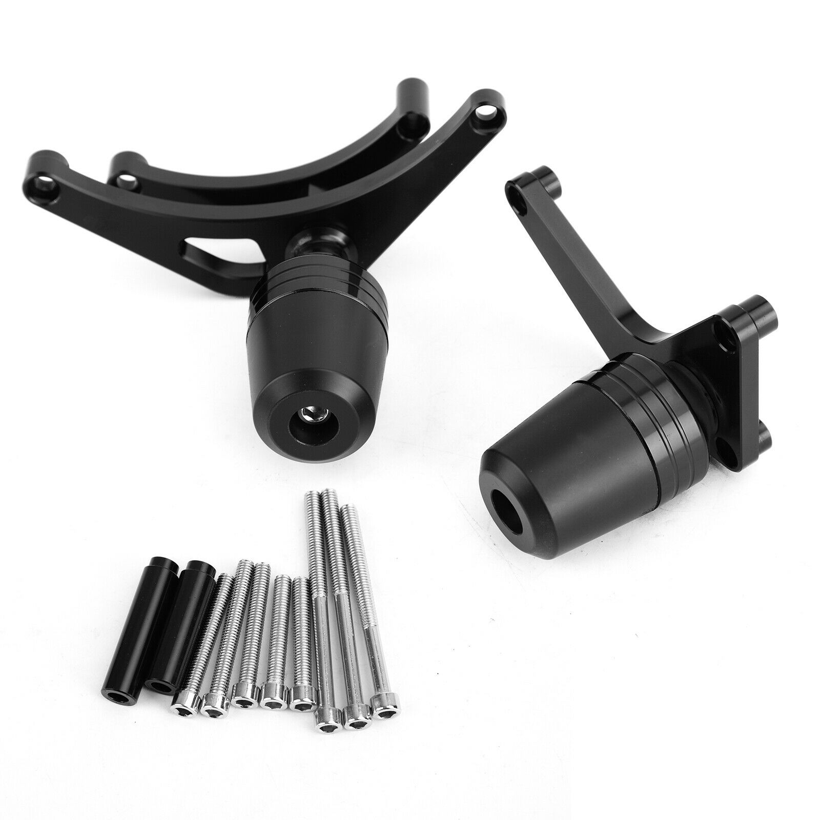

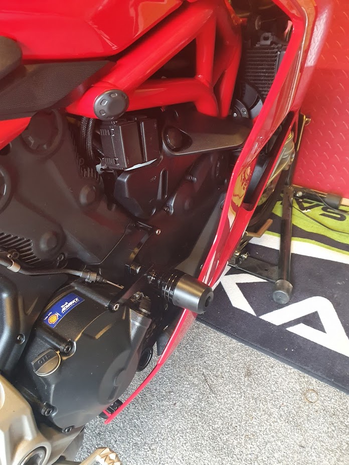

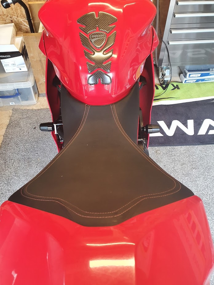

    The crash bungs were Chinese from eBay which Crash bungs.jpg 20210321_150829.jpg 20210321_150811.jpg I quite liked the look of and at £85 were a saving on R&G type. Did not want to drill holes in the fairing either. I am pleased with the finish and they fit well and will protect the engine cases. No instructions though and it took a fair bit of figuring out where they went. I am happy with the final result.

  15. Ah cheers, I will fit them then. The crash bungs are on ebay now for under £60. Easy to fit but let me know how long it takes you to work out how if you get some. :)
