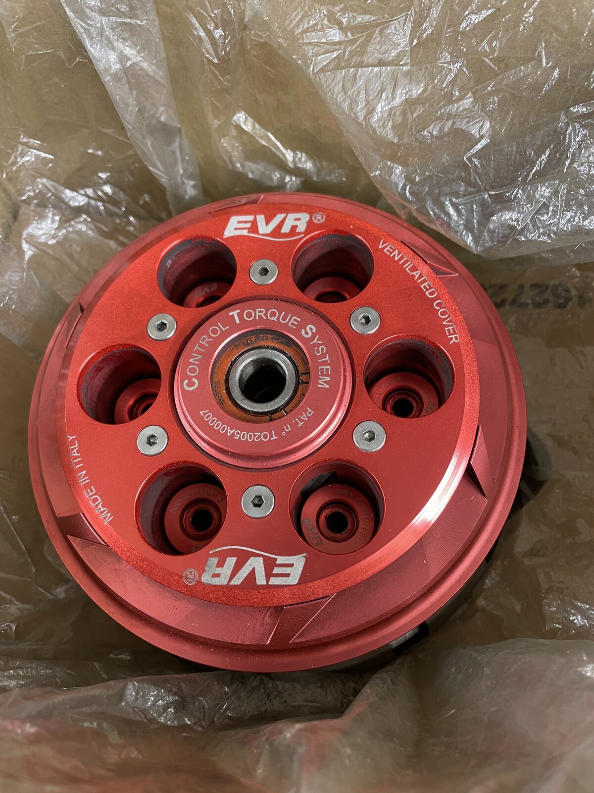

    Back with another question!
    So I’ve just bought a slipper clutch which was previously fitted to a 1098s.
    After researching I now know the centre but is a different size so I’ll need one to fit the 748 but on other posts I’ve seen there is debate on stack height and “over slipping”
    The unit I have has 3mm retainer washers for the springs- am I going to need thicker ones?
    thanks!

  2. Centre nut is a different size, as you mentioned.
    Regarding the spring washers - not sure of the thickness you need. I suggest starting with the ones you have already.
    I would expect that it’s the spider spring that controls the amount of “slip” (while downshifting/overrun). The 6 x clutch springs would control the effort required to release the clutch and whether it slips under power.
    This is based on the assumption that the EVR clutch works in a similar way to a DP/Bucci/STM system.

  3. Thanks Ricky-
    I’m lead to believe this particular clutch does not use spider springs, not entirely sure what it uses instead but the manufacturer claims it requires no periodic maintenance.
    on the other posts I’ve seen the OP was saying it was slipping under acceleration so I guess I’ll just have to try it out as you said and see if I need thicker retainers!
  4. The nut is still available from Ducati and is about £22. Changing spring collars is a 15 minute job so not a biggy to experiment to get the performance that suits you. I’ve just fitted a wet version of the EVR to my Multistrada which I’m hoping is going to increase the affects of engine braking. Andy
