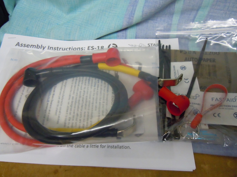

  1. Santa's been & delivered a pressy from my children. They obviously they start to listen to your hints when they get to their late twenties, early thirties ! Thanks kids :heart_eyes:
    Another little job to keep me amused while I'm furloughed !! :upyeah:

  2. When fitting be watchful of the positive lead and the under side of the tank!
  3. that's a good point Anthony, i'd also add to remember that red is the positive one. :upyeah:

  9. I've not had a proper look at the original cable routing between the battery, solenoid & starter-motor yet, but the 750SS, like the 400/600 & 900 versions, is a very simple bike & once the fuel tank is hinged up, access to the battery area is quite easy. I was hoping I shouldn't need to remove the battery tray as from what I remember when I changed the coils a year or so ago, the cable routing was quite accessible.
  10. Fitted to my 900 in the summer. Straightforward job hampered by a corroded starter motor terminal. Had to saw it off then drop the back of the motor and replace the bushes/terminal. To do that had to remove the oil cooler pipes. On the 900 there is a splitter on the +ve lead that goes to the solenoid which can be binned as the new lead goes direct. Good kit and should have done it years ago..

  19. I have a set of these to fit to my father in laws 1996 900ss, how easy is it to get to the starter motor etc to fit as i don't currently have access to the bike to have a look?
  20. If you look at post #6 Jamie, you will see the contact details for the manufacturer.
    There is a flexible boot that goes over the starter motor connection, and although it serves a worthwhile purpose, if it’s neglected, it can work against this. It’s also much harder to remove in the cold weather which doesn’t help but I always fill mine with either copaslip or red rubber grease. It’s always worth just prising this back a little from time to time to check that there is not moisture and corrosion going on out of view.
