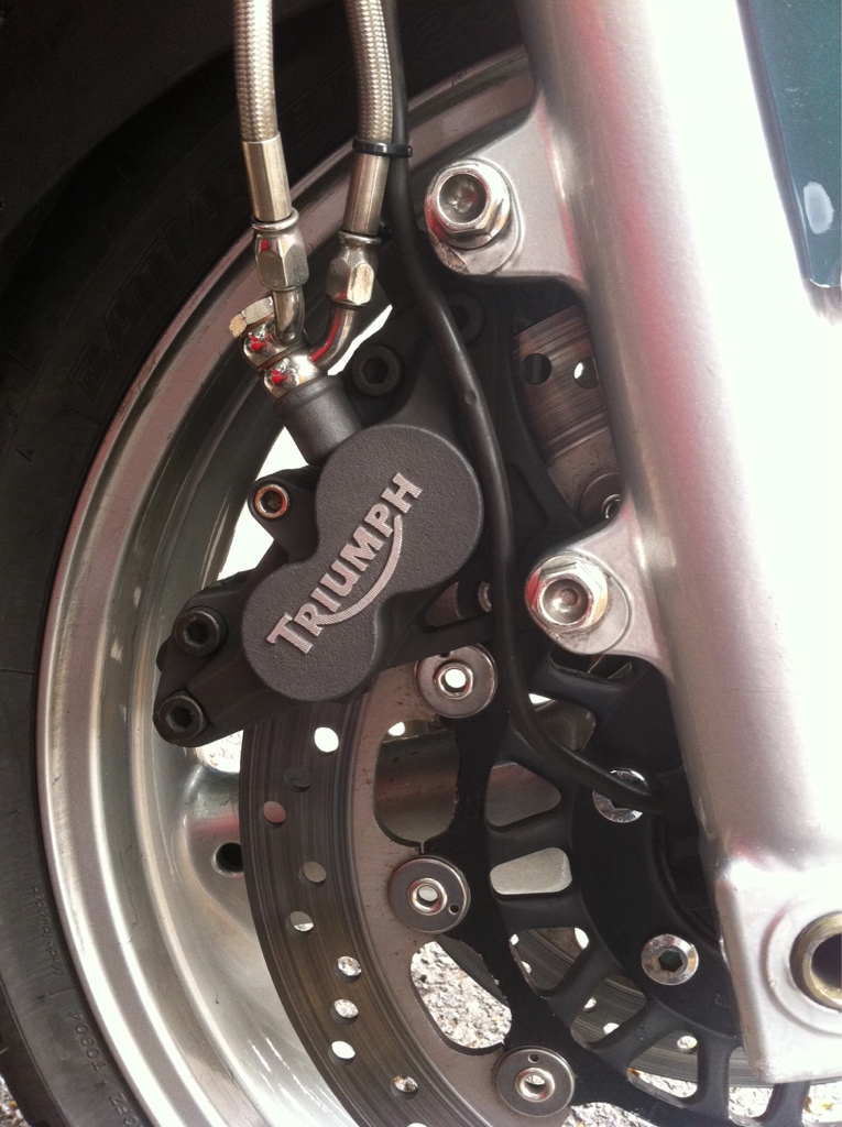

  12. [​IMG][​IMG]
    Here's a photo of the offender
