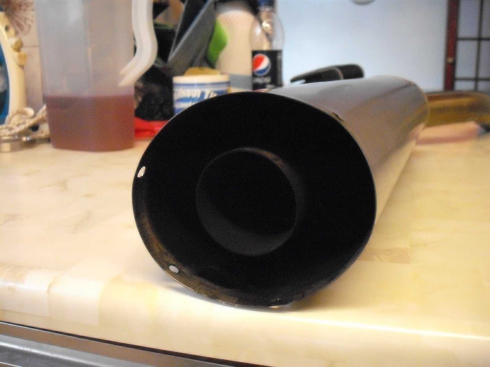

  7. I have std sl cans, very quiet! Do yours have a smaller tube in the end? Mine are full of baffling( pic to follow later) I suspect yours have been cored
  8. Are yours like this?
  9. my bike was rather loud when I got it
    not standard cans but damn loud (nice though )
    on inspection when drilled the rivets out found absolutely nothing in the way of baffling
  10. Thanks guys, mine looks nothing likE the photo, can pretty much shine a torch into the exhaust and see the link pipes !! Sounds fantastic but it's just to loud so yes they have been cored and will need re- packing, least of my problems though, see technical help thread.
