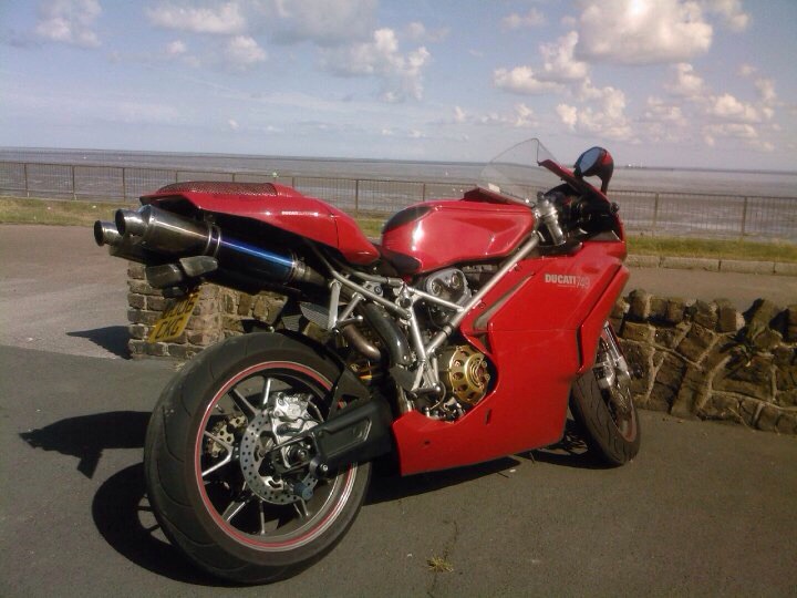

  14. I had a pair of casoli twin pipes on my old 749. They looked good and sounded awesome ( definitely much louder than the full race termi system on my current 749r) To fit the lights and number plate I dropped a thin custom bracket I made secured at the top to the pillion seat lock bolts. I don't have a pic of the bracket, but it was pretty much 2 bolts at the top a cylinder going down in between the pipes and a bolt at the bottom. Sorry I can't be of more help, but it was pretty easy to make a bracket from 'bits' lying around the garage. The actual rear light assembly and indicator looked better turned upside down. image.jpg
  15. Perfecto. This is exactly how mine should look when done.

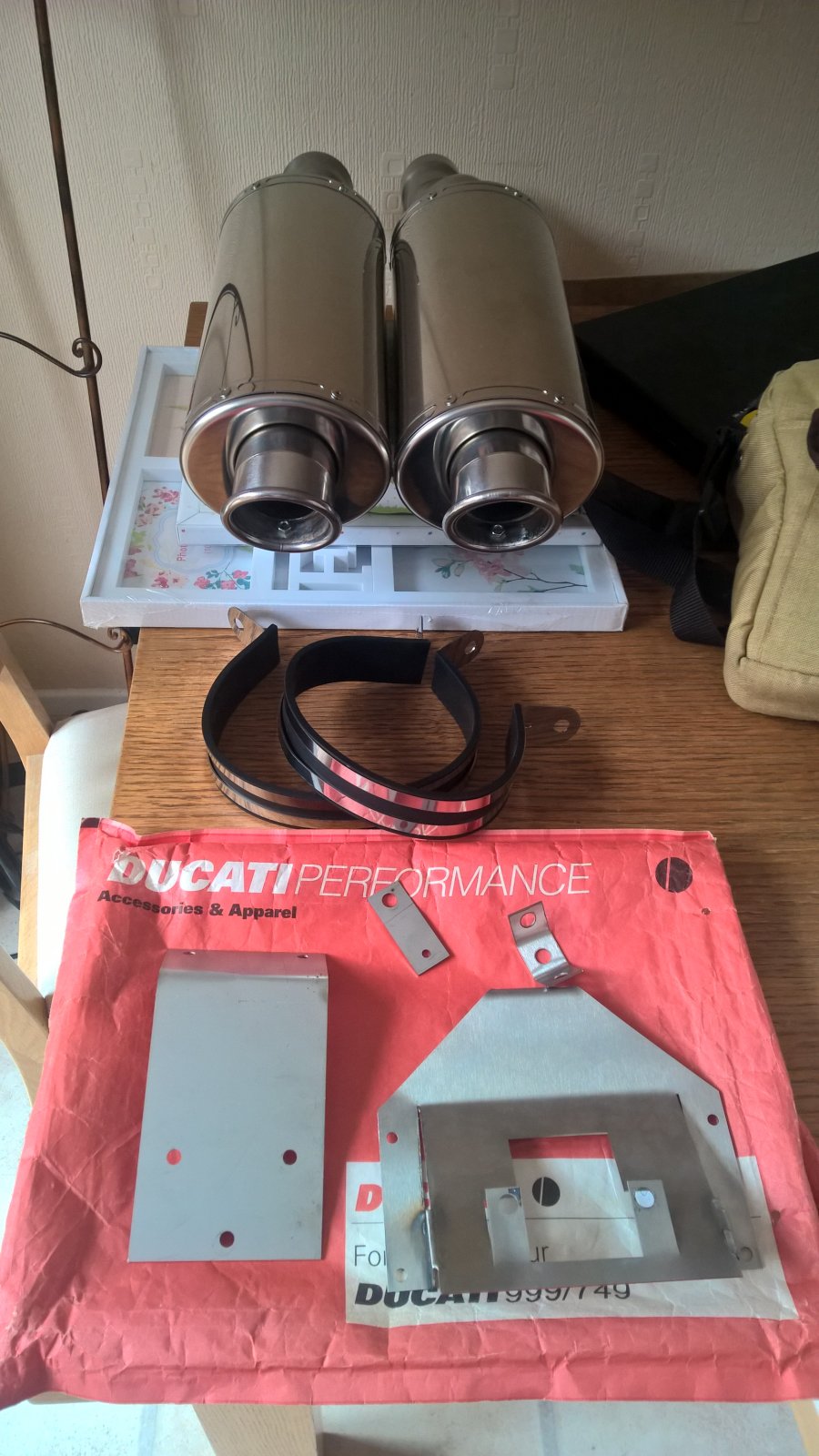

  16. Here is what arrived in the kit this morning.
  17. Nice ,,,,, ( ser 1 frame , ser 2 black box )
  18. Mmmmm, shiney !!!!!
