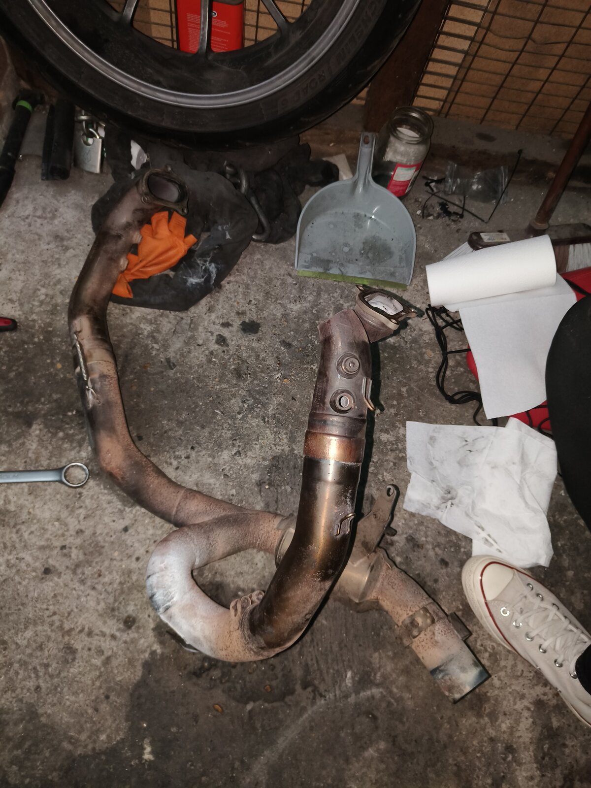

  1. can anyone tell me what is causing flames to come out from the cylinder head? is the gasket gone?

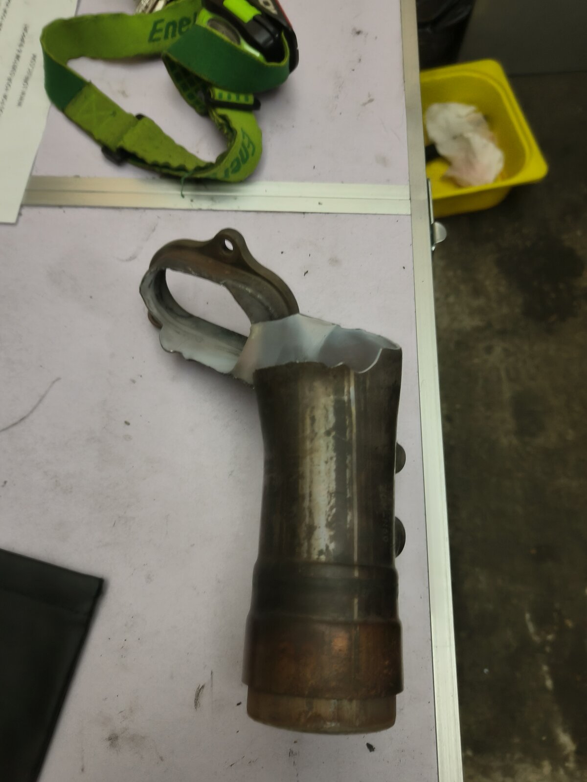

  6. Firstly stop running it, deffo stop riding it… that looks like more than gasket, it looks like the exhaust as split around the welds. Would need to see more pictures up close to know for sure, I doubt it’s the head gasket though, it’s most likely the exhaust split or gasket
  7. I didn’t realize there was a video. Phill sound correct… that doesn’t look like a head gasket from the video. Are the manifold nuts tight ?
