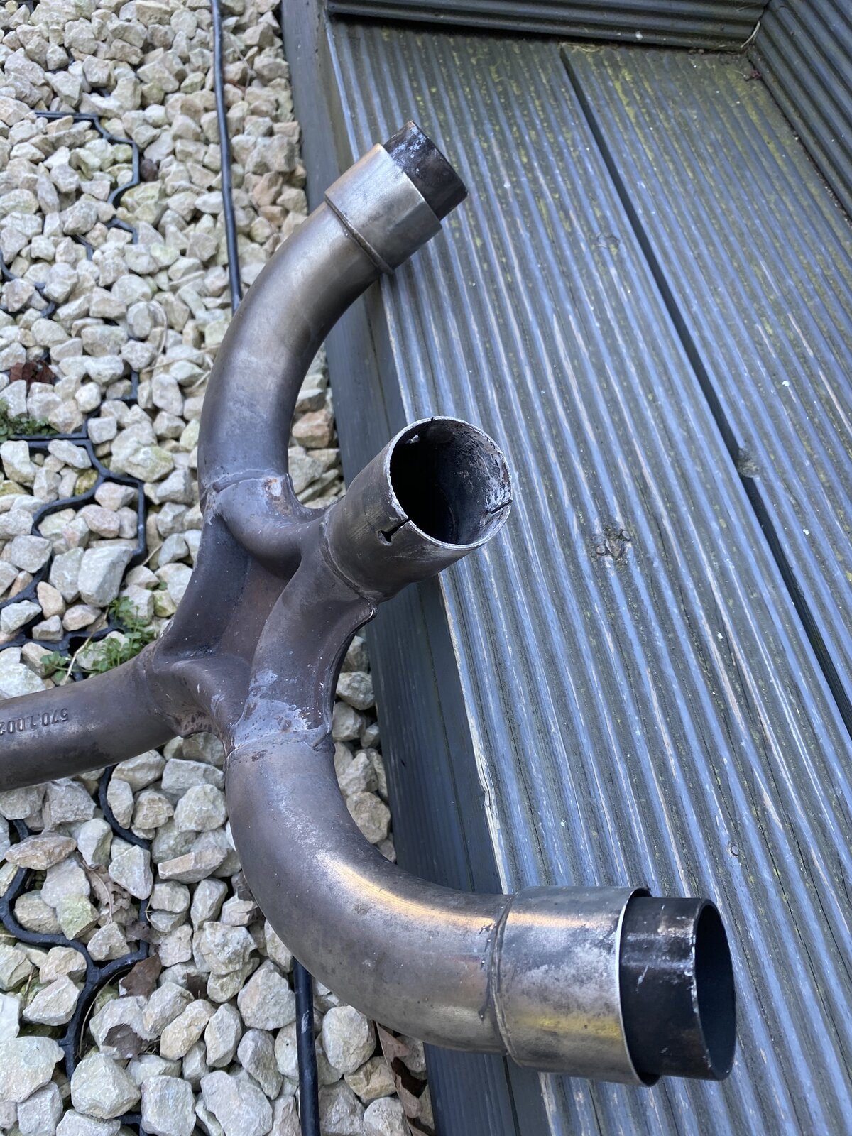

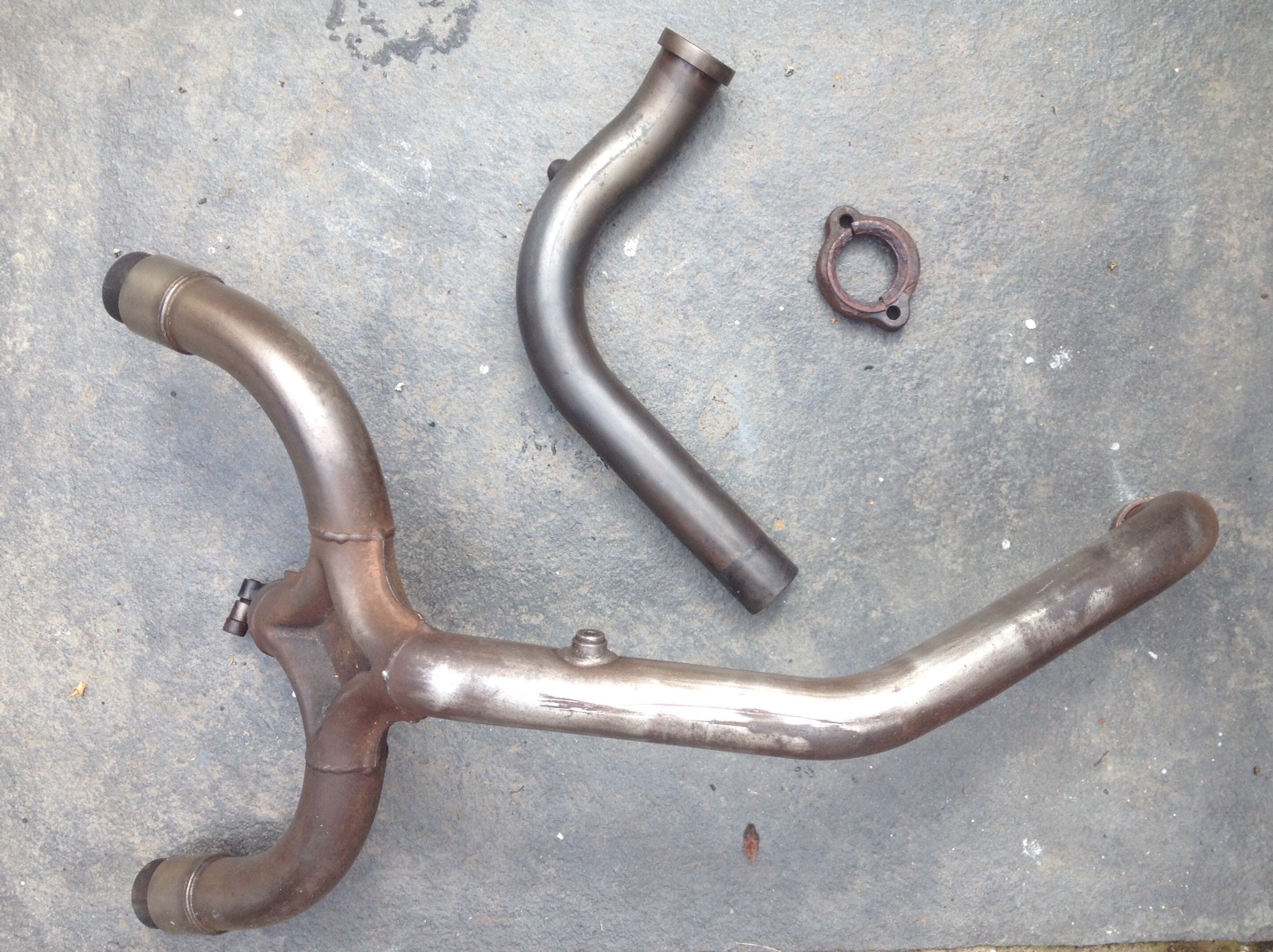

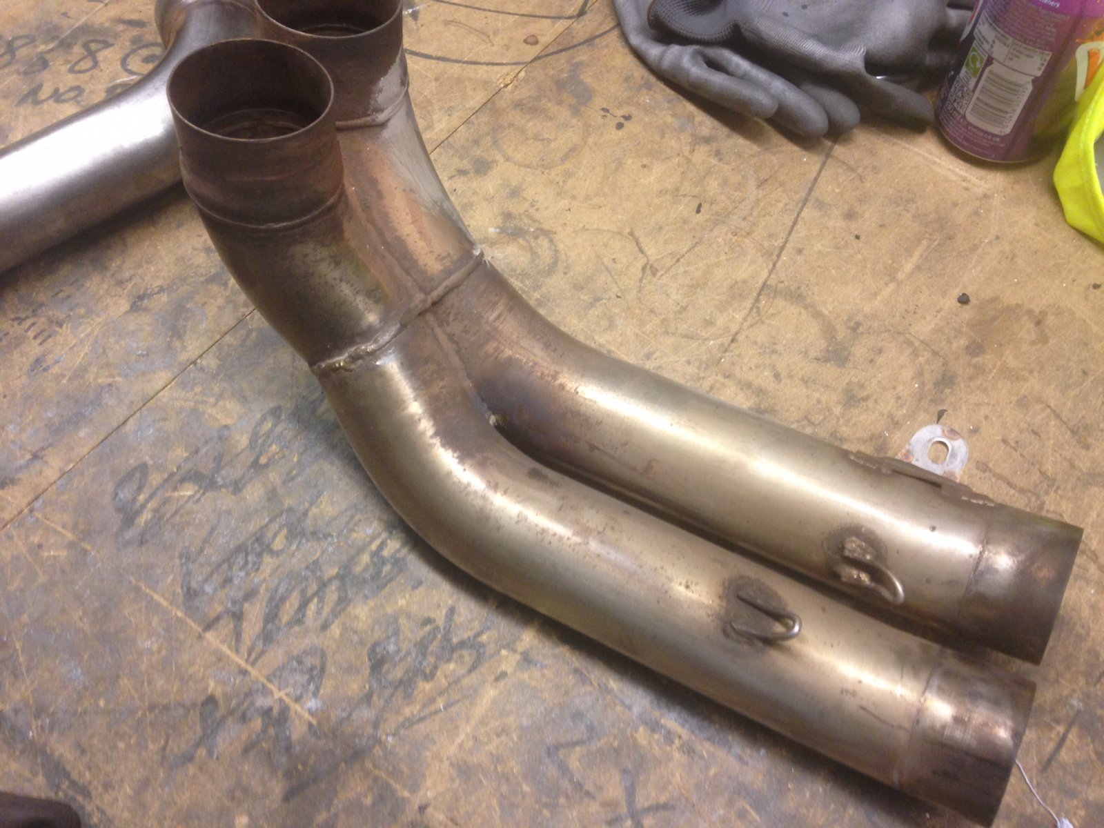

  3. 709B905F-6109-4679-9B66-9A6108BFFC60.jpeg CB627D8E-1EF0-42AC-936A-3EBF4647BCA8.jpeg A320CA29-897C-4F37-8C68-B5A31E7074BD.jpeg Here are mine. Pitted and rusty. Will a polishing kit work or need cerakoting.
  4. First two pictures show after Harpic but still not perfect, was thinking of buying polishing kit of eBay

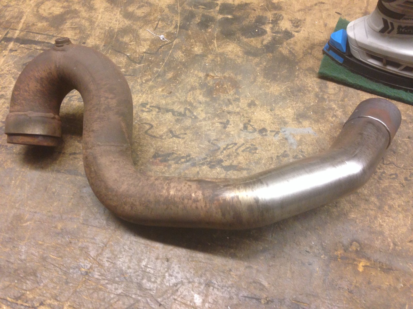

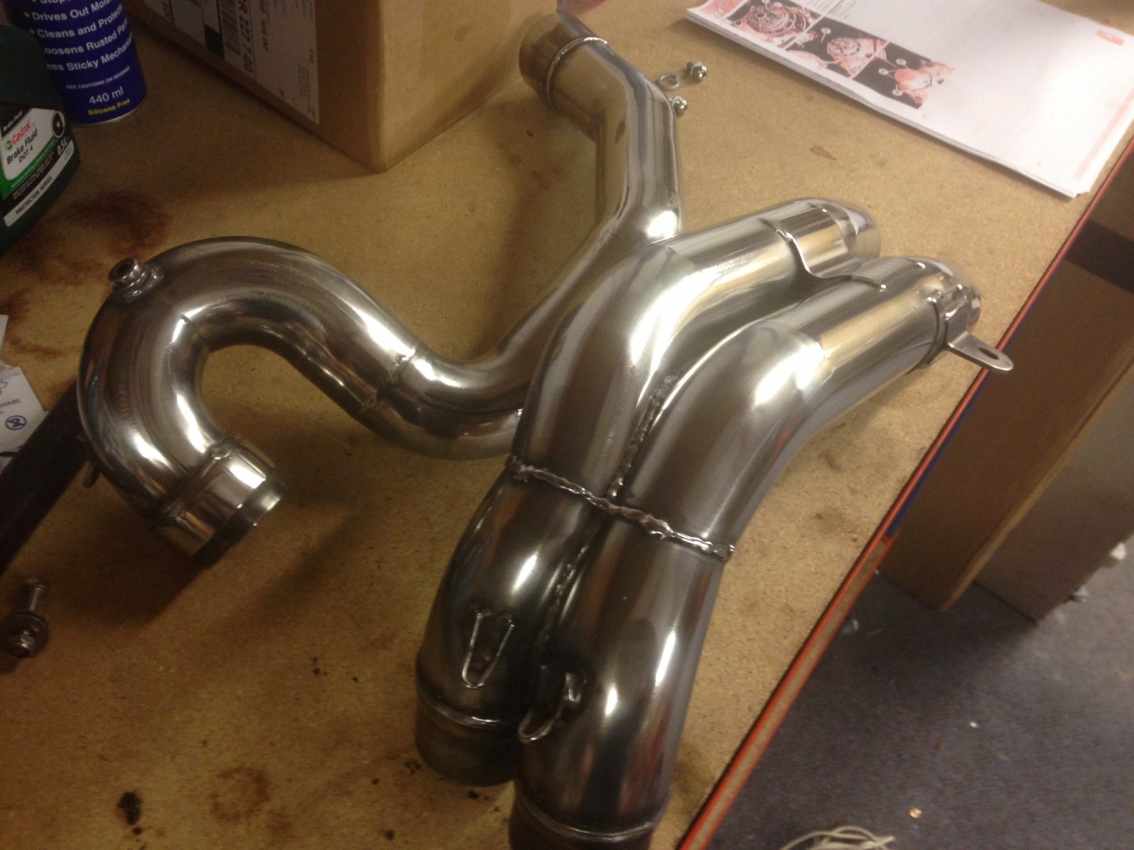

  15. If you want to have a go yourself, Scottish brit on an orbital sander will remove that and leave a nice satin finish which you can then polish up if you want.
    #15 bettes, Mar 31, 2020

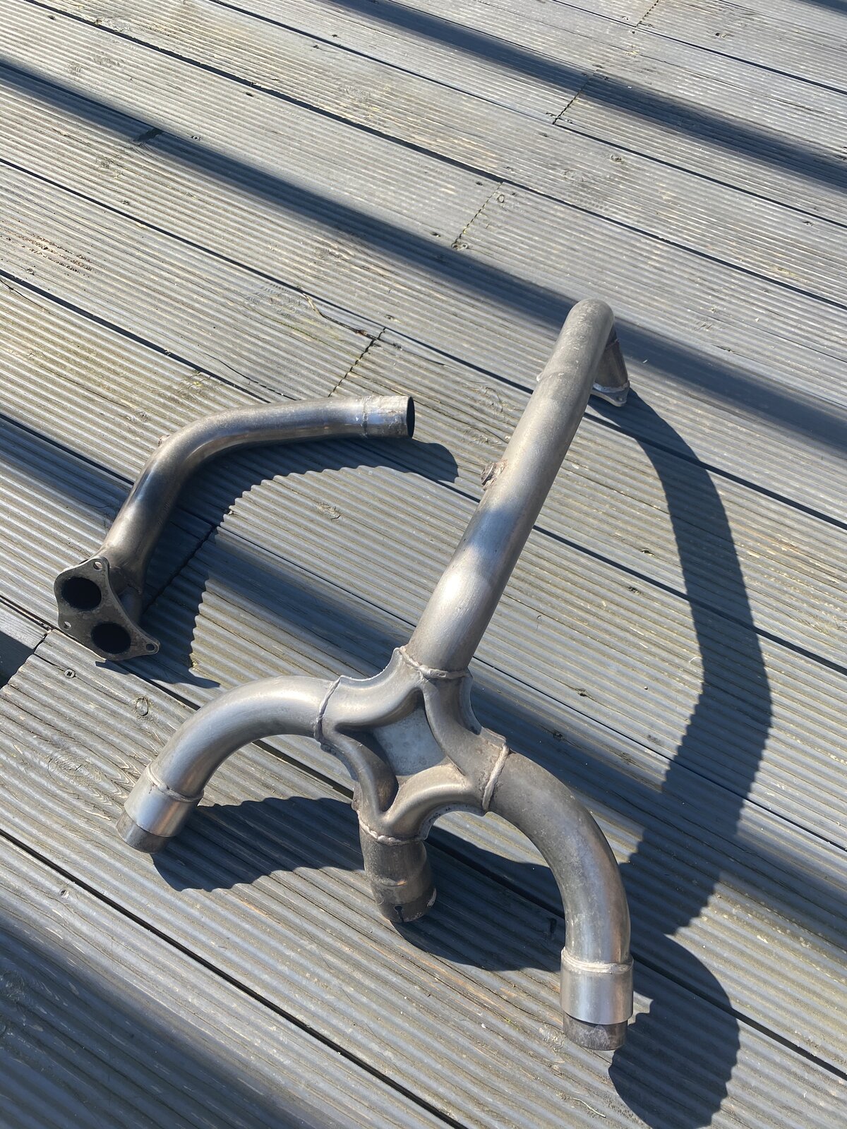

  16. 9D149239-4328-4CA2-ABA4-E93331C2215E.jpeg EBB0B66E-217F-4ADC-A274-EDEC1C1347FF.jpeg 2E519B8D-42E6-481B-86B1-CAD527A0ACCF.jpeg
  17. Just the Scottish brite, Paul. No need for anything else unless you want to polish it further.
  18. Thanks. No, not long. It was a while ago now but maybe 3 or 4 hours all in.
