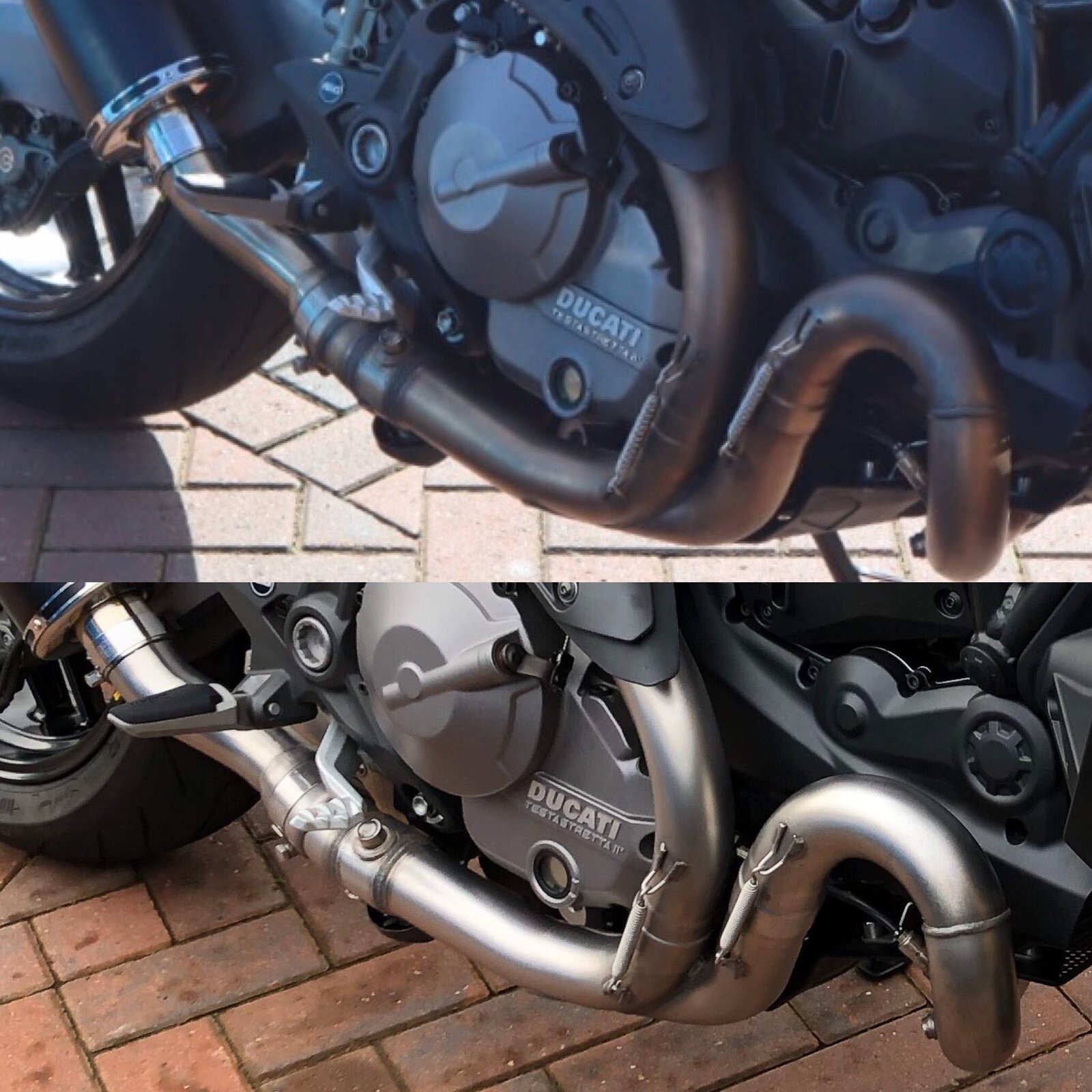

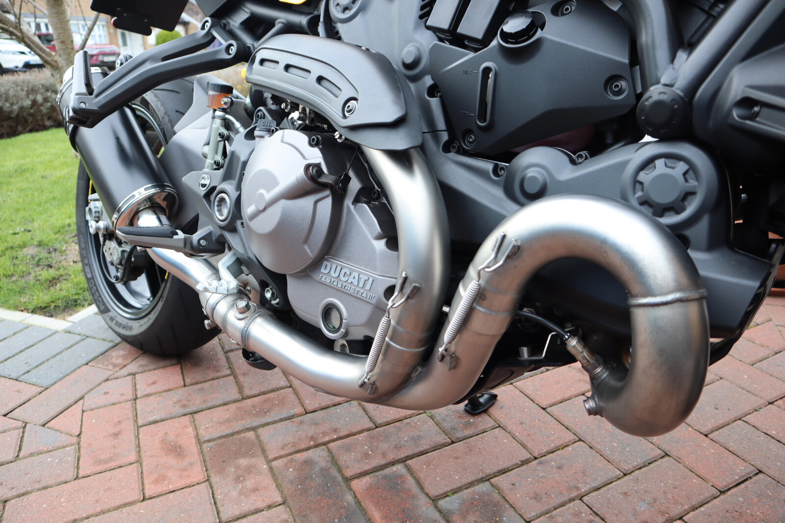

  4. Did the harpic x10 treatment on my Monster the other day. Finished with autosol. Happy with that. 0BA22C3F-D151-48B2-92AF-789D4E30BD2B.jpeg FDED64CF-3A3E-4B37-8C41-506F09FCE16F.jpeg

  6. It pretty much is as simple as brushing harpic x10 onto headers and pipes. Leave for c.10-15 minutes. Agitate a bit with a brush. Wash off. Then autosol to polish. Very easy. Just dont get any harpic x10 on anything chrome, or your hands.

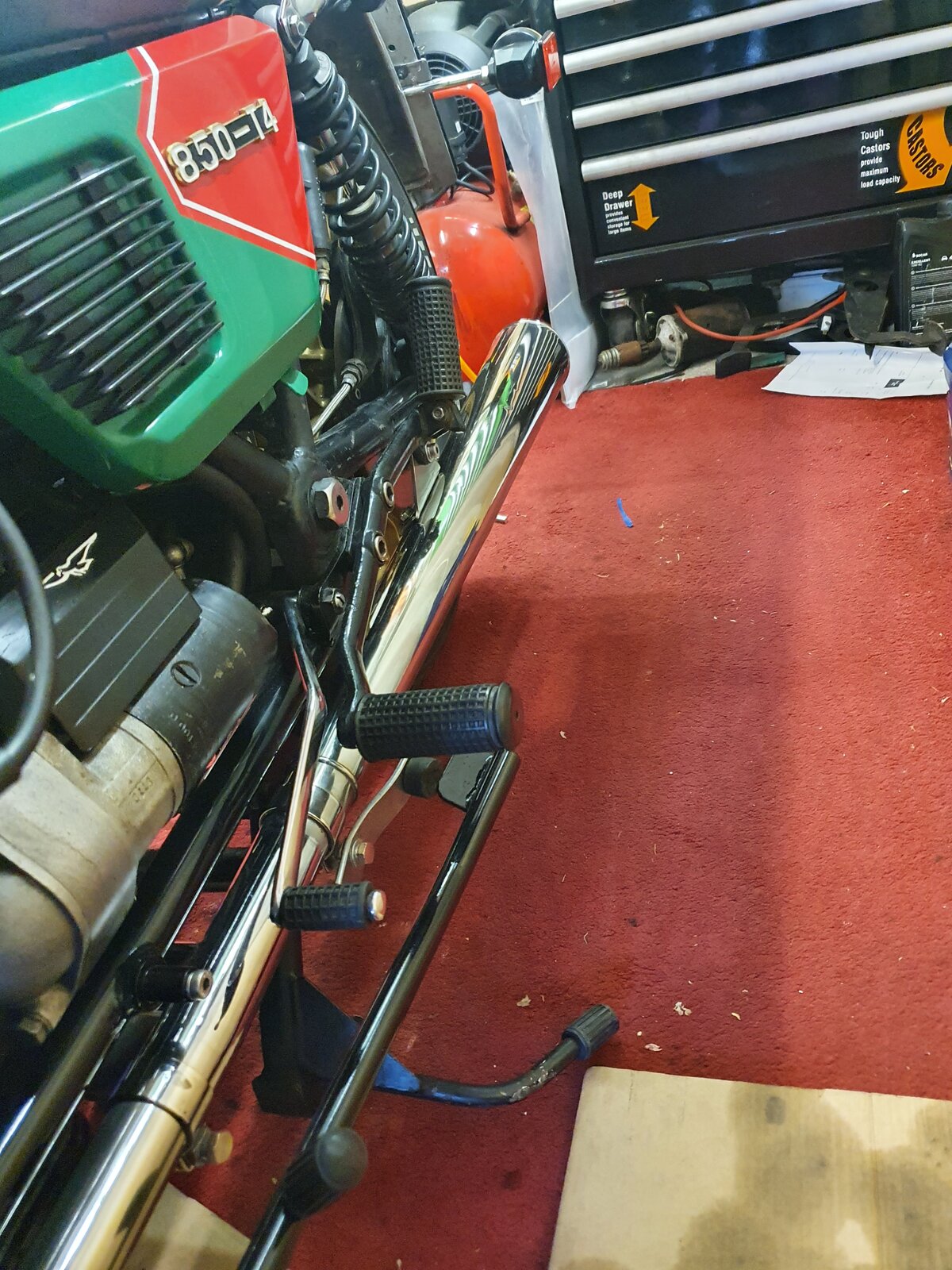

  11. If you guys are looking to get an amazing finish on your exhausts you can't go wrong with white diamond high shine applied with a terry cloth then buffed off with microfiber. You can get a mirror finish with very little work. Ive used it on my truck for years. I know its not a ducati but ill post the pictures of my dads pipes on his guzzi after I've finished polishing them

  15. This is how they should have come out buddy. It takes alot of work but they do come up as a mirror. The header pipes started out black
