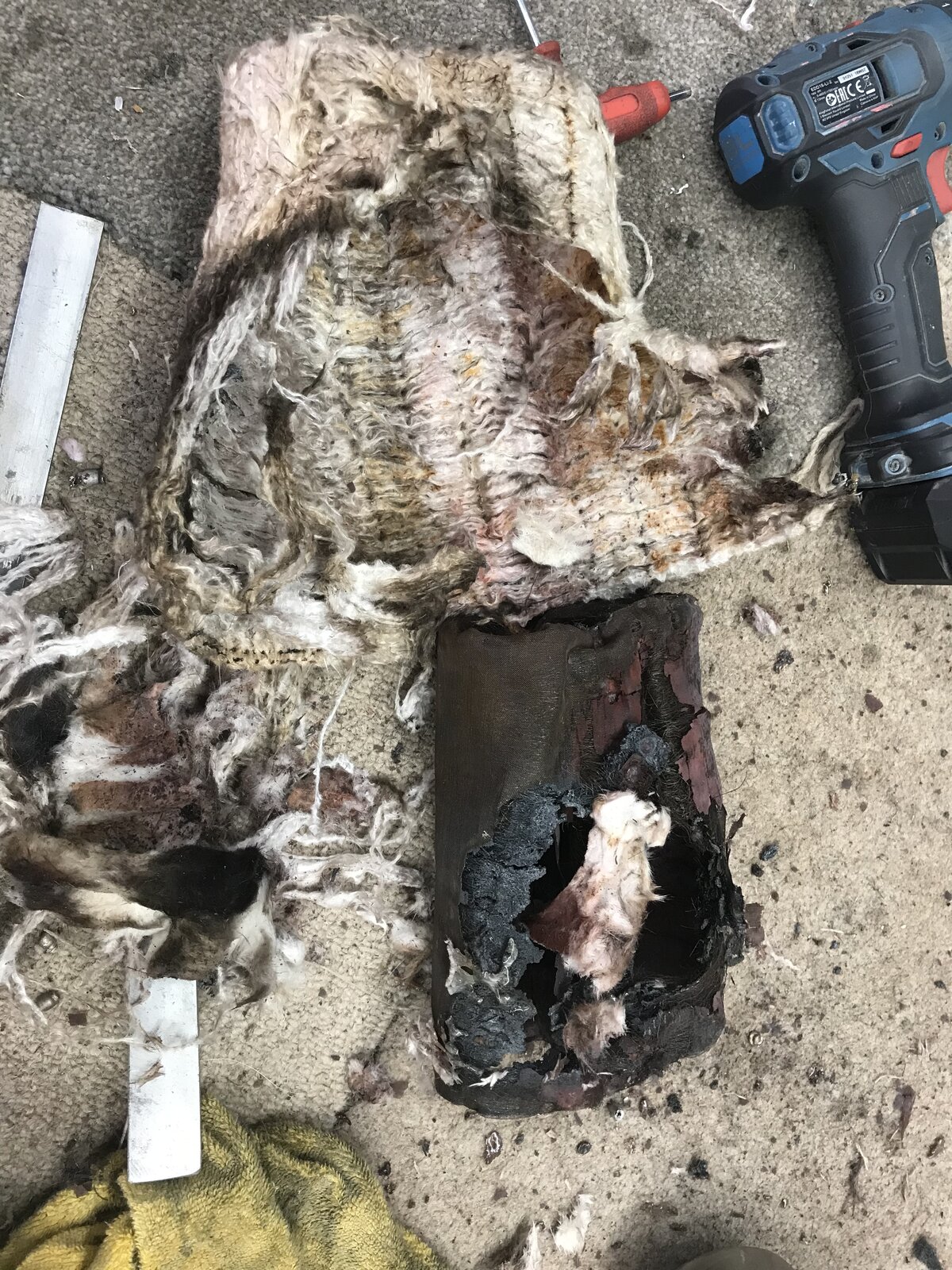

  1. Does anyone know where I can buy the kit to repack some termignoni cans for a panigale? I bought the system this week off a forum member and they’re knackered despite being told they’d been repacked. E90E87A3-C714-4684-A77B-63CF049340D2.jpeg

  6. Mine were sold as just been repacked but when I took them apart the packing was old and knackered with massive holes in them which showed up as bluing on the titanium. Fortunately the bluing buffed out and I can repack them myself. The seller asked mhp to check the packing was new and he managed to check through the rivet holes that it was new when he rebadged the silencers. I had to laugh at that one. Bulls**t springs to mind.
