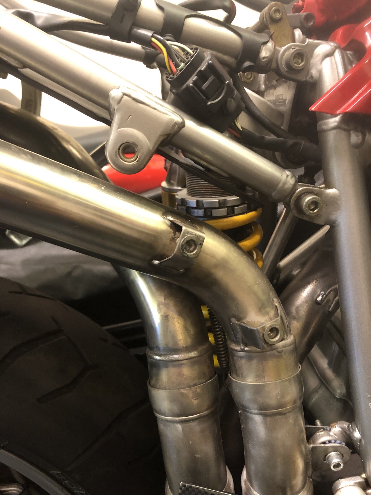

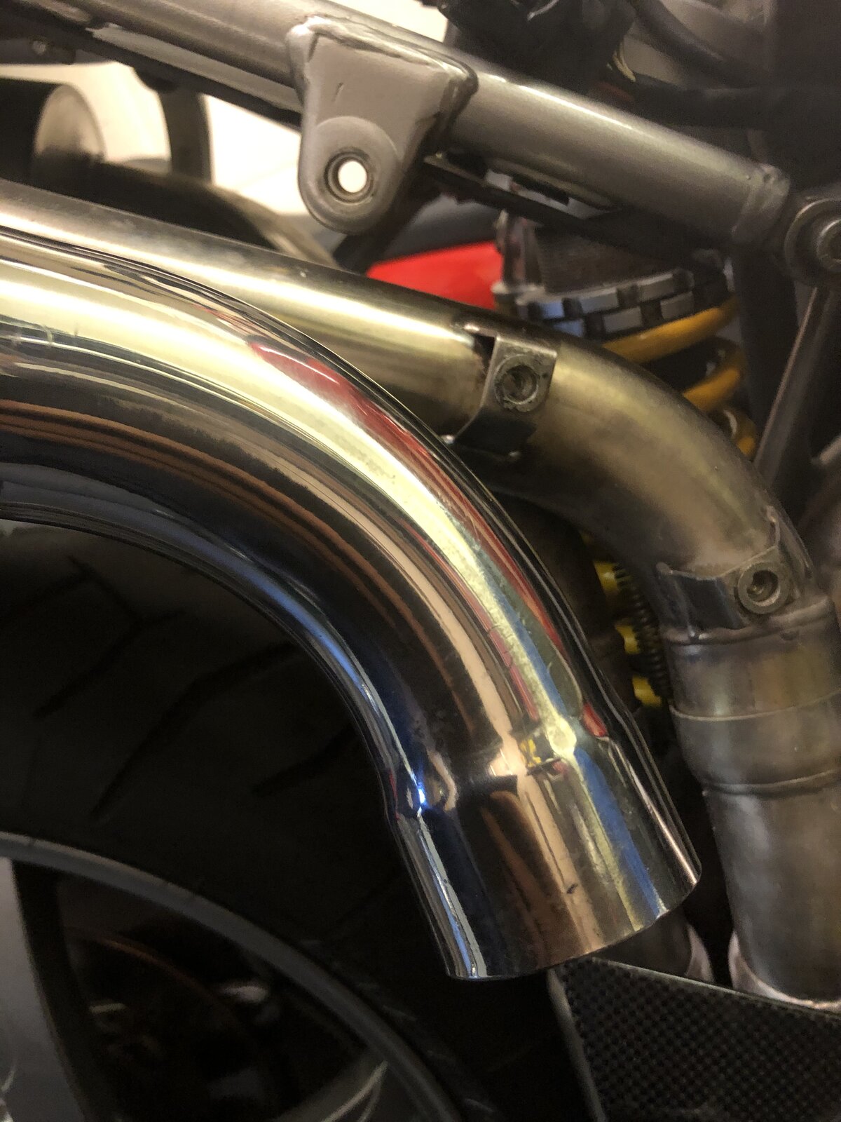

  1. I’m swapping my std silencers for some Termignoni carbons but there aren’t any brackets for the heat shield.
    Any ideas how I can make heat shield fit without brackets?

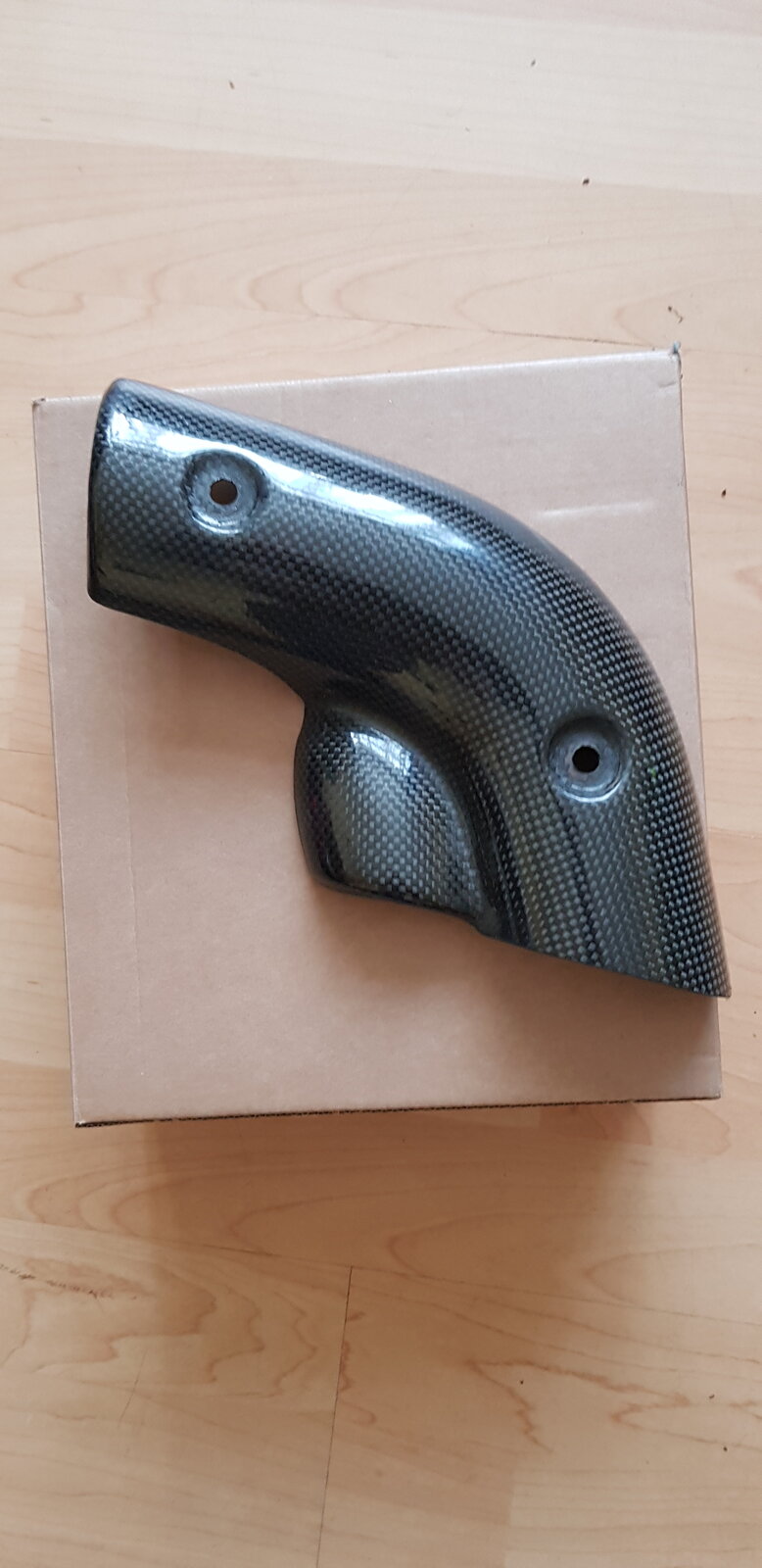

  6. Those are the heat shield mounts on the pipe. You need a different heat shield. Andy
  7. Which heat shield do I need Andy?

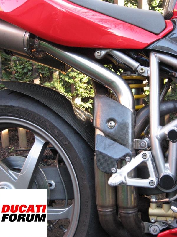

  8. I'll see if I can dig one out and take a photo. Andy
  9. Cheers:upyeah:
  10. Here you go.
    Don't know the part number but I'm pretty sure this goes with 50mm carbon end cans for the 748 and 996. Andy
  11. you can get that carbon heat shield in both shapes..hence post 5.
  12. I have been riding a 748 without that heat shield for nearly 13 years, you don't need it. Just need the heel plate and the heat shield that sits behind it. I think it was not a standard fitting on 748s and 996s or at least on the later versions of those bikes.

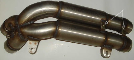

  15. Bob, 2 x M6x1 'special screws' which fit through some spacers with heat resistant washers into the bosses welded to the upper part of the standard collector
  16. and back to post 2..
