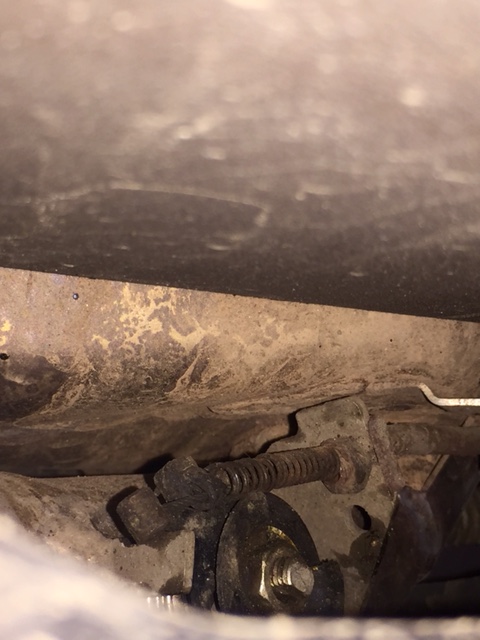

  13. here's a pic! It was raining today so there is a lot of crap, it's usually cleaner :)
    The 'now rusted!' spring I rolled around the cable simulates the servo spring pulling the cable back in position.
    The ECU only needs to feel a little force on the cable in order to avoid the errors.
    Hope it makes sense!

  14. OK, this is interesting. I get a very occasional (it has happened maybe 4-5 times) EXVL error which always goes away if I recycle the ignition. I have taken the panel off and checked the valve, which is perfectly free, BUT there is a little bit of slack on the cable. Could this lack of "force on the cable" be triggering the error ?
  15. if you see the pic above, there is a little bit of slack, but never had any error.
