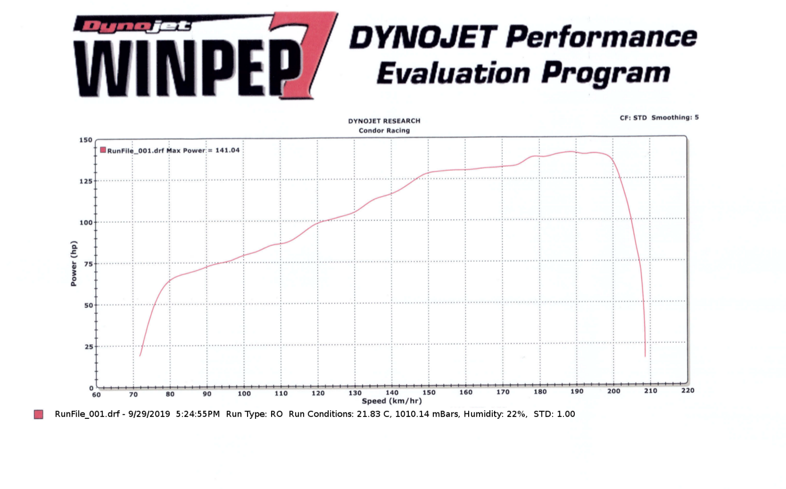

    I bought a DUC-EE just for kicks and am looking forward to putting my 1260 on the dyno for the second time for a full evaluation. Last year's dyno pass was for charity and not too detailed.
