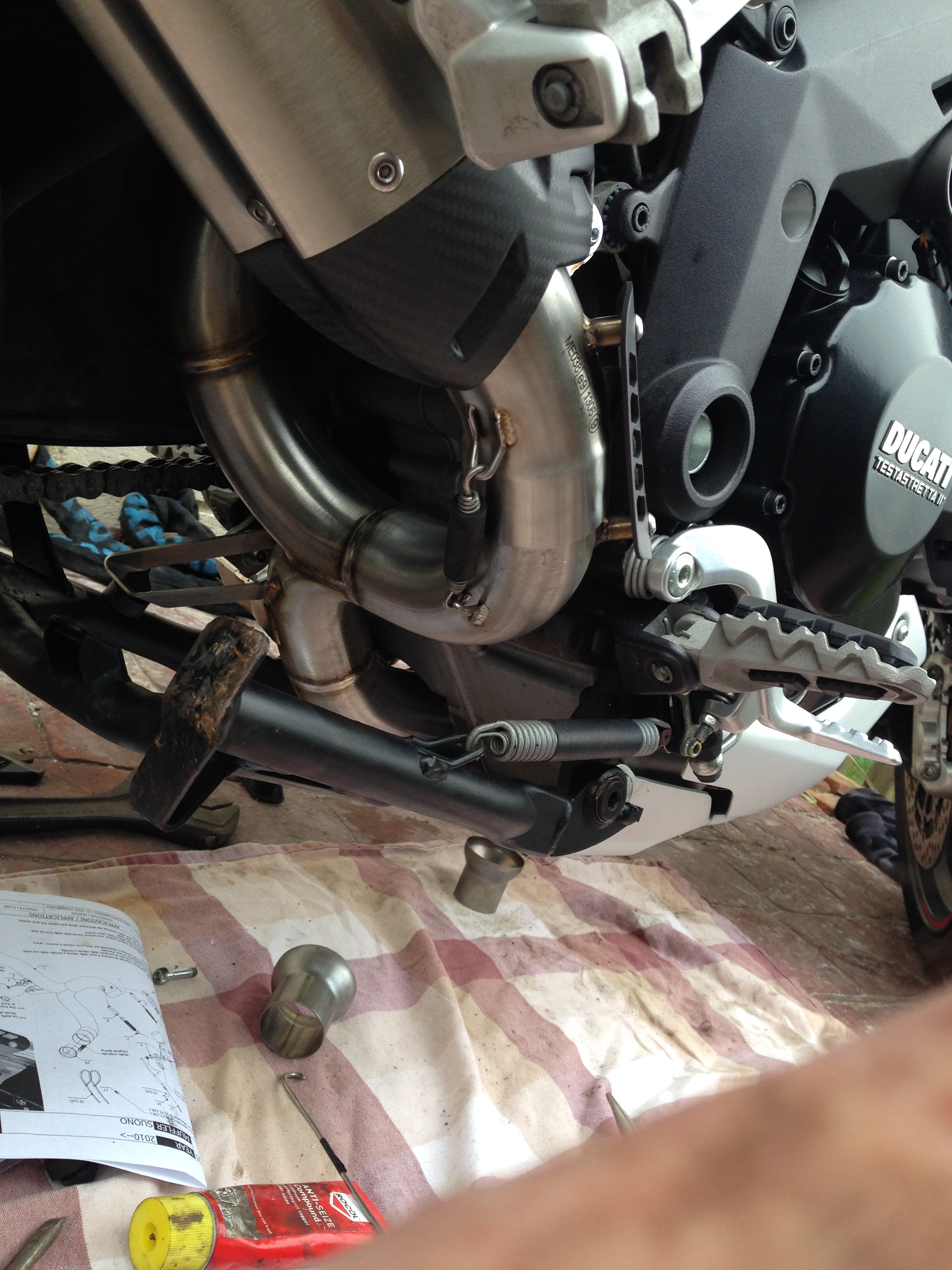

    These from one report I've read seem to take the sound down a couple of dB without choking off the engine which seemed to run better. I have now ordered these but will be a long wait while Italy is closed.

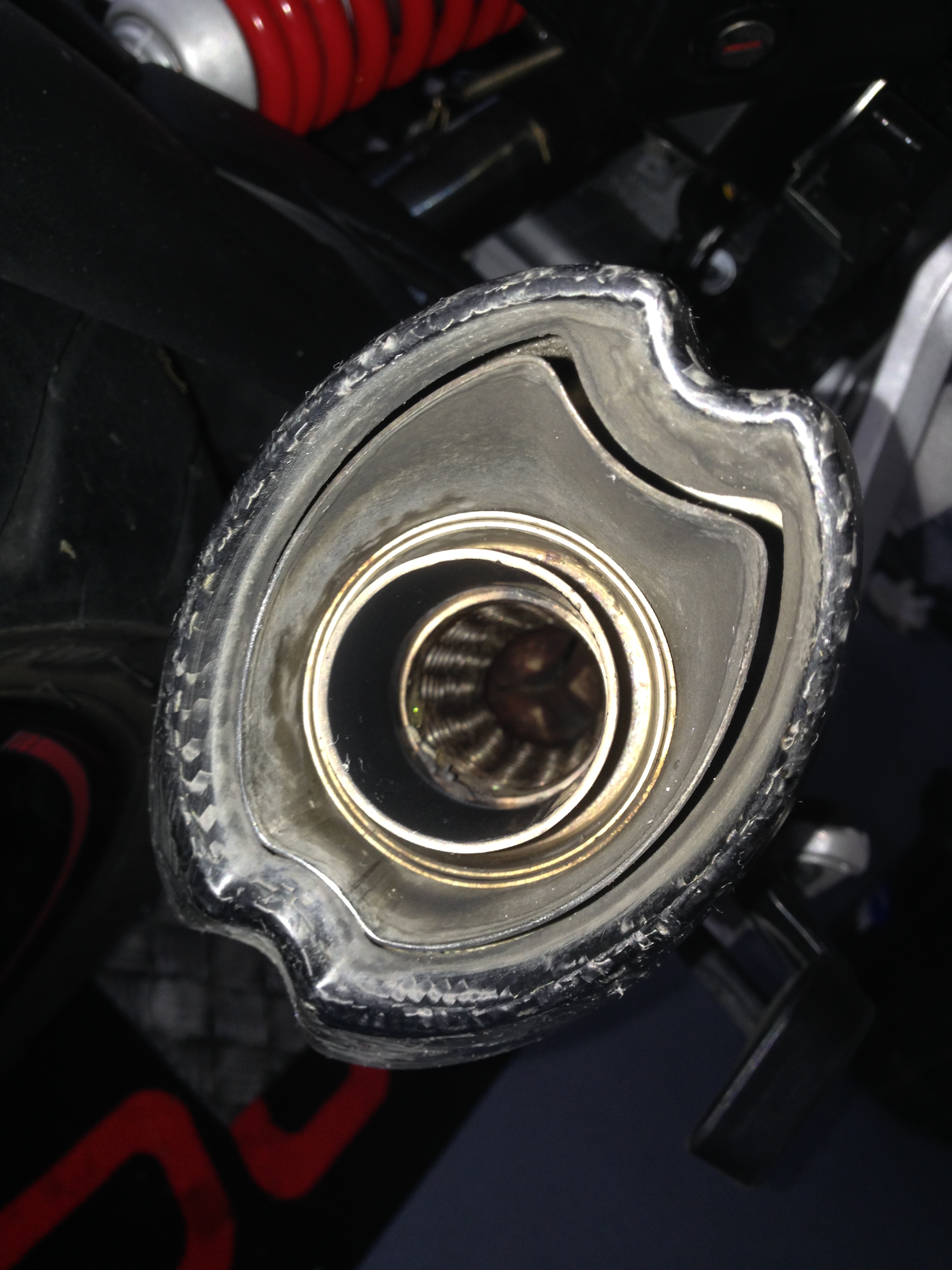

  2. Can I ask for a little more detail? Where in a Mivv Suono system are these baffles? Mine ate all but one of it's rivets at the engine end and blew apart this year after 30k miles of use so I am having a good look inside before reassembling it and it's pretty much empty; just a perforated tube wrapped in glass cloth and wool. I don't have any parts that look like those in your pictures. Where are you getting Mivv parts from?
  3. I had the same problem with my mivv so I made a baffle out of some 34" stainless pipe, I drilled loads of holes in it, took the end pipe out of my baffle and tacked the pipe to it then refitted it. It sounds deeper now and not so ear splittingly sharp. I'm happy with it I didn't notice any drop in performance. (see pic)
    I also got some of those "baffles" with my exhaust but the didn't seam to make much difference so I took them out. If I can find them your welcome to them but there crap (see bottom of pic)
    if I can find them your welcome to them for the price of postage.
  4. That's not what it looks like inside my Suono! Mine outlet is a smooth plain tube that is half the length of the silencer and you can see straight through it. I'll take some pictures too, it may be that there's more than one configuration. I bought mine in April 2011.
  5. Longwayhome - I believe they may have changed the Suono "silencer" when they incorporated the dB killers. Mine new one is also straight through when viewed before fitting. If you look at jcmental's lower photo you can see the two new baffles and the instruction booklet shows them in the diagram.
    jcmental - I see them lying below the bike, did you fit them? Also could you do me a favour and post the instrucion page showing their fitment. How does your engine run at <4,000rpm? Cheers.
  6. They didn't make any difference if you ask me, I didn't think the sound changed much at all so I took them out. no difference to the power delivery with them in or out that I noticed, although it felt much more free than the standard exhaust on acceleration.
