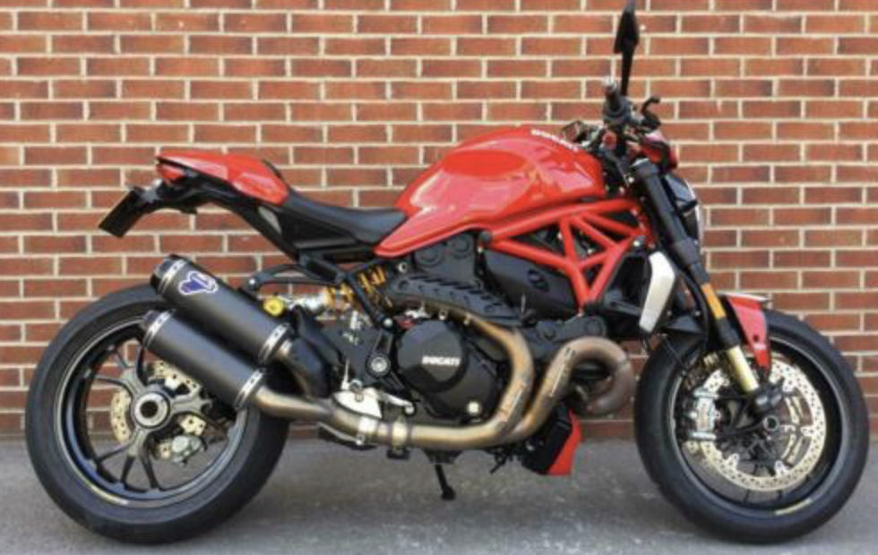

Are there any advantages to having an individual pipe per cylinder? Two strokes have a pipe and expansion chamber for each cylinder but would there be any advantage to do the same on a 4 stroke Take this 1200R, does the pipe join into one before the cans for a reason
I have those pipes on my monster, I imagine the main reason for going 2 into one into 2 is to keep the routing compact and only require one exhaust flapper valve, it’s also got more to do with fashion than anything else. Expansion chambers are not required on 4 strokes Would there be an advantage in having a 2 into 2 exhaust?, probably not for road use , it would likely be bulkier/heavier and most modern exhaust systems are well designed to achieve the required flow and back pressure, of course small gains can be made by using systems that are performance orientated but usually there’s a pay off, more noise, less torque, flat spots that sort of thing, I tend to think that most bikes now have so much power that trying to get another few bhp is a bit pointless unless your racing, especially when you consider the cost, the above silencers are the best part of 1k, I bought the bike with them already fitted, they’ve probably saved a bit of weight over the standard set up but have they added 1k’s worth of performance, I don’t think so!.
