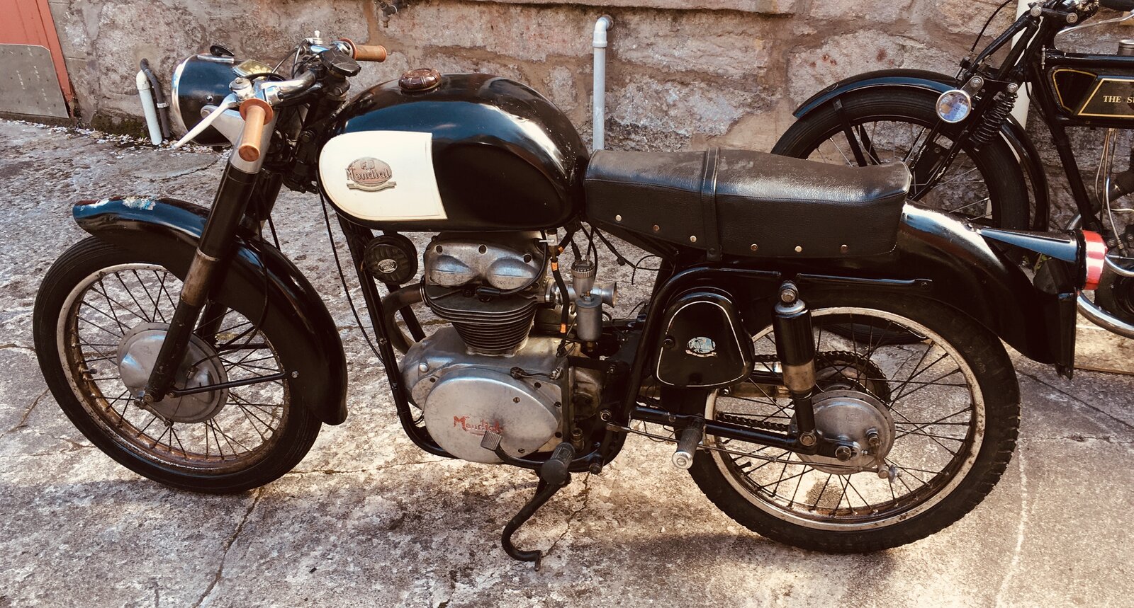

    So far it hasn't run yet, because I am storing it at his place (my garage is too full!), I also discovered that while it was cosmetically concourse, it had been restored, but had never been run. There was no oil in the forks or the engine, some of the wiring was missing from inside the headlamp shell, and there was no inner speedo cable, plus a list of quite a few odds and sods to get it ready for the road. Apologies for no bins in the background... Mondial left.jpg Mondial right.jpg

  4. Yup, I would have loved to see the museum too. I've never been to that part of Italy. My mate's Gilera looked to be in similar condition to my Mondial, but, after we added oil to the engine and the forks, and charged up the battery, it only started second kick!
    I wish that mine had been so simple, however, approaching something like this, with no workshop manual, and only your own eyeball to tell you what to do, its all a voyage of discovery.

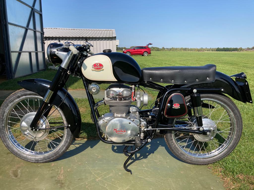

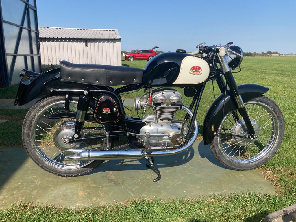

    It has needed a pair of new tyres, as the old Pirellis were perished, the battery was dry, but after adding new acid, and a couple of Bat Aid tabs to each cell it held a charge. The oil filler had a dipstick, so at least I know that the oil level is OK. Wierdly the engine isn't a DOHC like it looks, but it has pushrods with enclosed hairpin valve springs. The crank case is one piece, not vertically or horizontally split in two like you might expect. The engine and gearbox are unit construction and gear driven, and the crank and gearbox shafts sit in bearings on the right side of the bike, in the crank case, but are retained in a bearing plate on the left, behind the separate flywheel. So all a bit of an odd configuration.

    It would seem that there are a few different iterations of the Mondial basic design. In the late 40s and early 50s they were primarily a manufacturer of DOHC 125 and DOHC and SOHC racing machines which won them considerable success. The bottom ends are pretty similar except for the cam drive arrangements. There were 3 styles of 200cc bike, the sport, which had a whopping 7:1 compression ratio (compared to my 6:1) the normal, and the Extra Lusso. There was a normal Lusso too, but that was only a 125, with the same colours.
    The bike that I really wanted was the previous lot to mine, which was a 175cc Monoalbero racer, which had an estimate the same as my bike, but was bid on rather feverishly, and ended up over £20,000!
    I have some issues to overcome. The fuel tank cap is made from Bakelite, and has split, but repro ones are available from the register. I think that I will order a gasket set also, as you never know when you might be having a look inside the engine. I have bought a universal speedo inner repair kit, so hopefully that will have enough bits in it to make a working cable. One of the rear chain adjusters broke when I was taking the rear wheel out, but it seems to be soft soldered together, so I can re do that, and hopefully, with careful treatment will be OK.
    The ignition is by coil, and weirdly has a manual advance and retard. Max advance is 41°!! The mechanical voltage regulator lives in a small recess under the fuel tank. There is no stop light fitted, but that job is on the list too.
