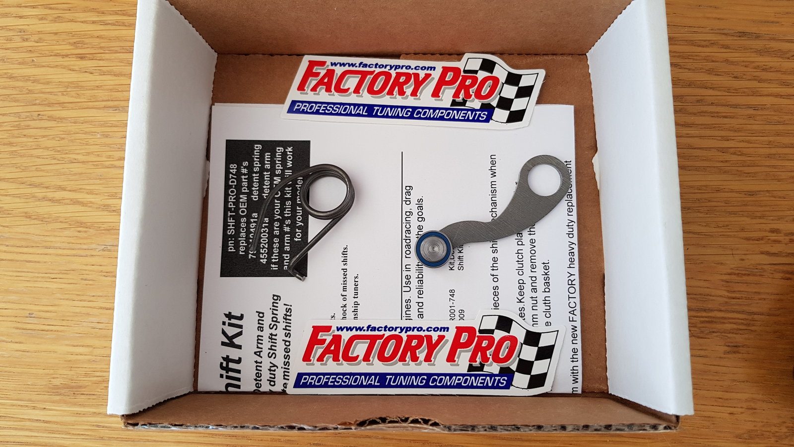

  1. As above....I get the odd false neutral between gears now and again on mine....doesn't really bother me but after searching around on the net last night apparently this is one option (the other being a crankcase split) so I thought I'd try this....
    https://motowheels.com/i-11779860-factory-pro-hybrid-ceramic-shift-kit-ducati.html
    It'll tie in with next time I service the clutch. I'll put up another thread on the install....anyone else done this mod?

  9. So "big Chris", the mechanic tells me at Louigi motos, it can be fixed totally but its a crankcase split to do that, so i expect this not to totally sort the problem ( i think 5th going into 6th ) has been a long standing issue with that particular gearbox type (all 3 of my hypers have done it) but if anything it "should" hopefully smooth it out a bit....as i say, ive never really had an issue or problem with it but, if i can improve the feel of the gearbox overall, why not? and, ive gotta take the clutch out to clean and service it so its not that much further in to get to that part....
    And, although im not wishing it to happen. When, and if, (and i hope not) something happens that needs to have the motor pulled out ill get it done then...

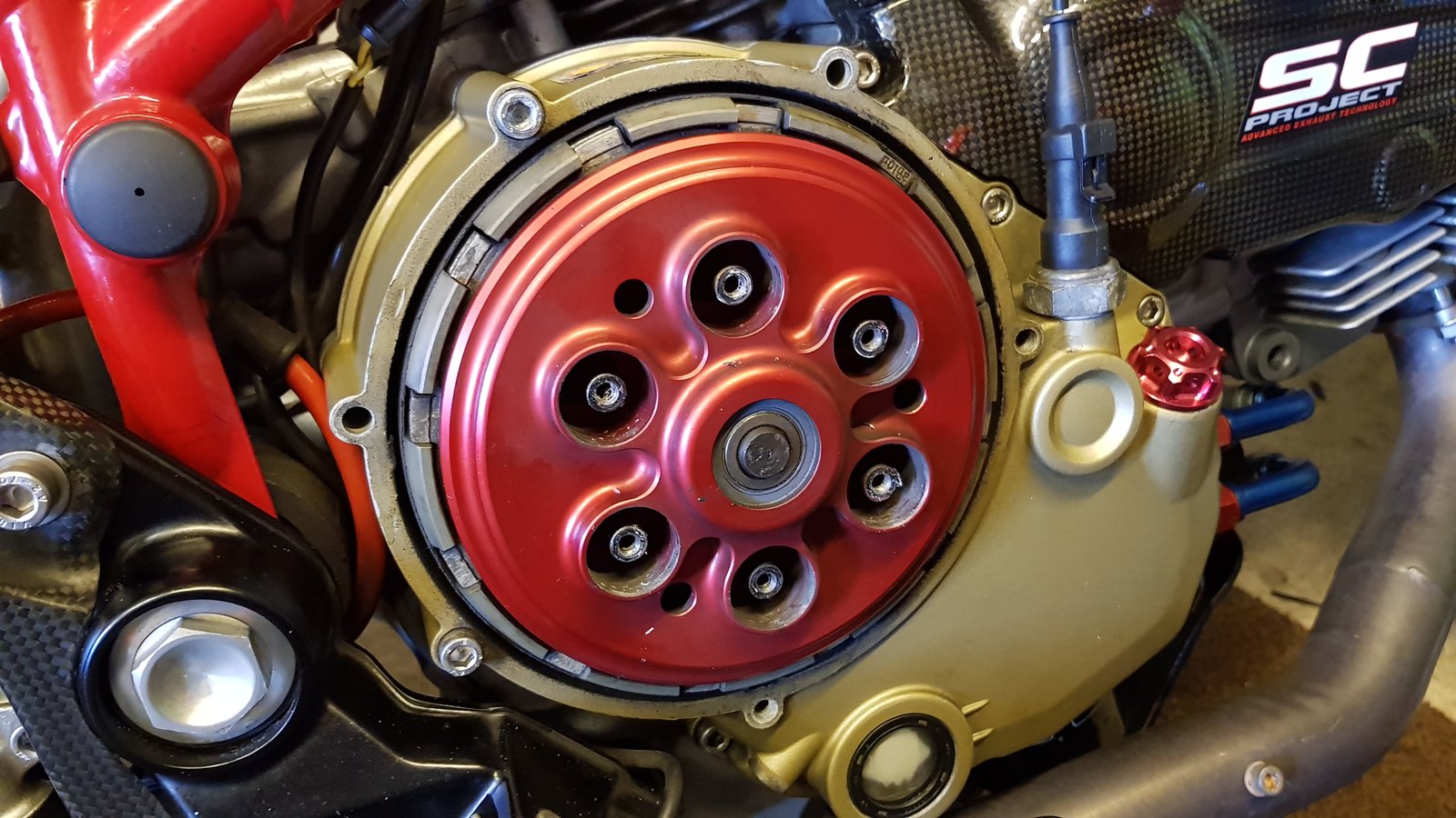

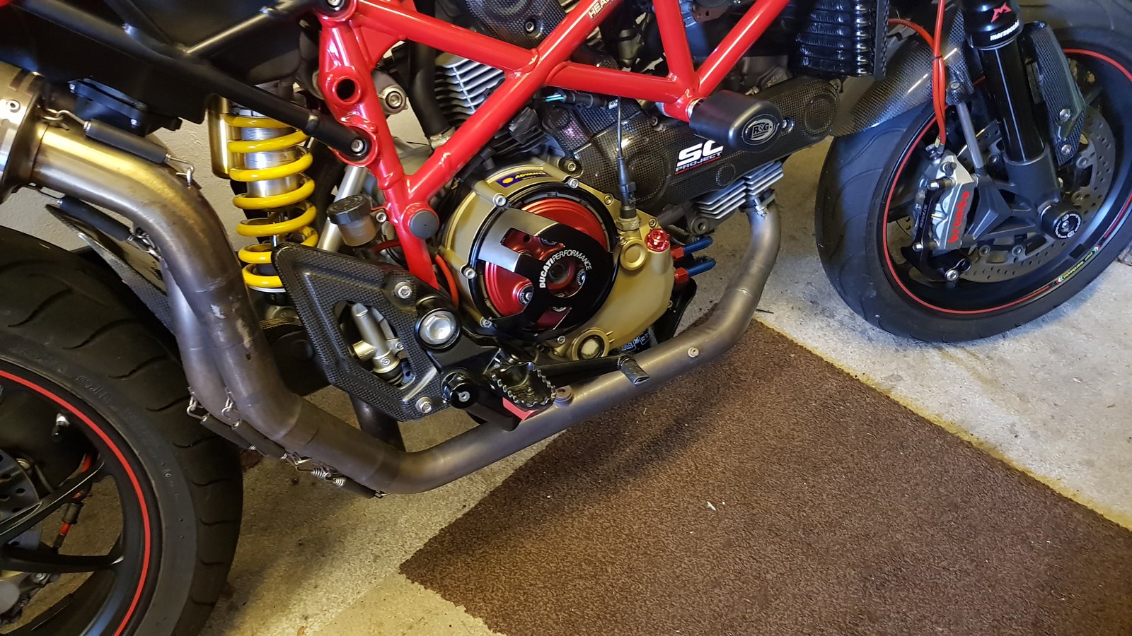

  16. Ok...all installed. Was in the garage most of the day...so not a chance to test yet...Will test tomorrow. Loads of pics but they're all on my phone so will take a little while to post...plus I'm getting whipped by the kids at cards at the moment...
  17. Me too. :) :upyeah:
  18. Thanks for the help today Rob. I couldn't shift it no matter what so I had to get it going by sliding a very small thin bladed screwdriver on one side just behind one of the bolt holes but one of the high ones...it's sealed up fine though...

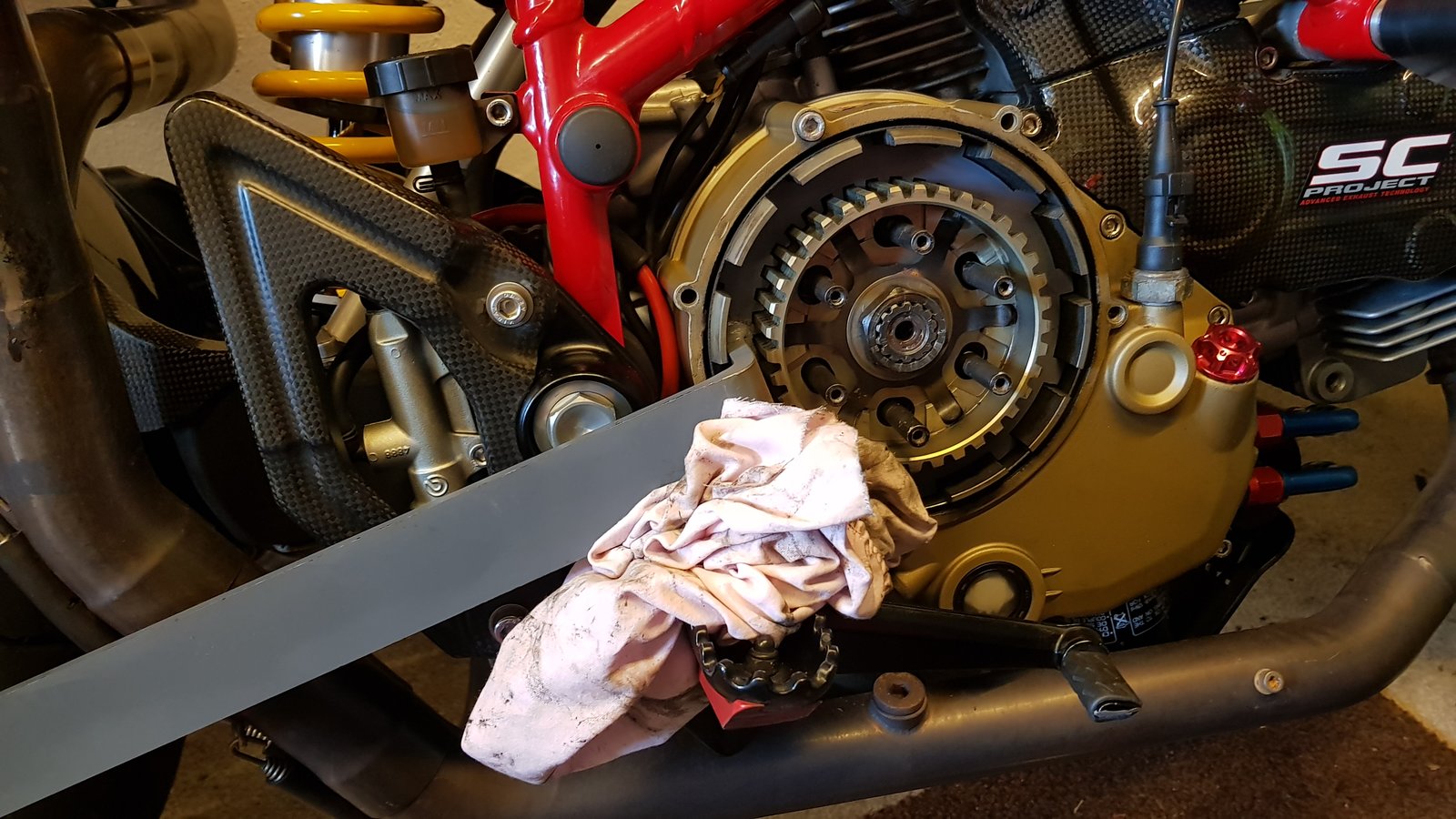

  19. Ok...ill break it up a bit...but here we go....done the lot just in case anyone wants to this...strip down...

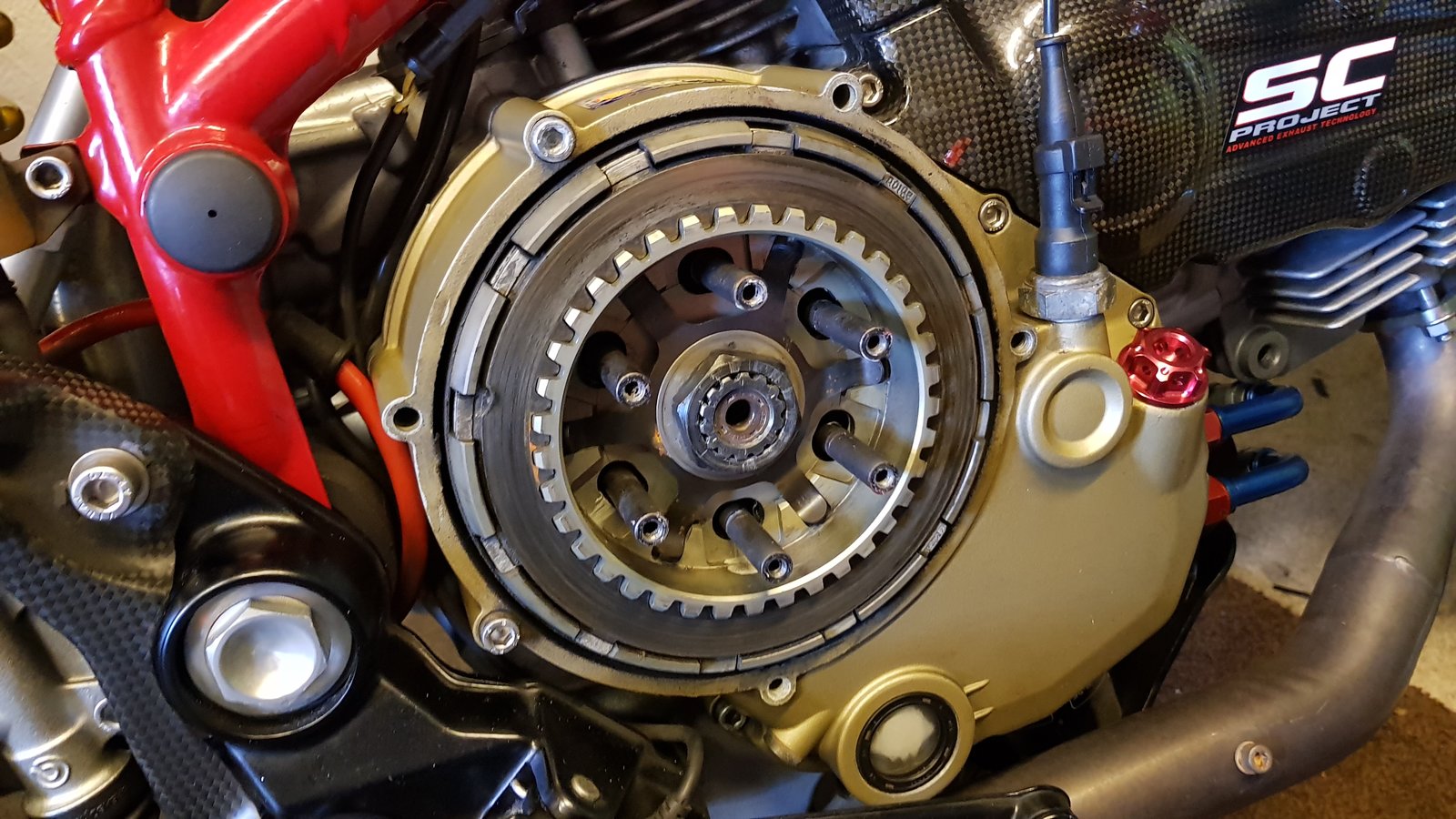

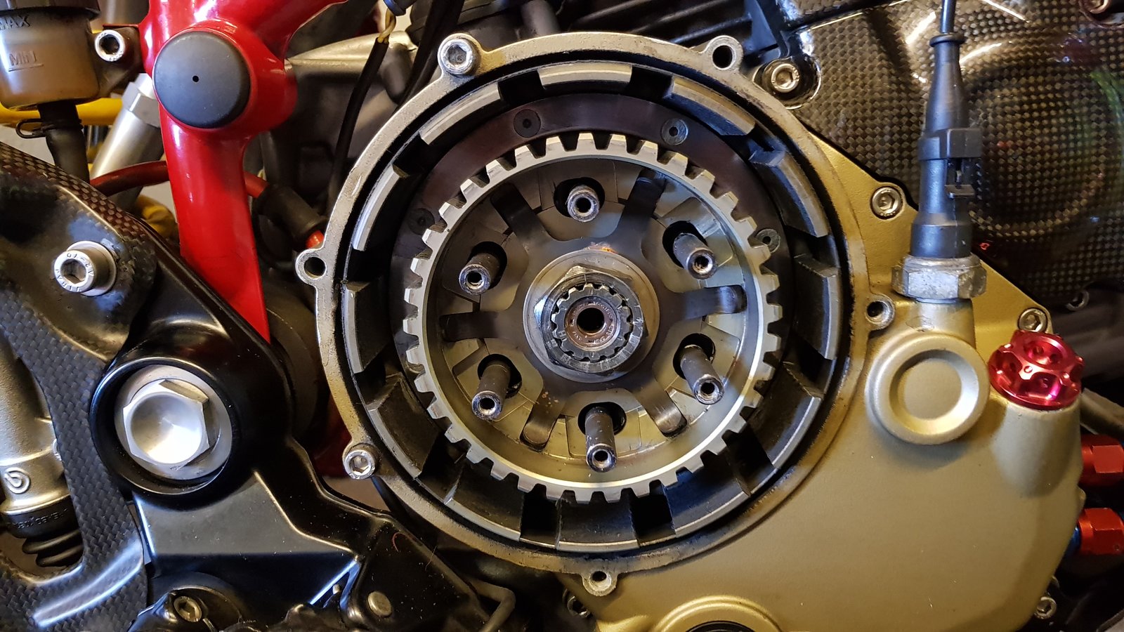

    Clutch guard off then pressure plate..
    20171228_110818.jpg 20171228_110850.jpg remove stack keeping the plates in order..
    20171228_112000.jpg At this point the holding tool is used..

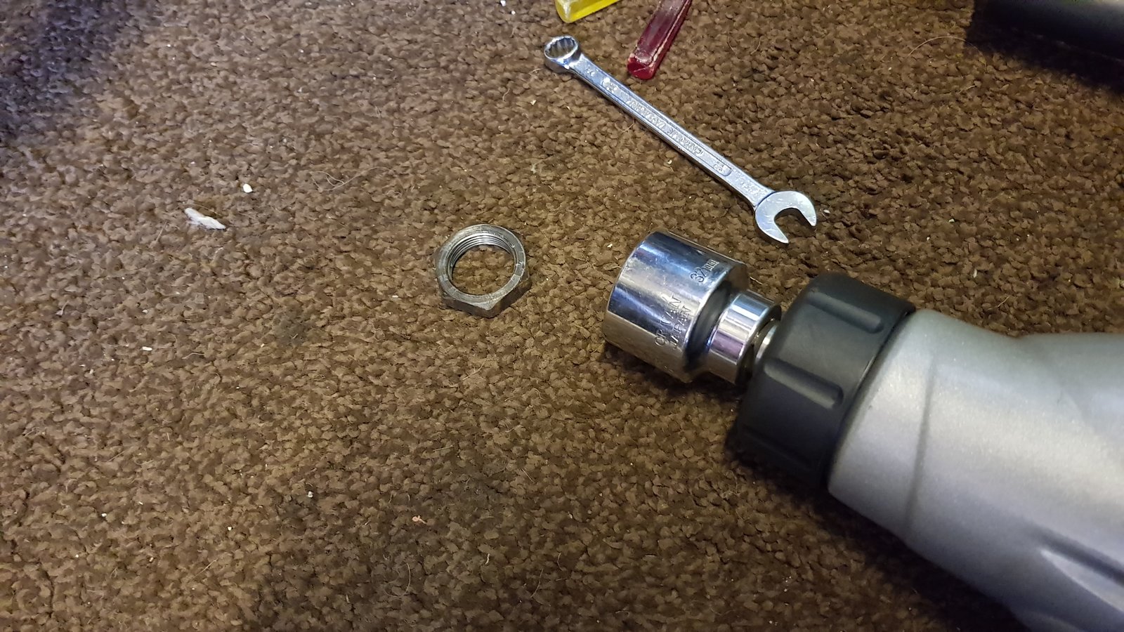

    20171228_112221.jpg then remove the central nut with a rattle gun..

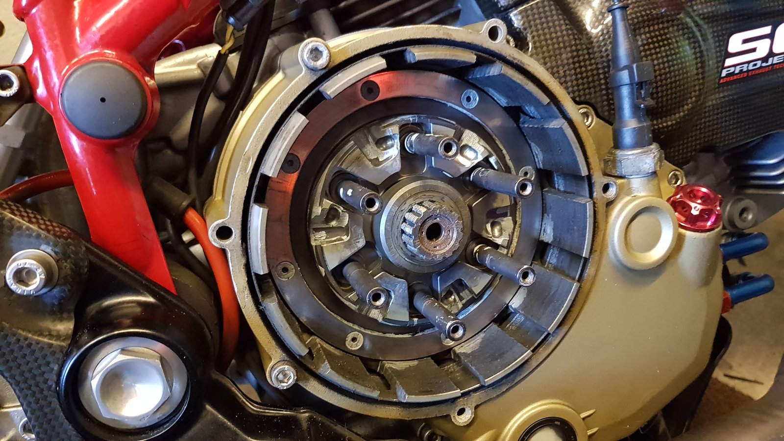

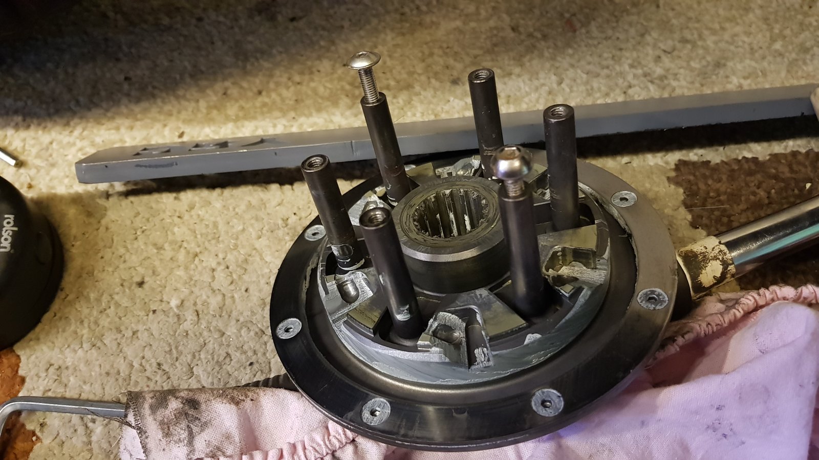

  20. Ok...where were we...next..central part of the clutch out...mines a slipper jobbie so it's gonna be a bit different to a normal clutch, but, just lay the parts out in order... 20171228_112550.jpg

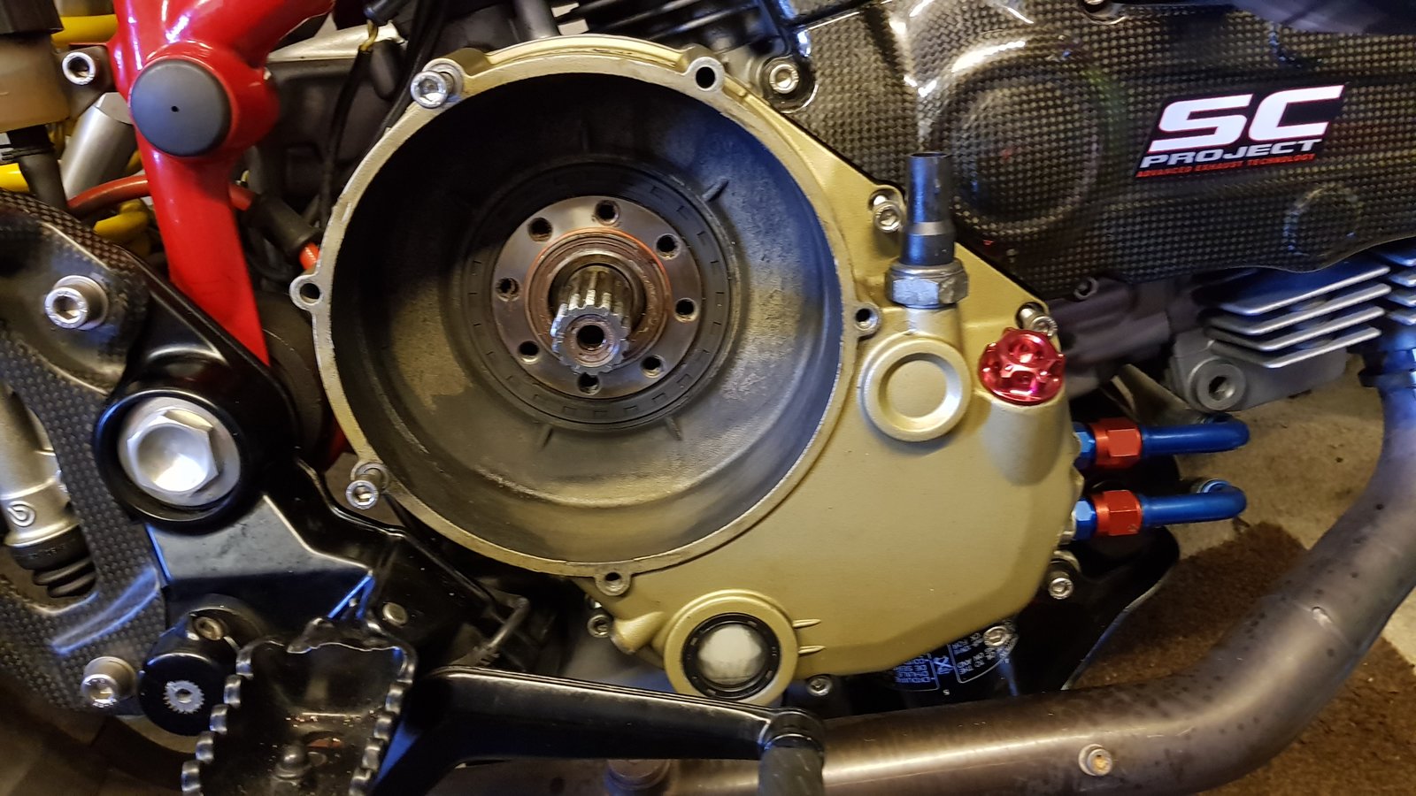

    I put a couple of old bolt in so I could grab them with a couple of pairs of pliers...
    Quick tug and it's out...so at this point there's just the outer drum left...undo the ring of bolts ( red threadlock to reassemble )

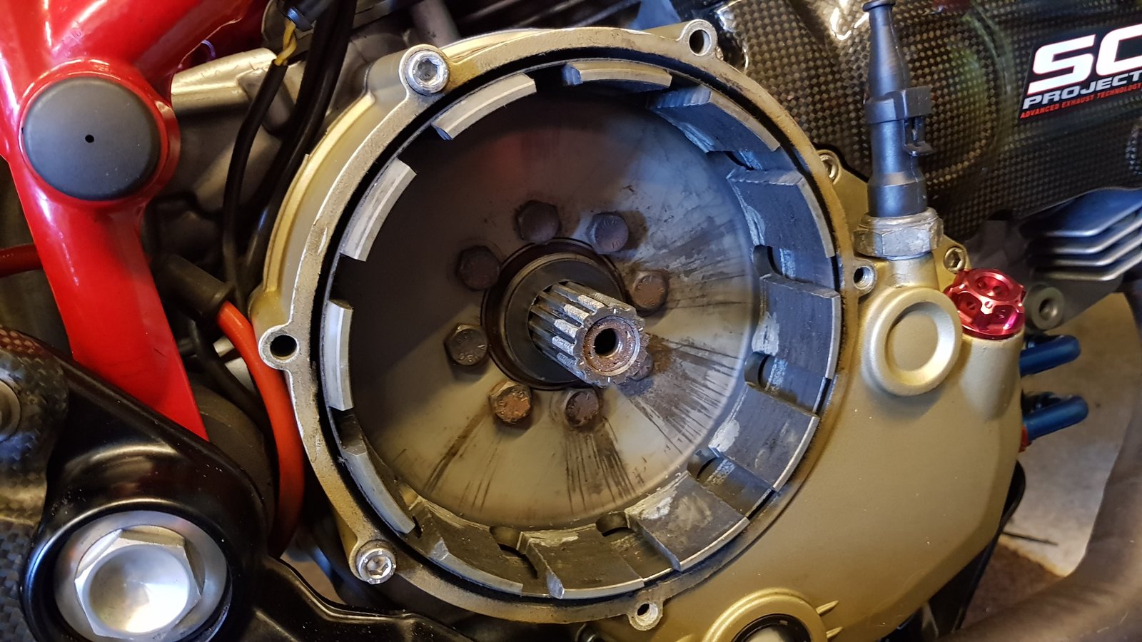

    At this point I put a blunt ended screwdriver on the end of one of the outer clutch "blades" tapped with a rubber mallet to rotate it in the housing and came loose easily...

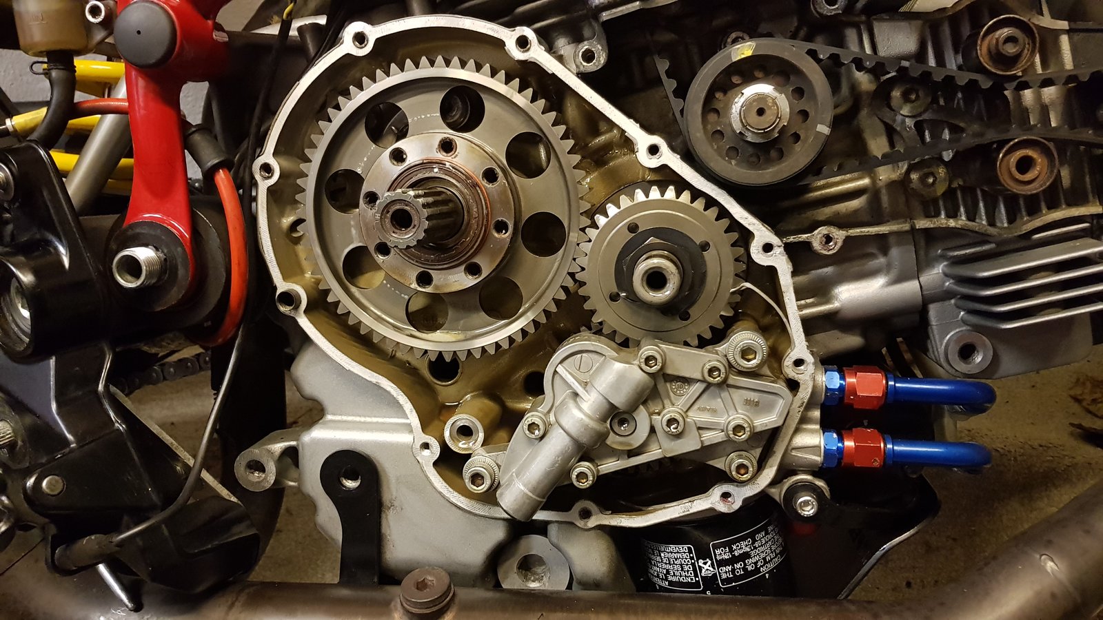

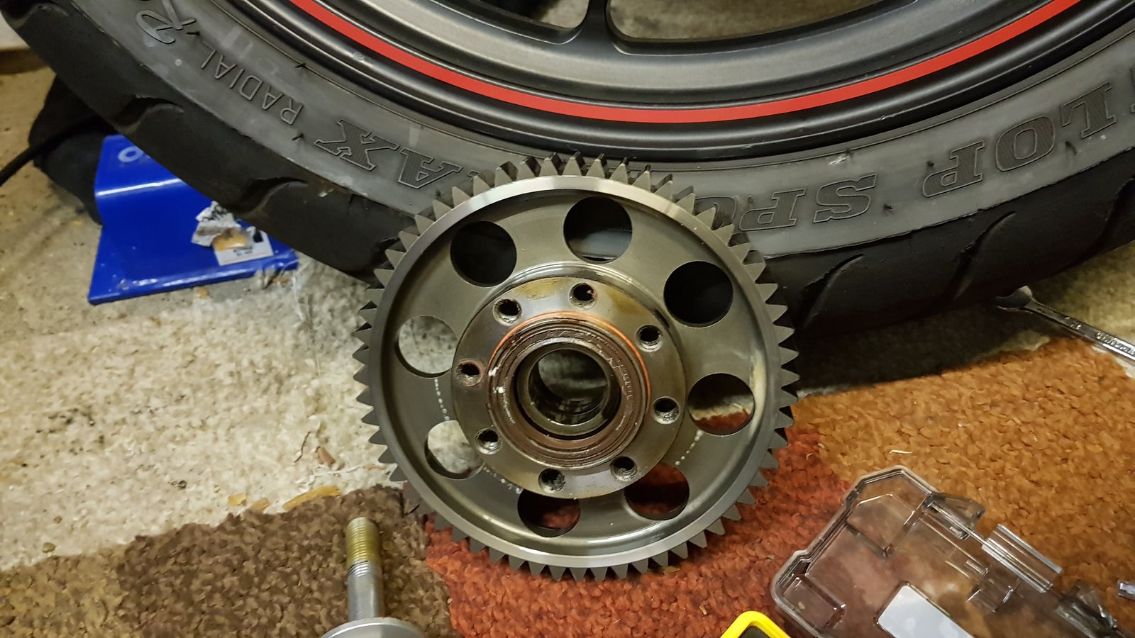

    At this point the cover was well and truly glued on...no matter where I knocked it with the rubber mallet it wouldn't budge, so, I used a thin narrow bladed screw driver and knocked it in just behind the bolt hole just next to and above the oil filler cap. Just a couple of mm movement made it come loose so we can then see the exposed part of the engine and then in turn the part we need to get to...
    Slide this out...
