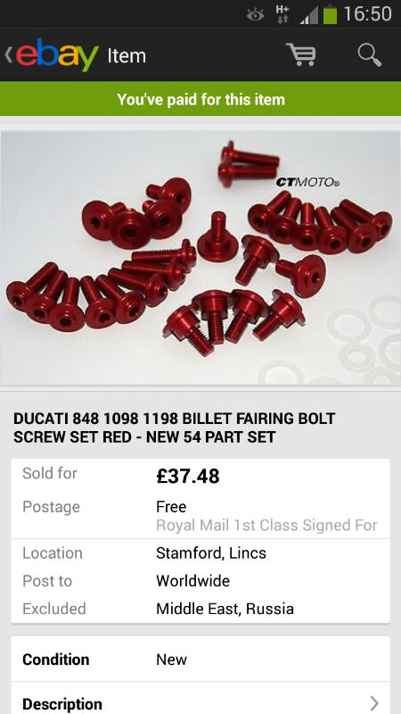

  7. went for these in the end. see how it goes...

  8. How did these go, I'm looking for a set for my 848 in black
  9. That was a long time ago, mate. :)
    The fit was good but regretted getting them in red as they stood out too much. I painted them black in the end.

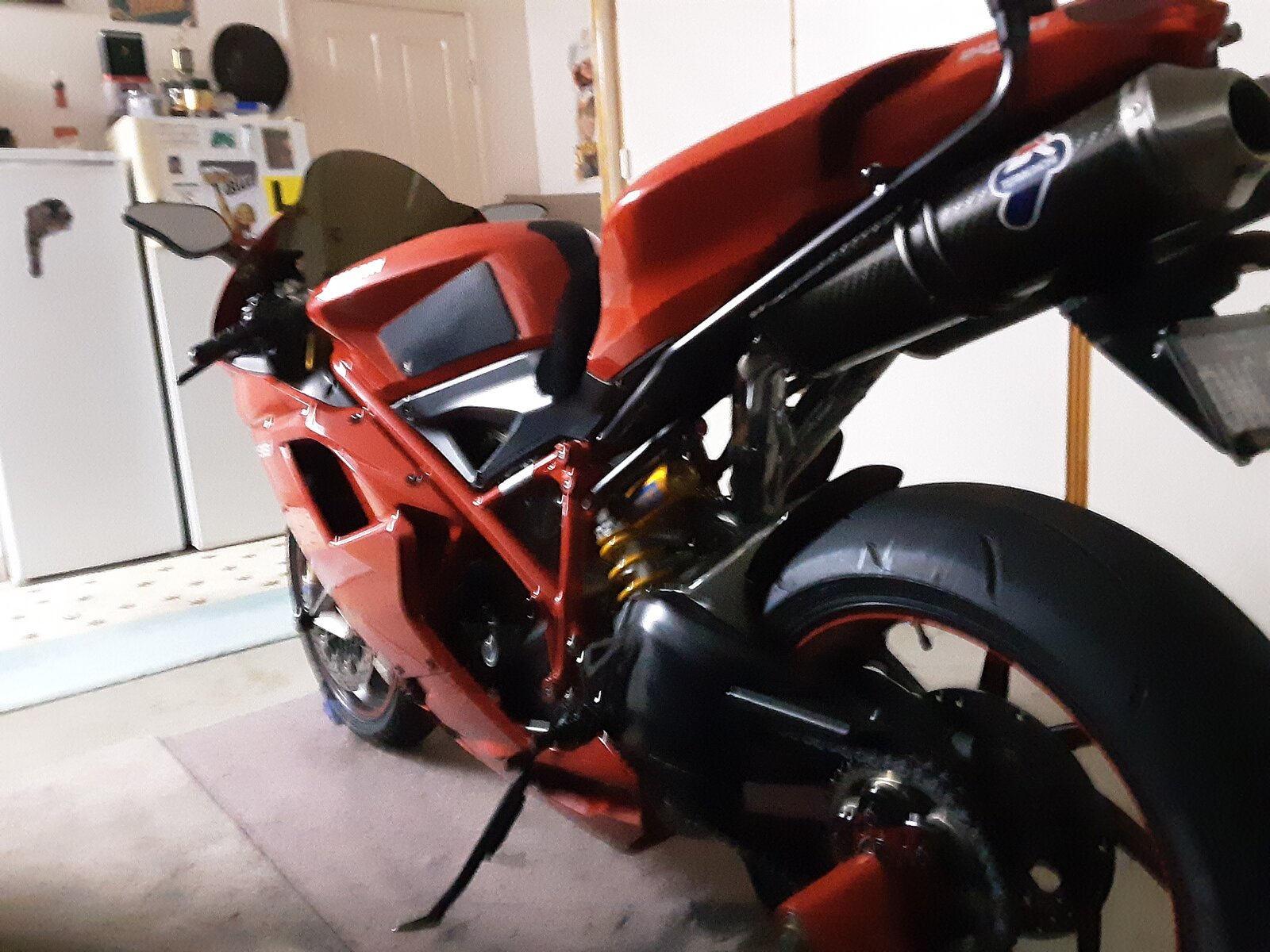

  14. I also converted my 1198s to Dzus fasteners in stainless black from Probolt.
    Looks good and a lot quicker to get fairing panels off and on. 20200926_181927.jpg
