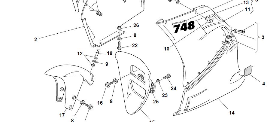

    The side fairings are ready to go back on,just a few questions
    One has a foam rubber pad the other doesnt ,is that normal?
    Ive read theres a few size options on the dzus clips ,one is 1mm shorter and supposedly fits the panels more securely, which ones do i buy and finally how do the bottom edges clip together ?

  4. Genuine Ducati Dzus fasteners are different to the "standard" one that many dealers sell. If you want the total OEM look check which ones you want to fit before buying. Needless to say, buying from Ducati is an expensive way to go.
    If you still have the OEM ones then you can get them replated.
    As for the foam pad, only one panel has it which I is the nearside one. Check the parts manual and it will show the location if you are unsure.
    I think you are referring to number 4 is this screen shot.

  8. Great ,thanks for the replies
    Ive had a good rummage through the boxes and found all the backing clips,the frame mounts too
    Ive found a mixed amount of clips,some back square headed,some goldish colour with a thinner head with small raised wings and some square slotted gold ones too
    Which are the stock standard ones ,its a N reg bike,trying to get it as stock as possible
    Also lastly what bolts hold the 4 frame clips to the frame itself (the brackets hold the rear of the side fairings on)
