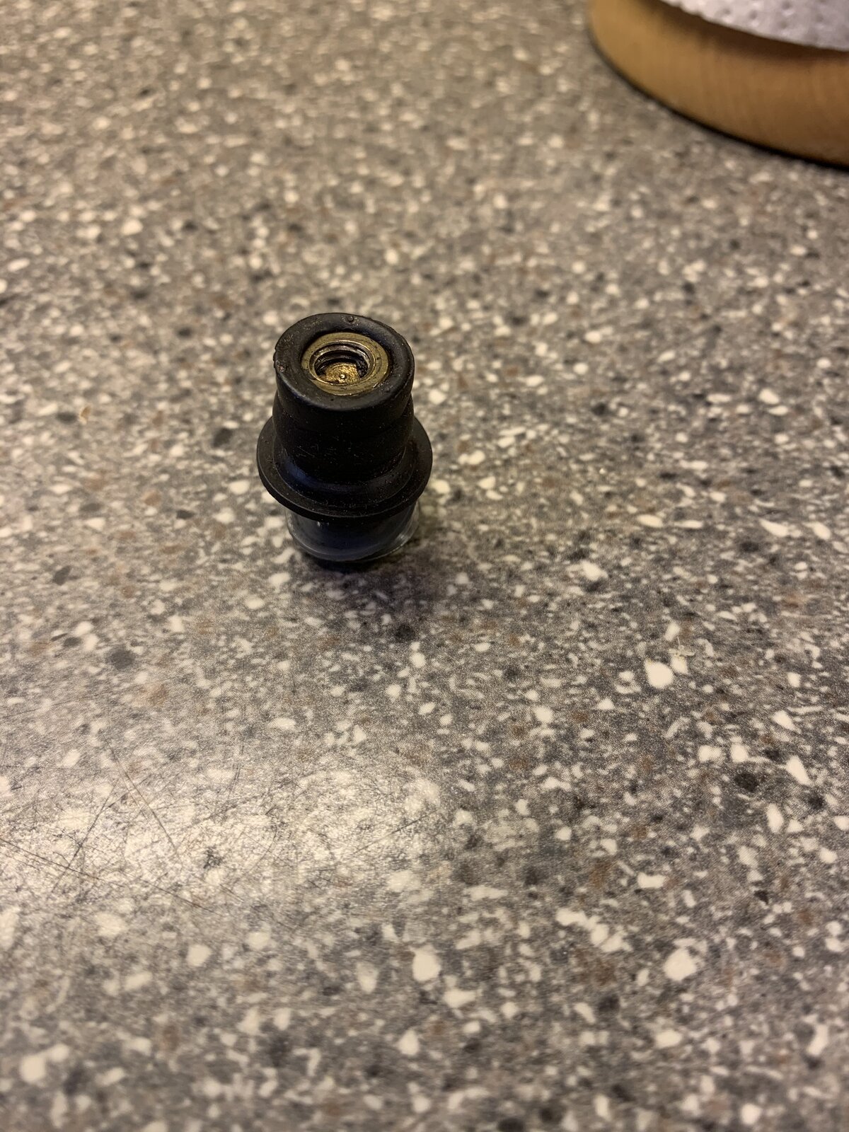

  11. Managed to strip the fairing panels off
    Sure enough all the four fixings around nose cone had been over tightened forcing the brass inserts through the rubber body.
    I’ve taken them out and super glued them back in place. See how it works.
    Seems to have bonded well!
  17. The idea of repairing them appeals more then replacing them.
    It allows me tinkering time in the garage, and who doesn’t like tinkering time?
    Plus I finally get to clean the inside of the cloudy headlight.
    More tinkering!
  18. As long as you can guarantee your workmanship....carry on fella.:upyeah:
  19. You'll find out next time it comes back from Ducati how good the bond is.
