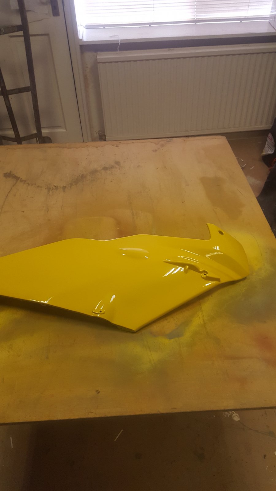

  13. Well after abit of sanding and a quick coat of spray paint and laquer (both rattlecan) here is the end result, the join is ever so slighty visable in certain light but thats because i didn't use any filler at all...my bad! If i was working on a half decent fairing i would have spent more time but this as just a trial and error sort of deal, im happy with the results and now have a spare track fairing rather than a few bits of broken plastic!

  15. nice job - is it still holding firm? (I'm a bit concerned about chemical reactions with the baking powder)
  16. @bikermike still seems solid as the rest of the fairing!
