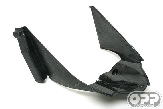

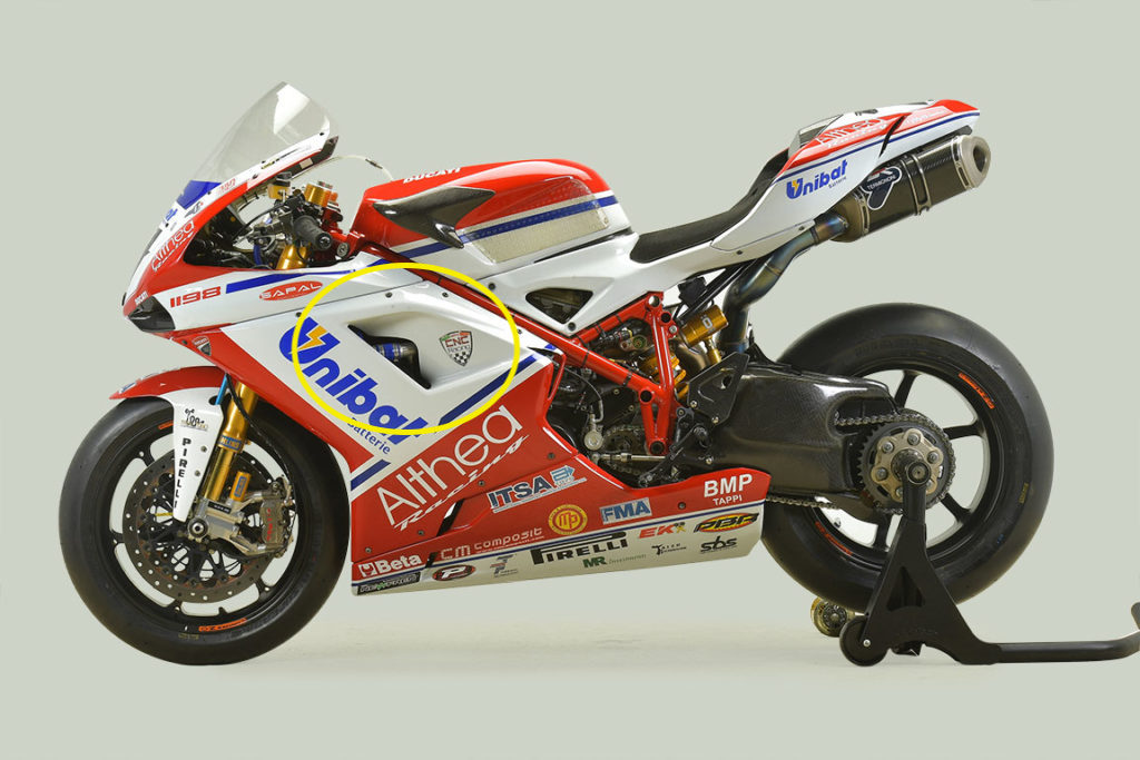

  1. I could be completely wrong, but I think the need to have the racing fairing installed is to do with the pipework routing from the radiator to the engine. The upper tubing comes out very straight and would foul the left fairing. Race fairings had a section cut away from the fairing vent.

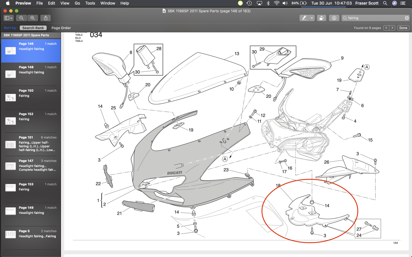

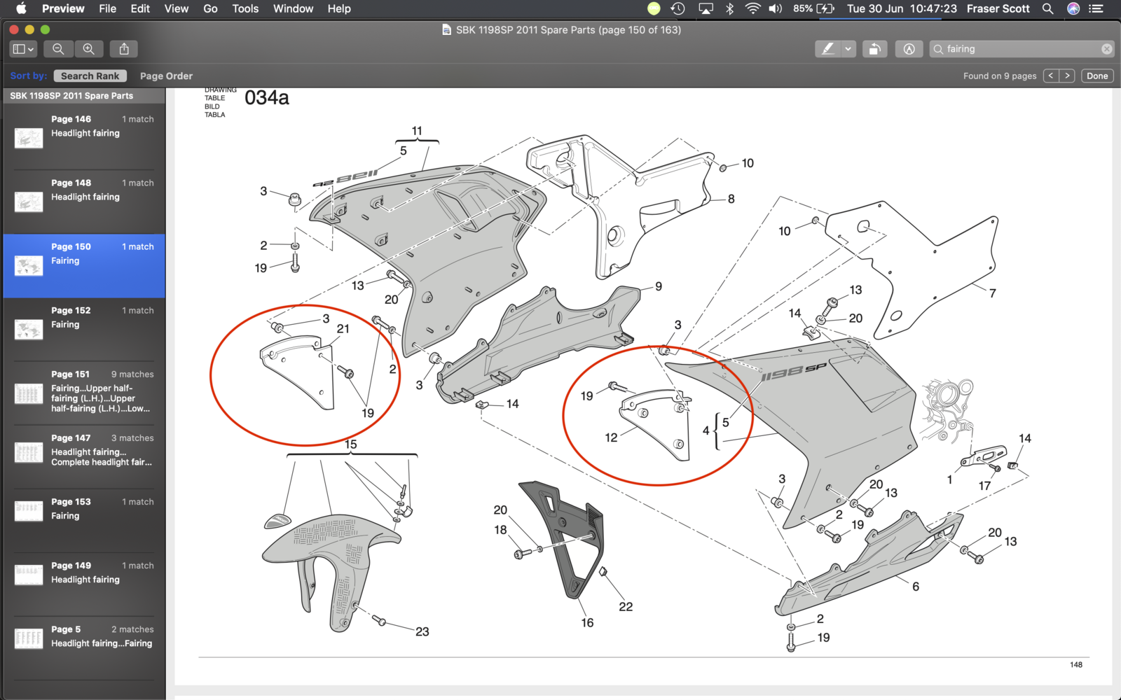

    The race fairings also have no fixing for the radiator shroud. The OEM shroud has 3 parts; a side panel fixed to each fairing and an upper part fixed to the headlight housing.

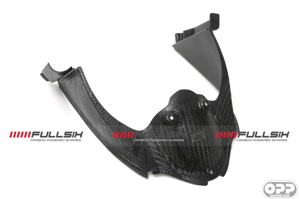

    I have the single piece race shroud and that fits to the OEM radiator and headlights. Logic therefore would suggest that the OEM shroud setup would work with the Febur system, if it is the same depth as the OEM rad. The part I have was made by Fullsix, but it doesn't look like the make them any longer - not listed on their website.

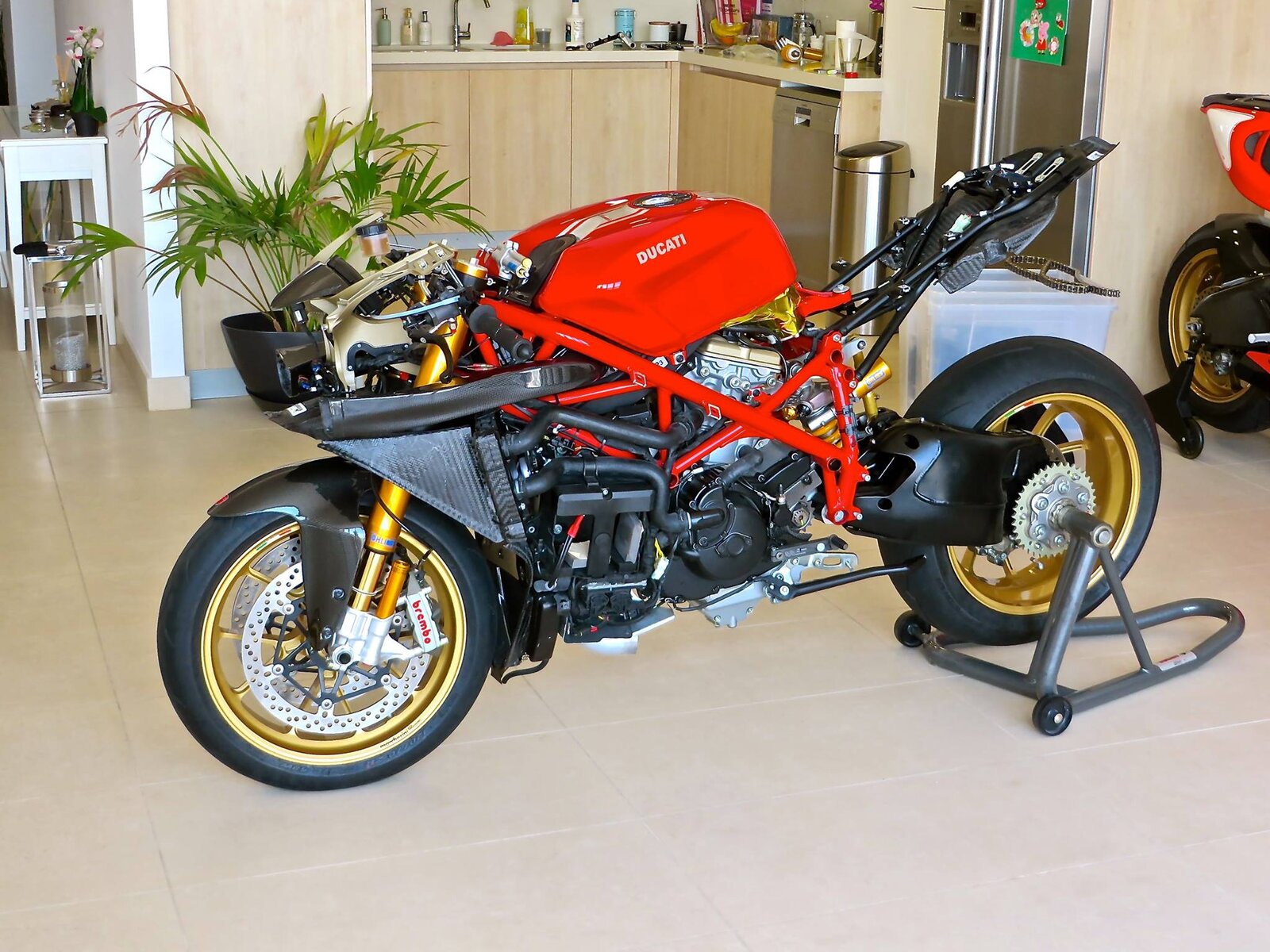

  2. I have a 1098RS radiator MB Motorsport.
    I have it fitted inside a 748 with 998 flat fairings. It touches on the left hand side.
  3. WOW!!! Your bike looks like new?? Is the engine new or what, what is the secret??
    The mean thing I have is that engine is tuned a lot and that produces a lot of heat when driving slow or at traffic lights. When standing still you see the temperature goes up very fast to 110 degrees and then the fan is kicking in. I am looking for a solution like a second fan or better cooling liquid or a bigger radiator
  4. How did you get on with the oil in the airbox issue?
  5. yes that is resolved, we have fitted a box with a labirint inter airbox and connected with the oem hose to the carter and problem is resolved, unfortunately I don’t have any pictures of it sorry
  6. Yeah, you could say I have OCD with certain things, my bikes being one area.... The SP has only covered around 5000km's, not huge by any stretch of the imagination.It's not very standard either - only the main frame, engine and gearbox are unmodified..
    Regarding your heating issue, yes these bikes get very very hot!! The Febur radiation does not have any fan mounting points and really is deigned for race use, or rather not town use. You're radiator should have twin cooling fans, at least I'm assuming it does.. which model is it based on?
  7. yeah I think I found the problem. Original there where two fans but because of the transformation to panigale electronics there wasn’t enough space for a second fan, but never say never so I gonna try to instal a second fan.
  8. Ah, do you have a Biggelaar Special?
    If you can fit a fan, great!! If Toine did your bike, maybe ask him to reprogram the ECU and have the fan cut in at a lower temp maybe?
  9. yeah it is a litle bit changed the last years haha.
    I fitted today an additional fan, now I need nice and dry weather haha
  10. ...and a RS swingarm like @Bullitt has ;)
  11. I have now two fans and it looks like the "problem" is less. The temperature will rise slower at trafic lights so i think that one is solved. Now i'am looking for a better cooling water, i have now G12++ (Pink)
