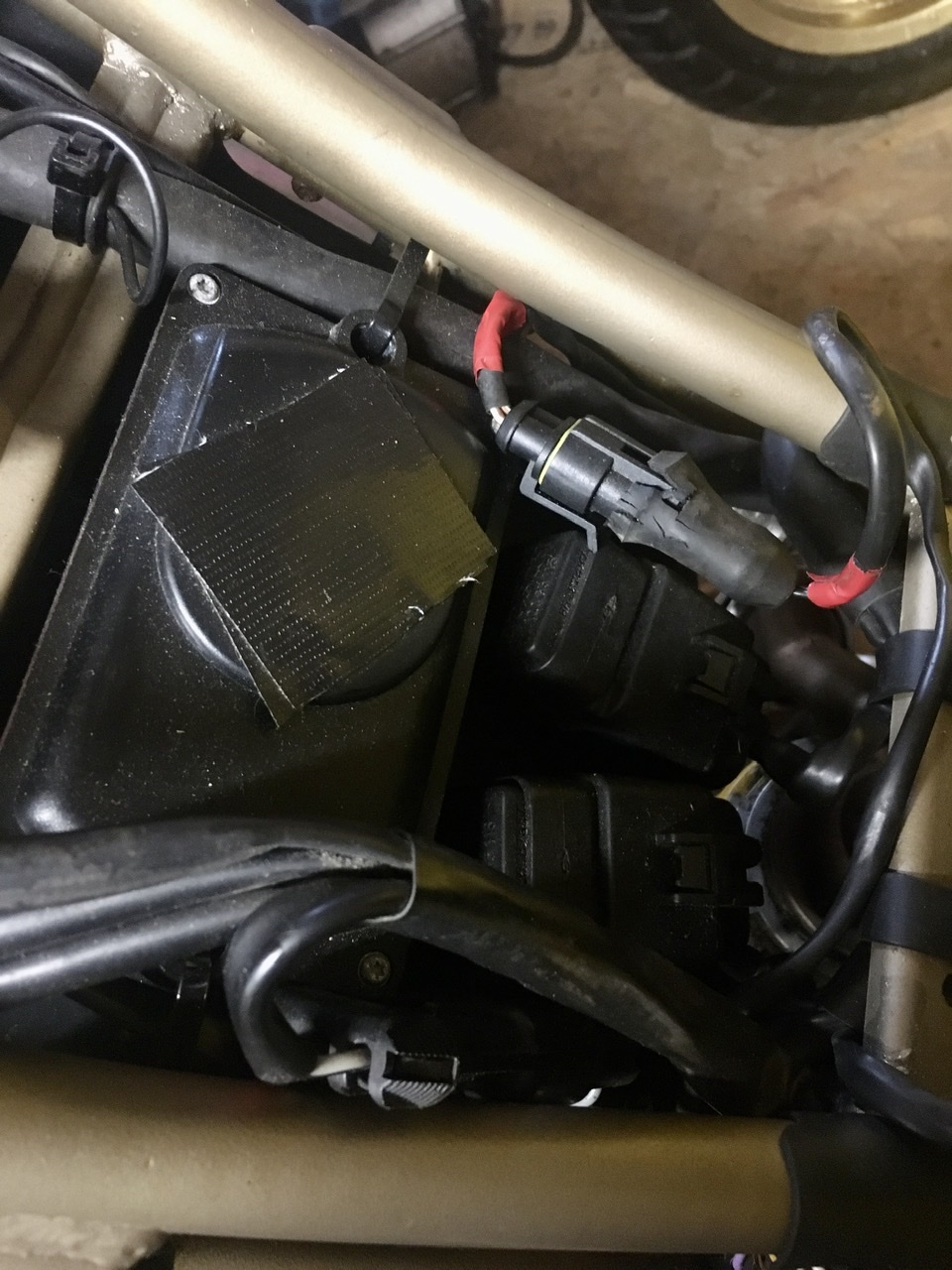

    On my 1999 748.
    The alarm is connected into the wiring loom via an ‘official’ factory connector (ignoring the feeds to the indicators) somewhere under the seat. This is a Ducati factory fitted connector there for the fitment of an alarm. You need to maintain that circuit. The photo shows the connector under the seat. The connector on the left is part of the wiring loom, the connector on the right goes back to the alarm. You need to either bridge the loom side of connector with a repurposed paperclip, or better still a purpose made superseal connector which bridges the 2 terminals inside, or as I have done, leave the alarm itself in the circuit in order to ensure the completeness of the circuit. It’s having the same affect as a bridge.
    It was really annoying when I was refurbing my 748 last year so when I put the alarm back into the bike & loom I opened it up, removed the internal battery and did not reconnect the alarm loom to the battery. Just in case a future owner, or myself, wanted to reinstate the alarm it’s all in place. It’s all there but deactivated at present.

  6. I'd forgotten about that connector and it’s not on all 748/916/996 variants. It is actually provided for connection of a tilt switch as required for some racing/track use but is often used for connecting an alarm/immobiliser. Where such a connector is fitted, as Paul says, just bridge the terminals.
  7. I didn’t know that, I assumed it was solely for the alarm which was a dealer fit (otherwise alarms would be going off right left and centre as bikes were shipped from the factory around the world).
    As a matter of interest what is the purpose of a tilt switch for race/track use? To automatically cut the ignition if the bike’s down and in the gravel?
