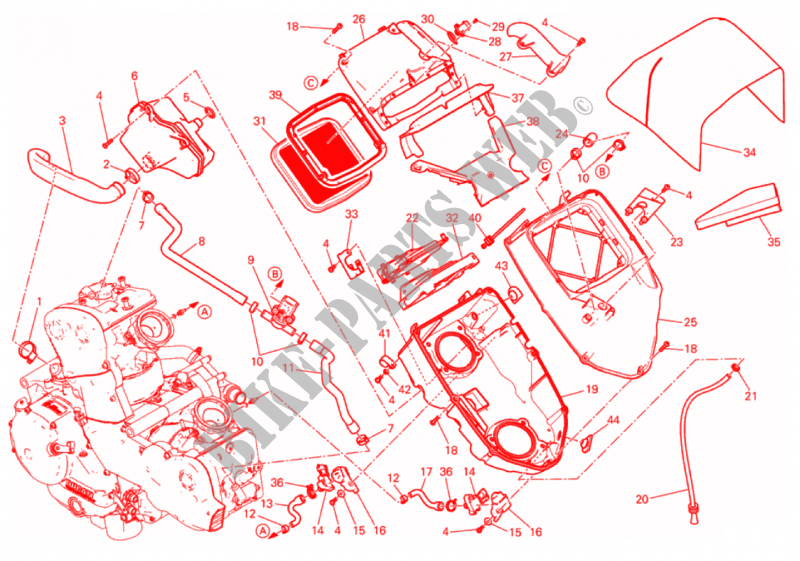

  1. After purchasing a 2018 950 mts I am starting to wonder why. The air intake plastics don’t line up no matter what I do. It took an hour to get the seat back on today. The fastener was impossible to start the bolt into. I cannot get toque specs from the dealer. I cannot get a workshop manual. I want to do mid 15000km services as oil and air filter should not be left that long imho but cannot even look at how the air box is designed in a manual. I cannot adjust my own chain as ducati won’t give me the torque specs for the rear wheel. Im looking at paying over $120 just for a freakin socket to fit the rear wheel nut on ebay. Feeling like I bought a misaligned $2 toy from China ☹️ Do Ducati seriously treat their customers like we are all overpaid freakin morons who run off to a dealer for everyfreakinthing. So pissed
  2. I imagine Tank needs to lift / probably come off to get to the air filter - the same as the 1200's

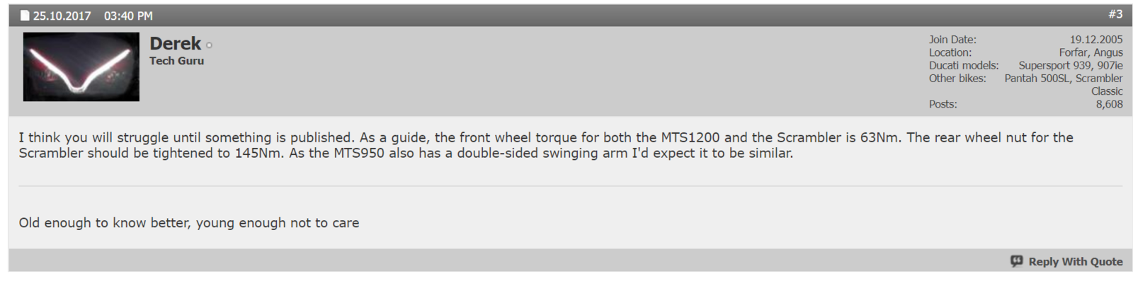

    The 800 scrambler torque spec for the rear axle is 145Nm +/-5Nm - thats a double sided swing arm 28mm or 30mm nut... The Multi 1200 Single side is 230Nm

  8. Derek is one of the experts on here... he also posted that he recommended to use the Scrambler as a starting point

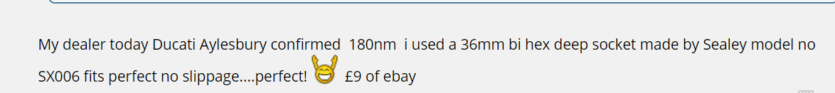

  9. Seems its a little more... and a 36mm bi hex socket needed... 180Nm for rear wheel
