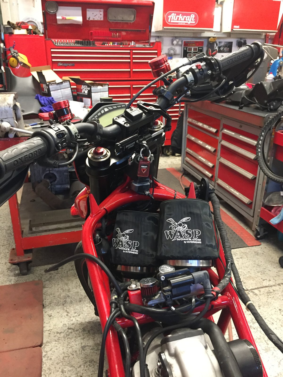

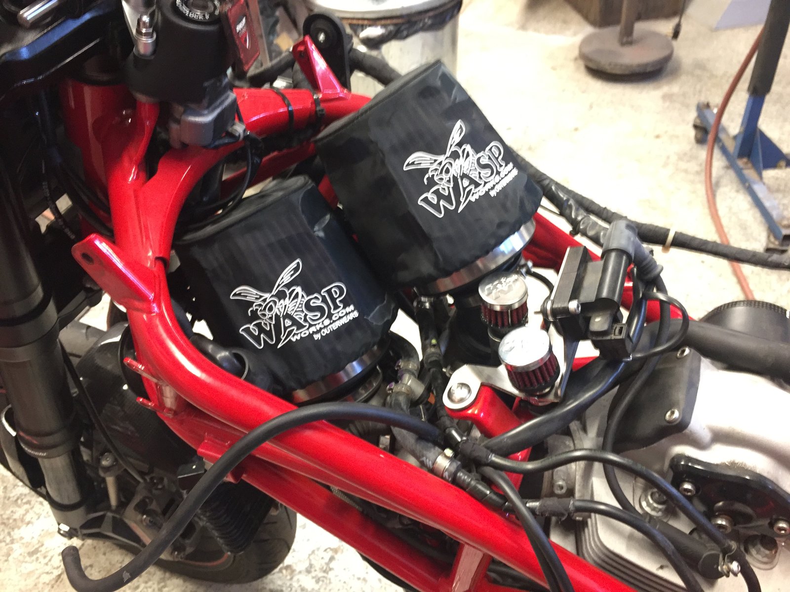

  1. Hey guys. Been real busy at work, but finally got round to fitting my Wasp Puk setup on my SP. The kit is just lovely and justifies the high price tag.
    I'm yet to have the bike mapped at CJ's, so I'm riding cautiously. However, I've noticed an immediate improvement in throttle response and low to mid torque! And the sound... worth every penny!
    I'll report back with some dyno figures once tuned at Chris'. Cheers, Matt
  2. Looking good ... i didn't bother with the filter covers ...
  3. i like that mount for the rear coil....ive got my coil bolted to one side and the denali to the other....messy but it works....i like that solution though....
