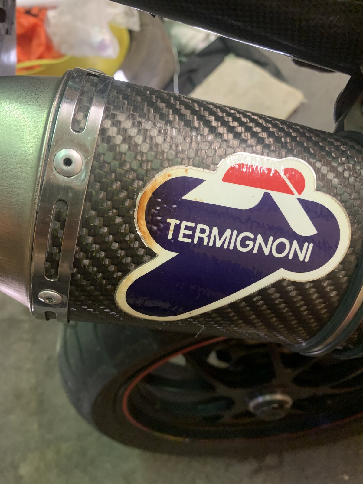

    Also where I’ve been out today and wrung it’s neck a bit I noticed this when I got back. Looks like my sticker is melting???
  4. Can needs re-packing. The insulation inside is compromised, allowing heat to get at the carbon sleeve and melt the sticker. If you don’t re-pack it soon, the carbon will scorch and go brown.
  5. And a new sticker....

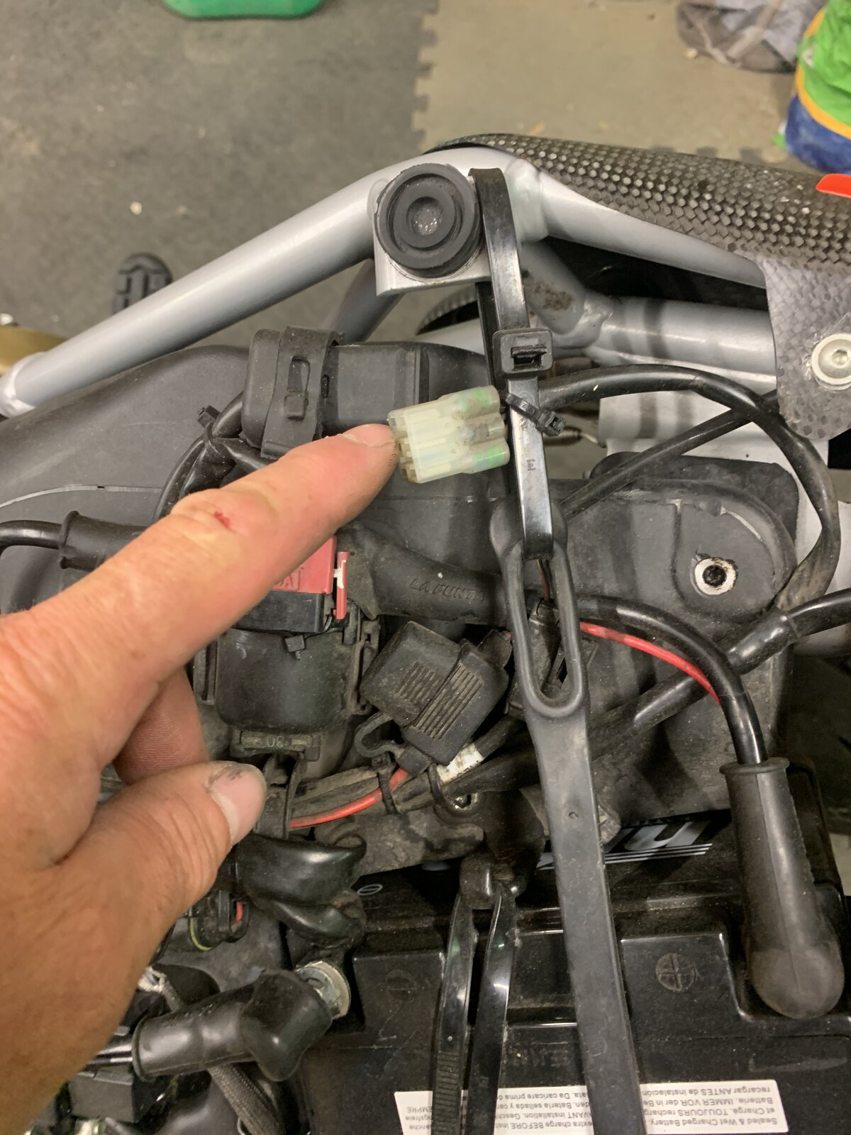

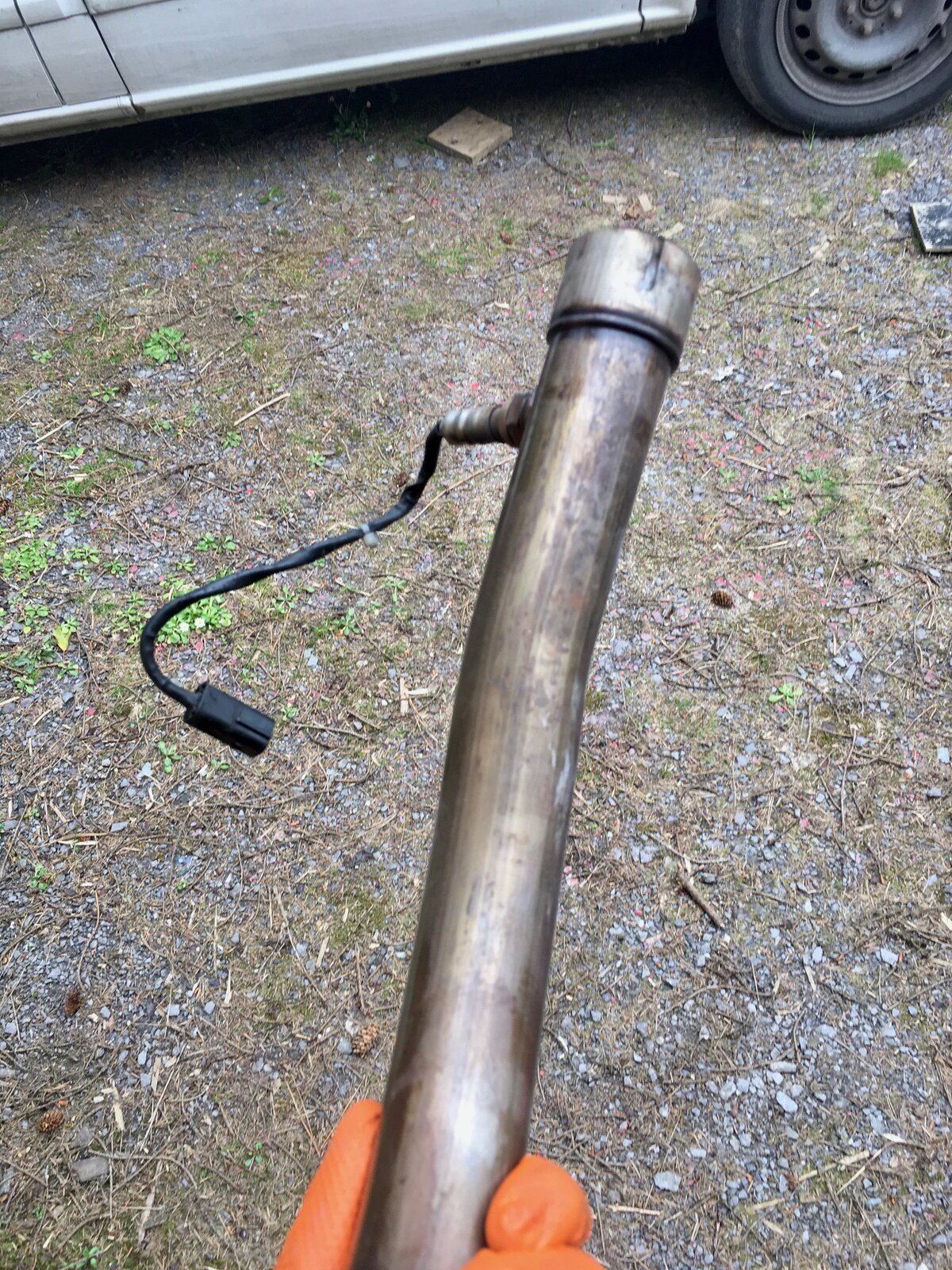

  18. @Felstmiester each exhaust should have a Lambda probe screwed into it you can see one hanging off one of my exhausts in the photo. You'll find them in the exhausts in the area around the rear of the tank/front of the seat.
    Check whether these are still there or whether the hole for them has been blanked off. If there, have they just been disconnected from the wiring loom? In which case reconnect them. If blanked off are they still connected into the loom and just been stashed away under the tank in which case remove the blanking plug and screw them back in. @comfysofa will be able to give you precise locations for them on the Hyper.
    With regards to the EXVL fault (exhaust valve) that will be caused because either:
    - the cable to the servo motor which operates the valve has been disconnected;
    - the entire valve mechanism has been removed and the pipe it sits in, usually where the two pipes merge, has been replaced with a different piece and thus there is no valve for the servo motor to connect to, or,
    - the electrics to the servo motor have been disconnected.
    In short the ECU is looking for a reading from the Lambda (O2) sensors in the exhausts and from the exhaust valve servo matter (that it is connected and operational). The ECU isn't get the info it needs so is throwing up the error light on the dash. Neither stop you riding the bike but it's not running at it's optimum efficiency.
    I'm guessing a previous owner bought a 2nd hand CF Termi pipe off eBay (which wasn't in the best of condition anyway, hence the breakdown in the internal packing) and then just stuck it onto the bike in a cack handed manner with no thought for what else is required in the upgrade process.
    EDIT : I should have added all these issues are easily remediable and, provided you have a little bit of ability with spanners, by yourself.
  19. I did spot this under the seat the other day.
