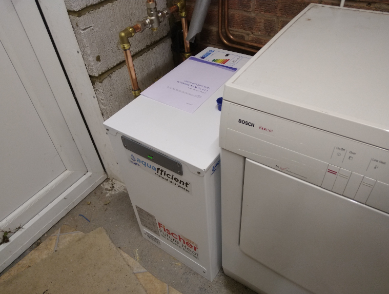

    My gas was capped off last night and two chaps came this morning to install a Fischer water heater and remove the old gas water heater. I had my first non-gas powered shower before midday!
    The water was coming out so hot that I went and turned it down before showering.
    I now have a hole in my kitchen wall where the gas flue exited! So, some making good to do!
    I also need to get some more pipe lagging as the Fisher job is in my workshop that is not heated. Being so close to the River Severn means that it never gets very cold here (and with a bit of global warming helping) but I don't wanna be caught out with frozen pipes in January!
    So, the chemical technology does work!

  13. This is the bodgery that I had to accept from the snake oil salesman:
