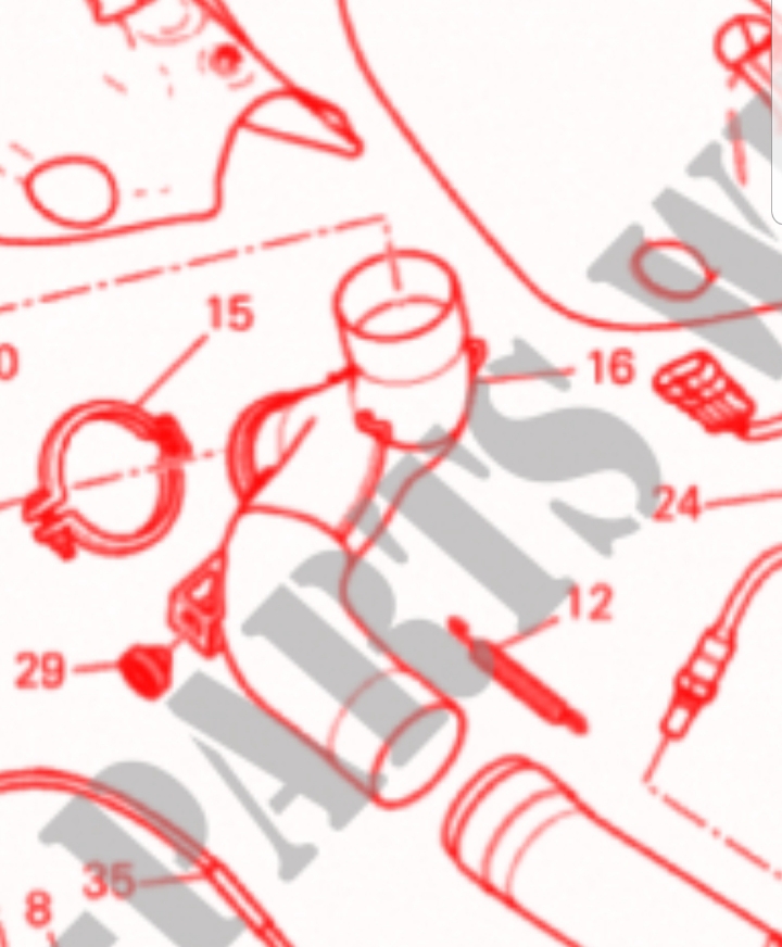

    I know this has been covered in a few threads but just wanted to make sure. If I manage to obtain a set of 1299 end cans and not a full system, Is the only other part I need #16 on that diagram?
  2. It is if the part number of the Y pipe you have shown is 57014464b
  3. Yeah that's the one mate, £255 for that part but may be easier than trying to source a full sytem plus I won't need the down pipes etc.
  4. 959 and 1299 are the same!
  5. No mate the y pipes are different - you can’t use the 959 y pipe on 1299 underbelly cans, flanges are different and the flapper valve is built into the 1299 y pipe making it longer.
