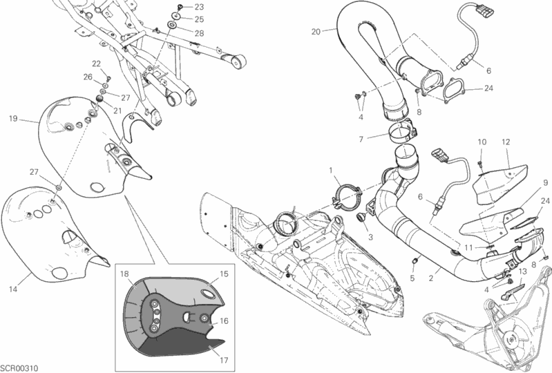

  9. The V2 header configuration is different from all that came before - if you look at the parts diagram you can see it at a glance.
    The 899/1199 headers are 55mm and come in multiple pieces - and as previously stated in the thread - have different joints to the 959/1299
    The 959/1299 headers are 60mm and have less pieces to the previous generation. They are they same up to the Y-pipe which is different - if you want to fit a 1299 Silencer onto a 959 you need the 1299 Y pipe - the location of the exhaust valve is also different as are the motors, cables and routing.
    The V2 headers are different again - the separate Y-Pipe is now incorporated into the front header as a single unit and the rear header now slips over the front header and uses a traditional style clamp. This means you couldn’t just swap out the Y-pipe.

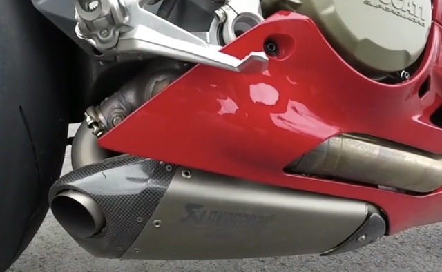

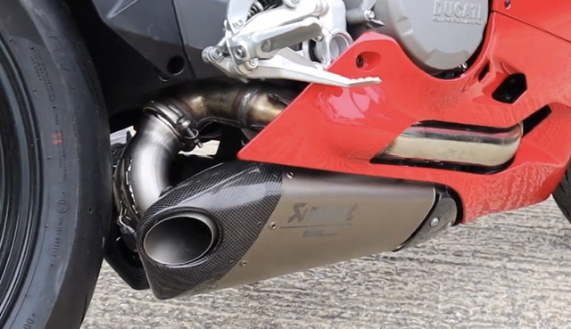

    My instinct says it won’t fit and that you would would find that the V2 Y pipe would be too long and at a slightly different angle. Top picture is V2 - bottom is 1299. The header pipe on the V2 doesn’t have the valve in the lower section of the pipe - the 1299 does so the Akra Y pipe for the 1299 will be shorter.
    06944930-6EDF-4201-A5AF-105F4F17D5BF.jpeg 1E70BAB7-EEBC-45B6-AD39-D46C3C6643AD.jpeg
    You could have the link pipe modified to fit or get one made up which would be cheaper than buying the 1299 specific one at £510 - I didn’t think these were available to buy separately - where did you find this price?
    Alternatively you could buy V2 Header pipes and swap the whole lot over. I have seen entire V2 stock systems go for peanuts on ebay so that might be the cheapest option.
