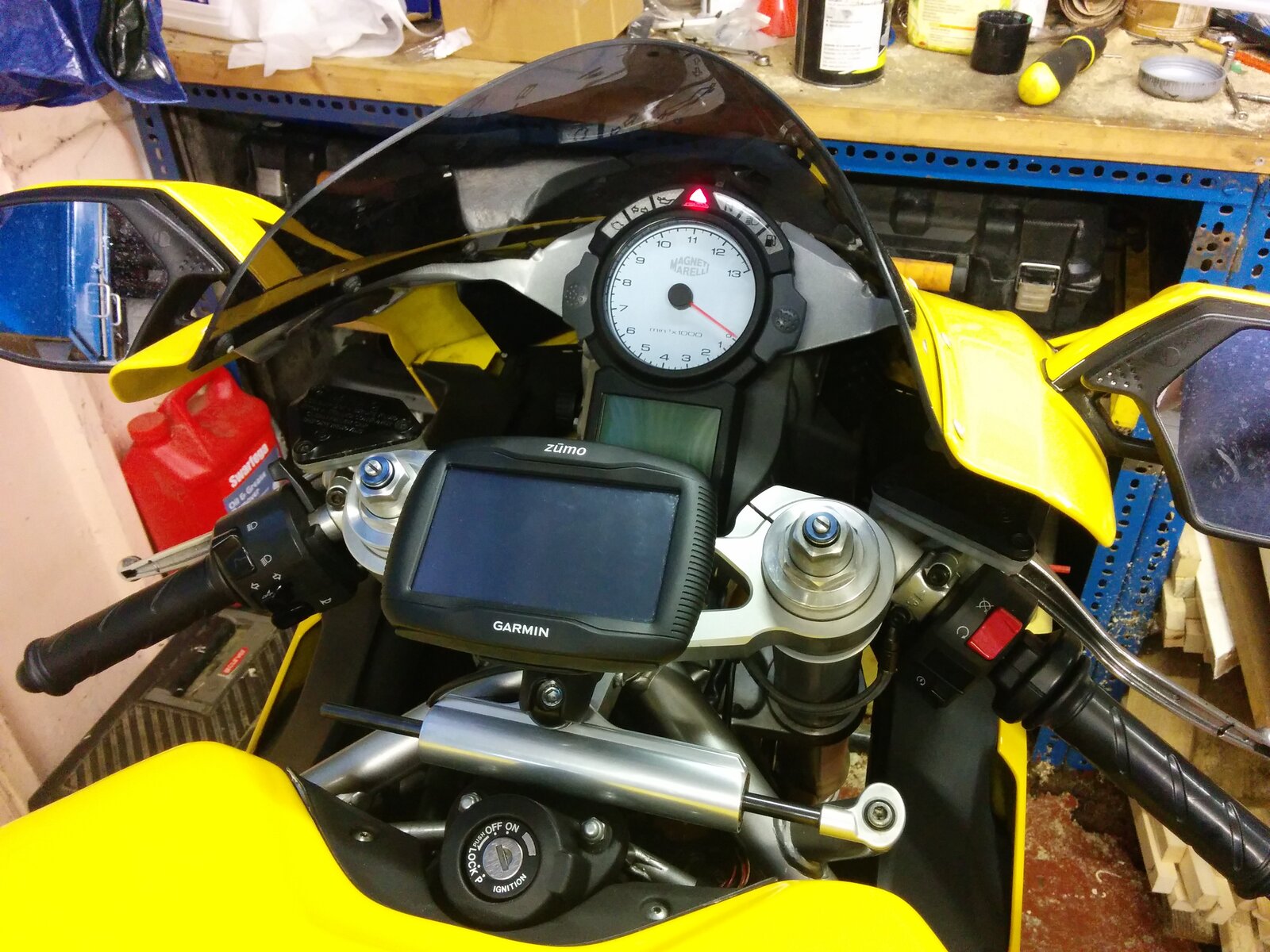

  3. Mounted mine to the steering damper bolt using a RAM mount
  4. Wow, neat...
  5. Thanks Charlie, exactly the same Garmin I have. Do you recall which RAM mount it was you used? Thanks.
