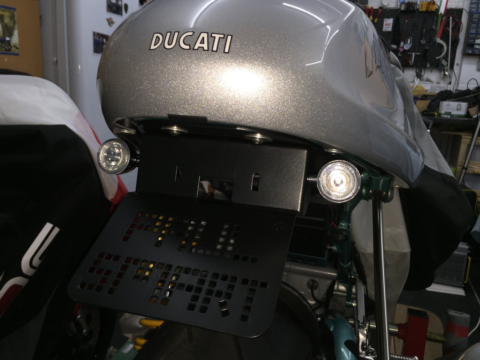

  1. A friend of mine designed & had fabricated a tail tidy for a Paul Smart SC he was working on and very kindly offered one to me. So, as far as I know, there are only 2 in the world in existence! I have looked at the option from the USA which turns the original rear light & indicators upside-down but it didn't really appeal to me.
    So, following his project closely, I also decided to fit Rizoma iRide LED indicators as they are the closest thing to the originals, just smaller and neater. I also used the Rizoma EE089H connectors (male) which connect directly with the Ducati loom connectors to avoid cutting the OEM wiring and make it simple to revert to original should the need arise.

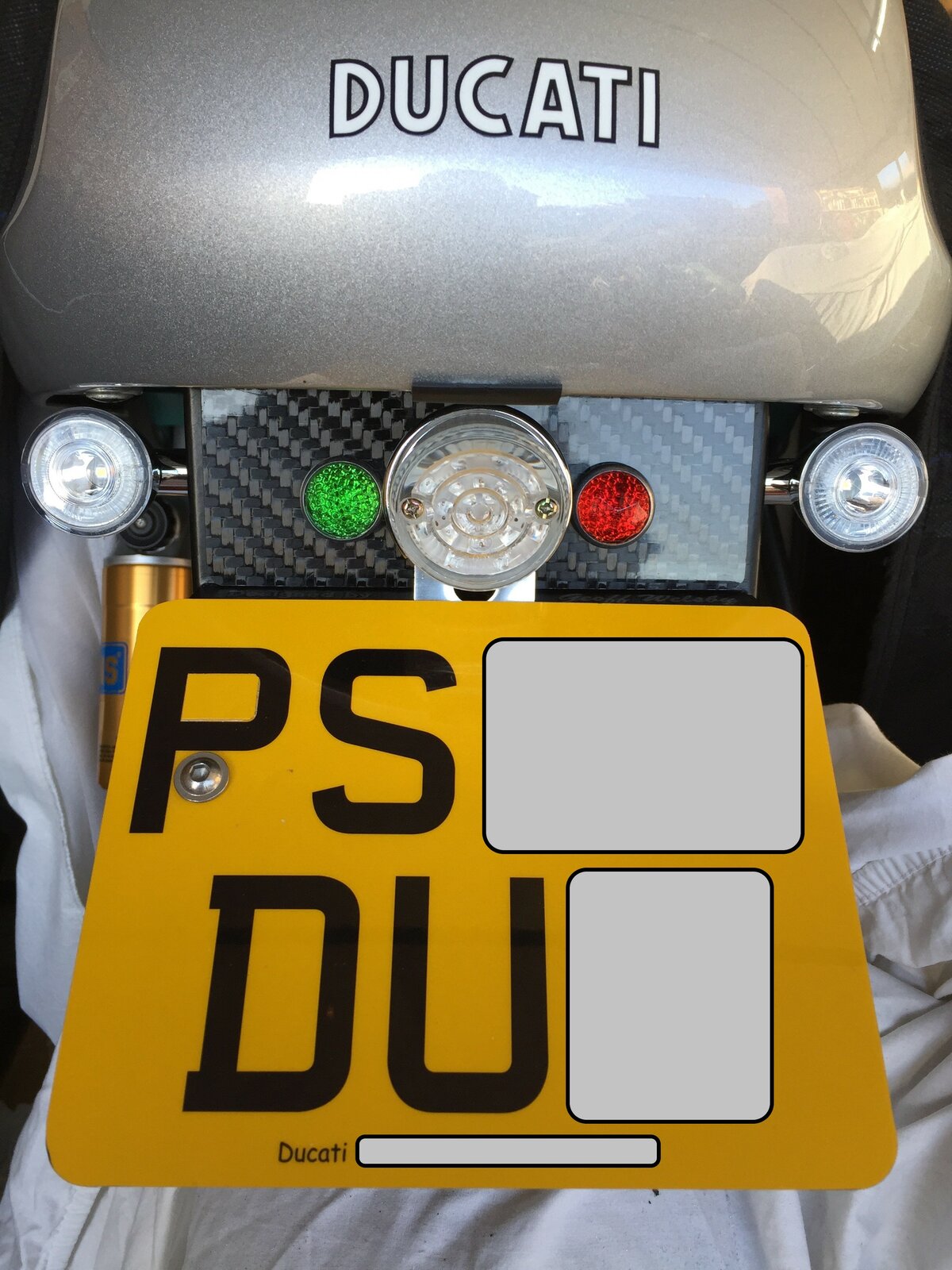

  3. I am waiting for the rear light to arrive. I have chosen a round one in keeping with the original and indicators, just smaller. I have also removed the mirrors to be replaced by Oberon round bar end ones

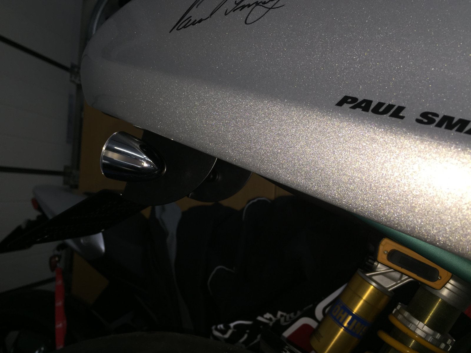

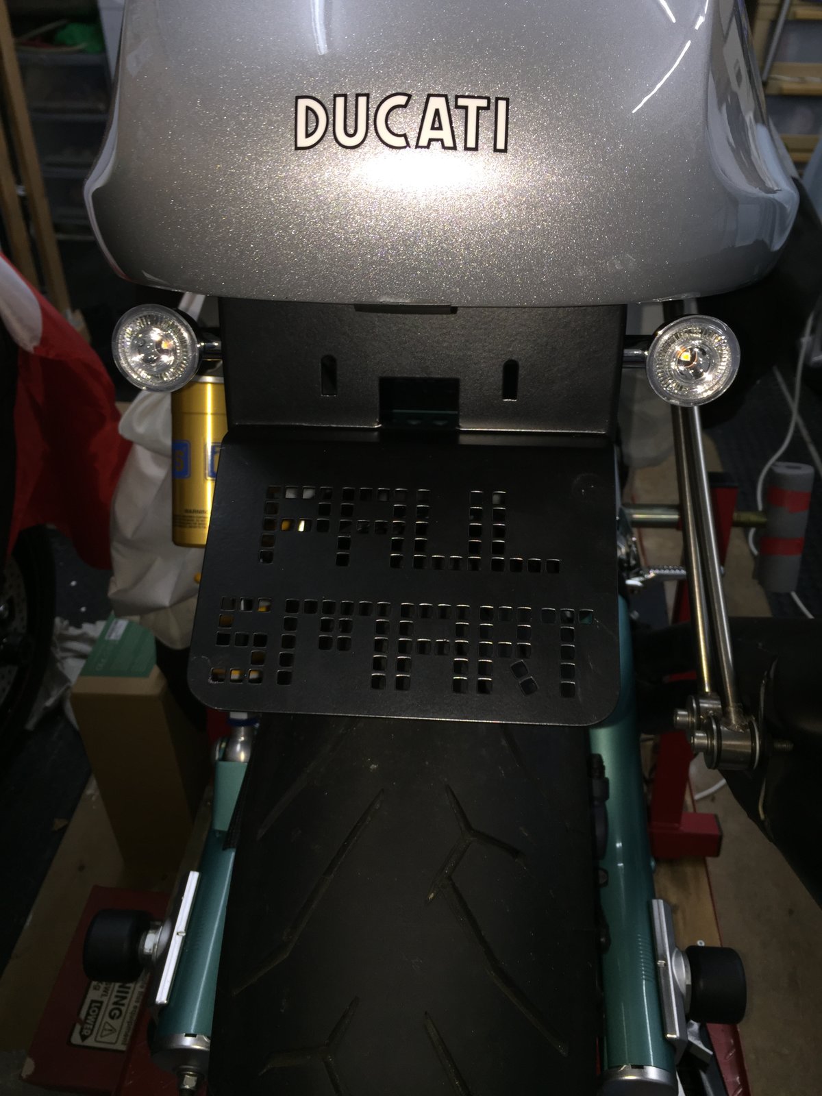

  13. Finished! (for the moment anyway). The reflectors are glass rather than plastic, as I couldn't find green ones anywhere in the UK & had to get them sent from the USA. I wanted to stick with the round lights theme throughout. paul smart tail tidy rear view blanked.jpg

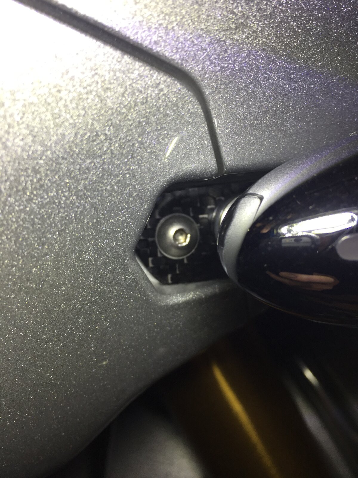

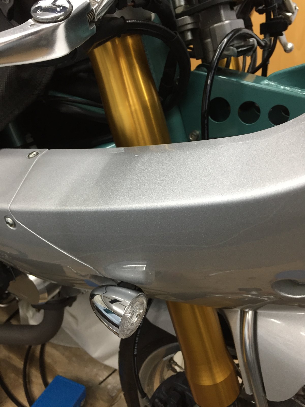

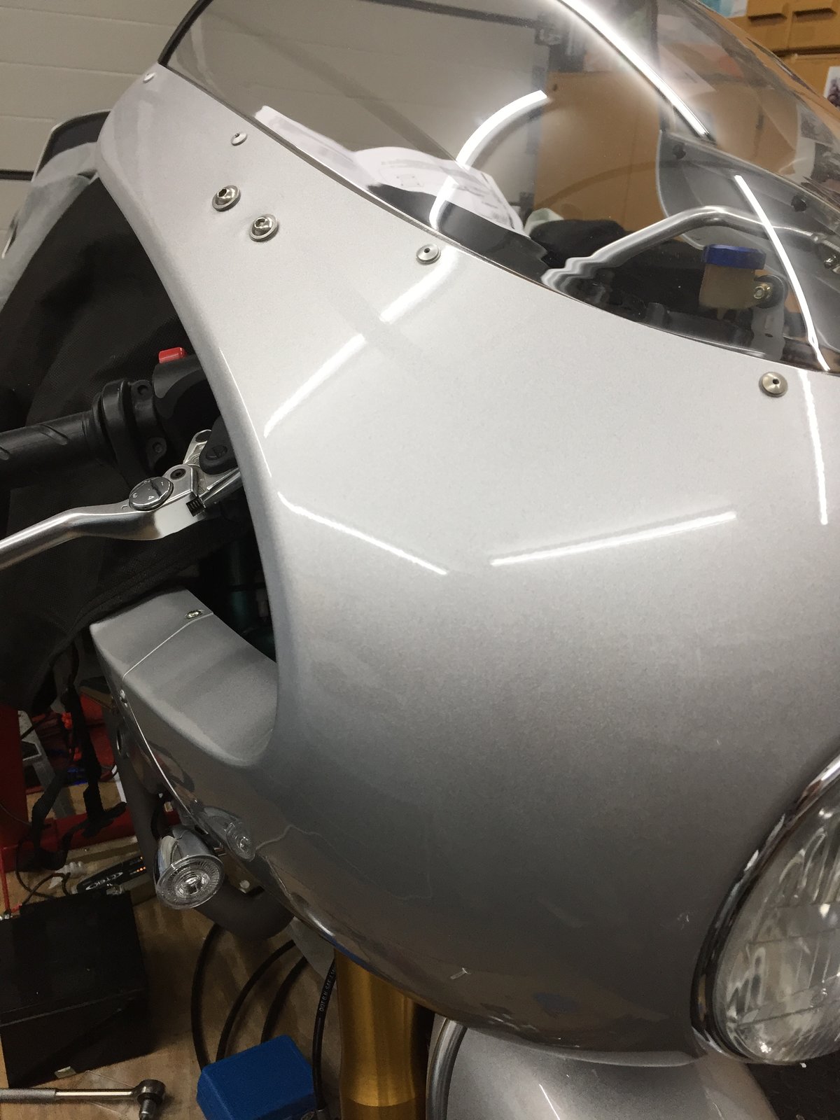

  14. Hey . I am a Paul smart owner myself and looking to replace the fronts as they have snapped and the ones you suggested/used are as close to the original but without the bulk, and would love to know how you managed to connect/attach the rizoma front indicators to the fairing, as cant quite see from the picture. The OEM ones have the plastic bracket fixed to the indicator so im stuggling to see how an aftermarket can be secured properly. Thanks :)
  15. Hi Nick
    The front fittings are a bit problematic because, as you say, there is a moulding on the OEM indicator which is not present on the Rizoma led replacement. I bought a small sheet of rigid carbon fibre 2mm thick & cut a small mounting plate to fit in the fairing aperture. I made a card template using the original indicator first & then used a dremel to cut the cf sheet to size. It’s a bit fiddly & takes time & patience. When the mounting plate fits snugly in the recess, you will need to drill 2 holes in the cf mounting plate, one for the indicator stem itself & one for the smaller allen-headed bolt to correspond with the one in the fairing to the rear of the indicator. I used a stainless button head for neatness. I will try to upload a photo to illustrate.
