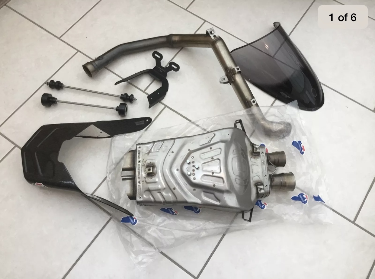

  1. I’ve had nothing but trouble Only had my duke a couple of days when the check engine light came on and it stunk of eggs! It’s been in for a diagnostic test and apparently the rectifier is toast and it’s over charging the battery new battery and rectifier being fitted next week, not great but at least it’s sorted the problem. While it was in the shop I managed to snap up this little lot for £550. Just hope I can get it all fitted!

    Now the termi exhaust I’ve got, the previous owner said he had it on his standard 749 with no issues but I’ve been told I’ll need a new ECU or fit a power commander? What problems will I have if I don’t do this?
  7. With respect to @Sev , who is very knowledgable. I've never had a problem with 749 or 999 reg/rec. Mine have had OEM fitted and have not let me down. I'm in the non Li-Ion battery camp with @Exige , along with many others I'd find more benefit from laying off the cooked breakfasts than from fitting a far more sensitive battery if weight loss was the goal. It's much discussed that non-OE batteries can cause other issues elsewhere in the system. Others feel very much that they're a worthwhile and safe modification.
  8. Stock ECU will sort out the basic fueling and the bike will run ok. If you want to get the maximum out of the bike, then fit a PC and have it mapped, or see if someone can flash the standard ECU for you. But, try just fitting the exhaust and take it out. Bet it will feel OK.

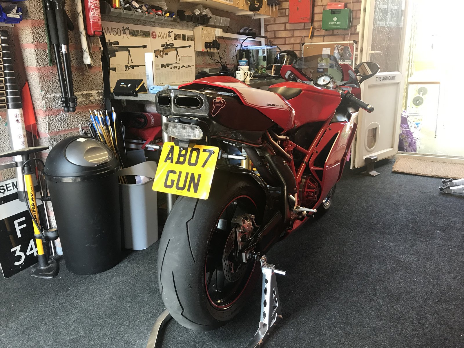

  17. 52ED8ABE-2ED4-4041-88FD-4F9B7AA5DC71.jpeg Finally got the bike back and fitted a termi half system is it worth purchasing a power commander and having it rolling road set up, will I notice the difference?
  18. (A swing bin! You score 10 bonus bin-points!)
  19. Surely double points for two bins in one picture! Although one has arrows in it.
